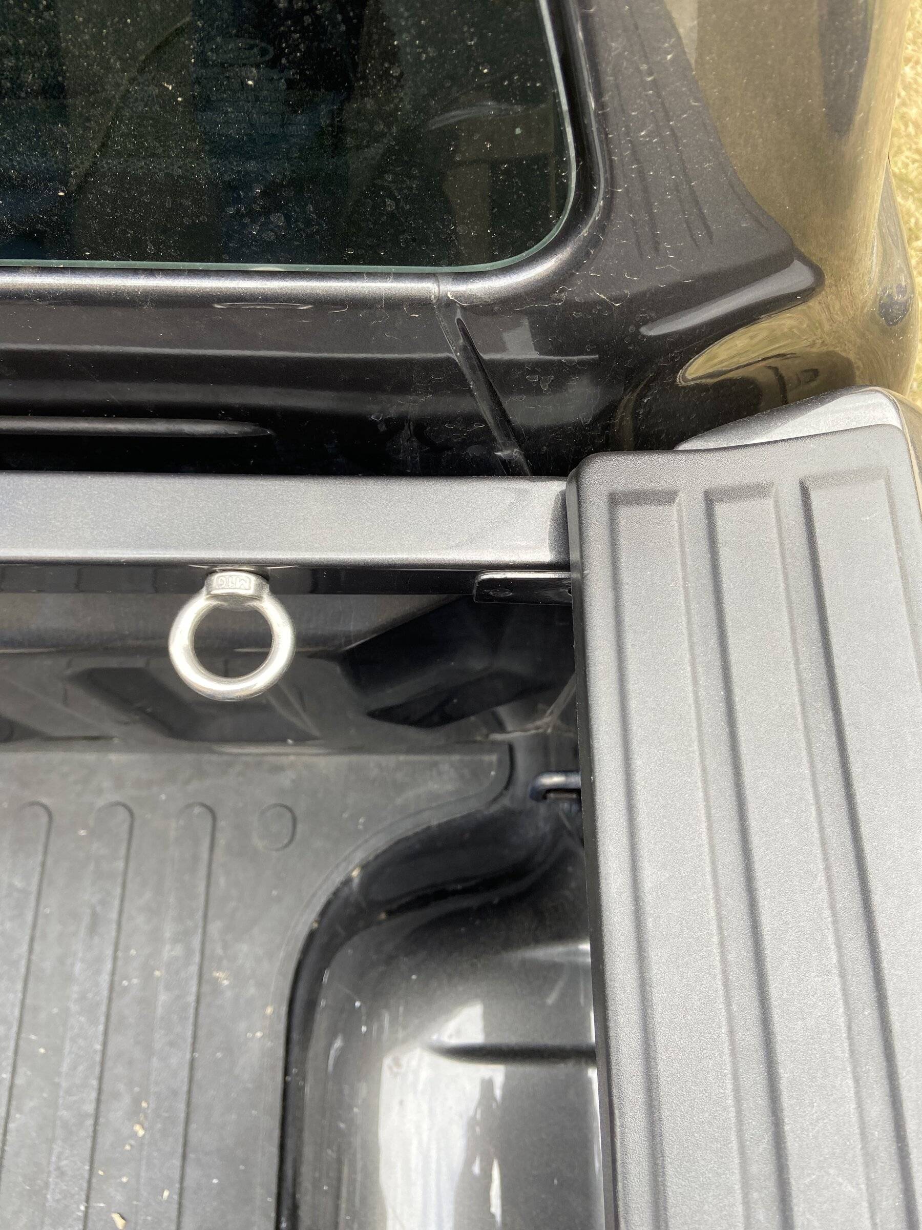

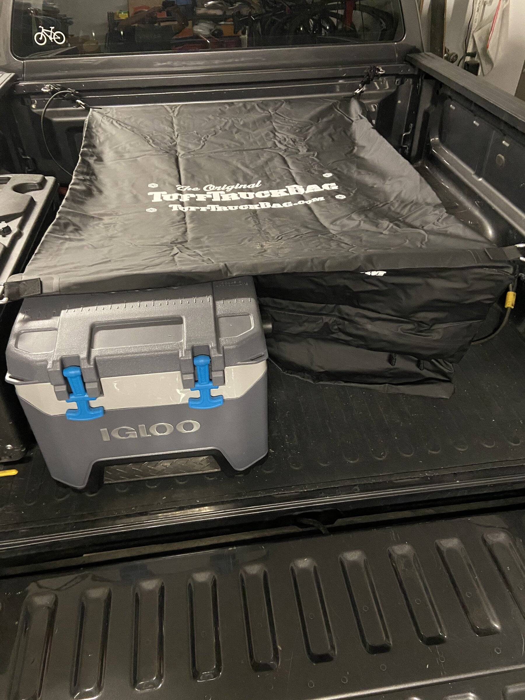

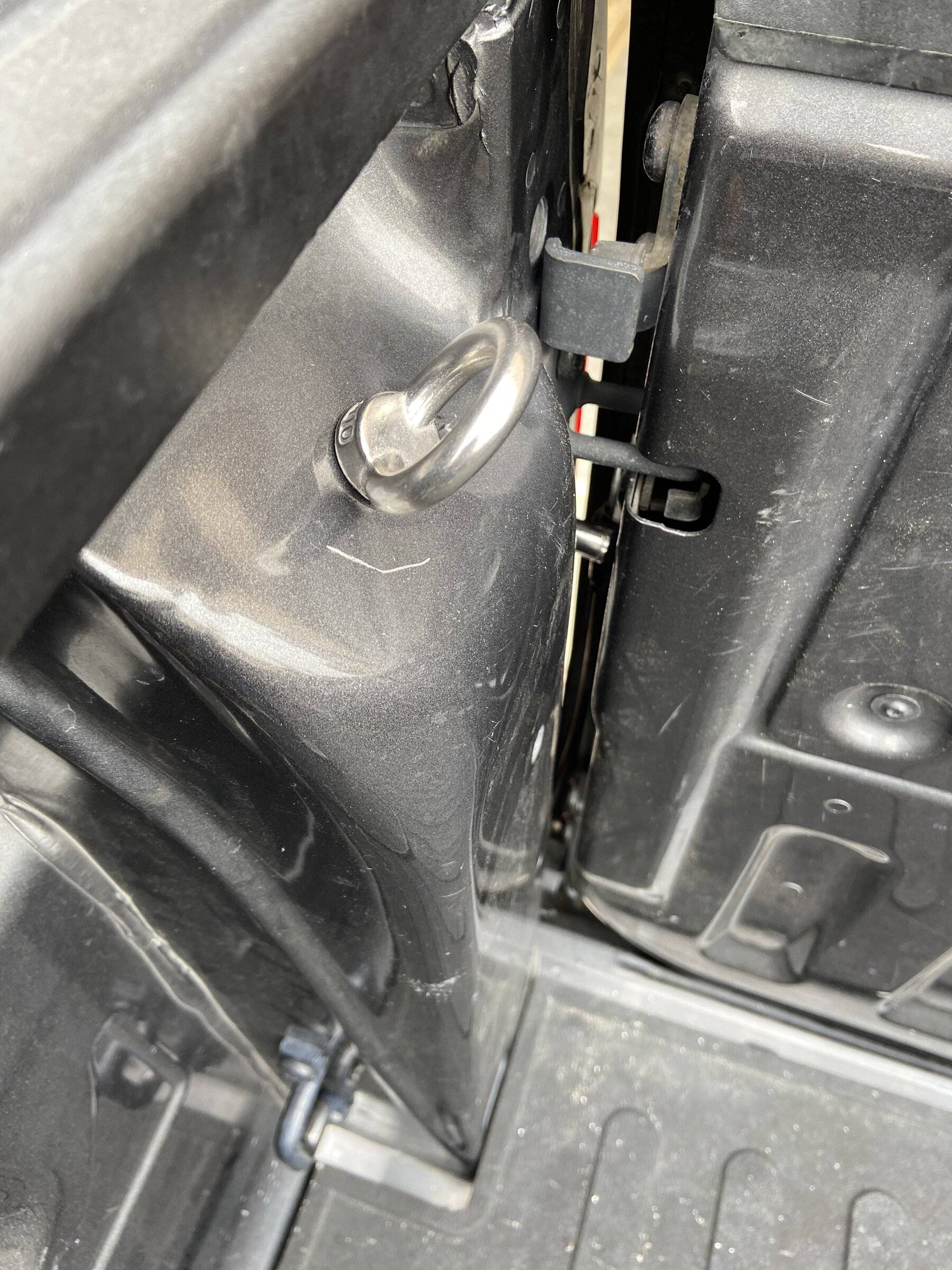

I needed better tie points for my Tuff Truck Bag so I added these stainless eye bolts. On the front I used the existing holes, not the strongest point but plenty for how I’m using them. The rear are pretty solid though.

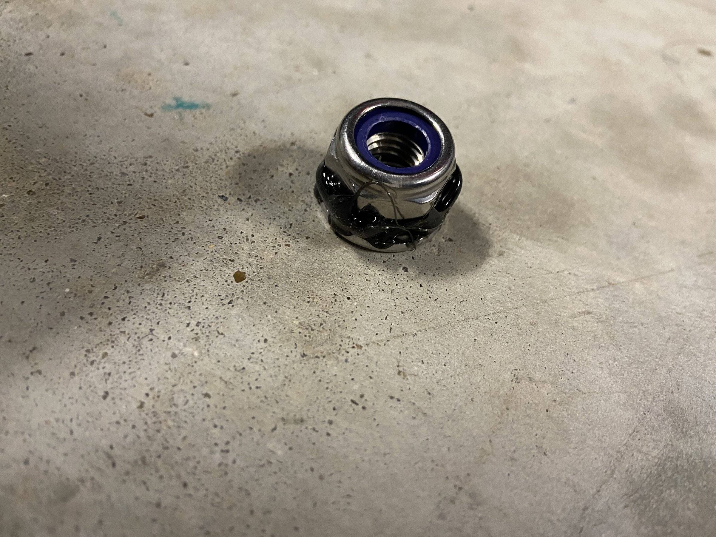

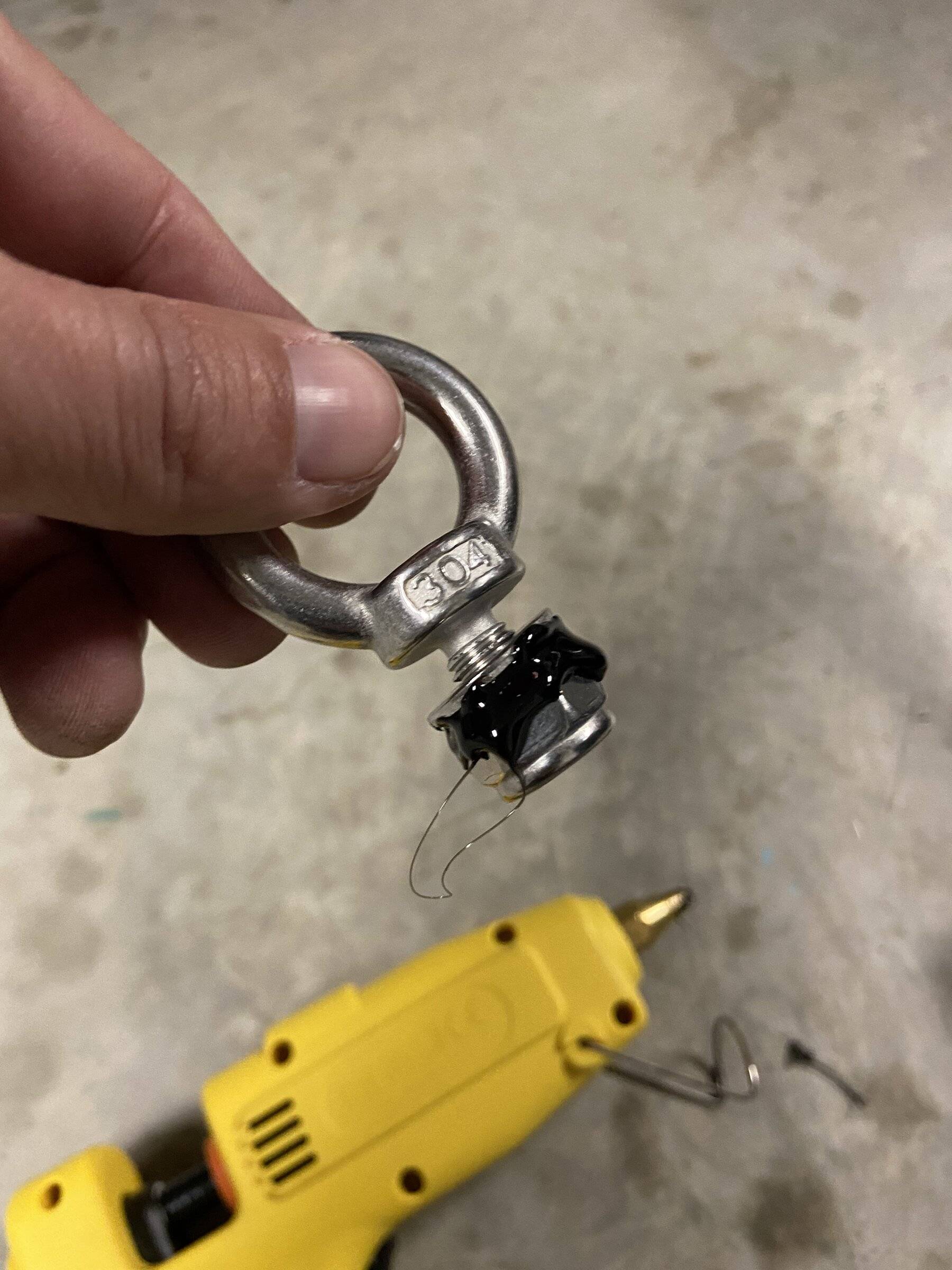

I came up with this trick to hold the washers and nut together, so I could easily hold it all on the backside.
