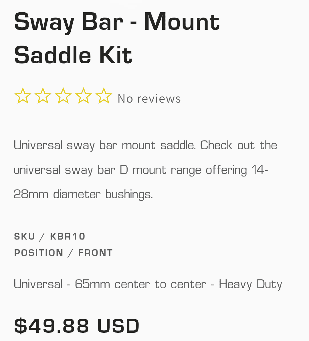

I see they are slotted but center to center 65mm? I don't get what that means if I go out and measure the distance of the factory bracket.
They replied that they didn't have 'D' bushings in the Ranger size so I asked about the universals.
I know some knowledgeable people have questioned why I'd do this, and I'm thinking since I've preloaded my factory progressive springs (made firmer?) with the Eibach adjustable struts while introducing some 'progressive' modifications in the back with the Sumos I'm going to improve the tendency to initially pitch in a corner. I don't want to come down like a hammer and have front traction issues and this seems like a subtle change.

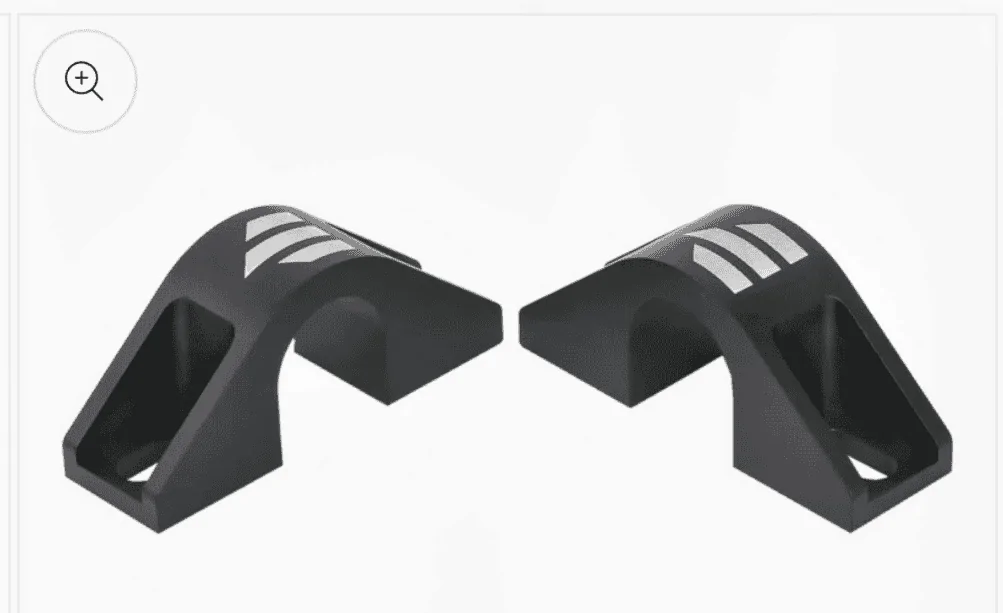

Reply from White line:
The universal saddles KBR10/W21301 have a slotted mount to accommodate 62-88mm mounting holes. Universal 27mm D bush for these would be W21999-27 or for the heavy duty versions, KS30 and W0410-27.

The only hold up is getting the exact diameter bushing. If ours is 27.5mm as Addco says it's an oddball size. Maybe possible to enlarge a 27mm but would require a shop to do it.

I tried the Prothane 27mm generic and the brackets mounting holes are too narrow, the bushings too small for the factory bracket.
Finding a generic bracket with the correct spacing for the mounting bolts and bushing that can be machined out to 27.5mm will be the trick.
