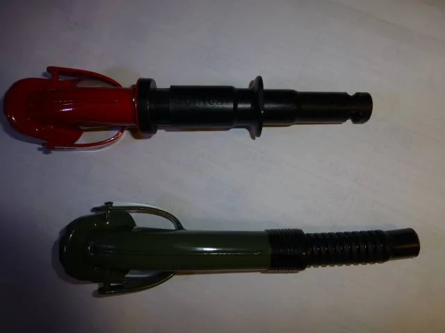

The compliant nozzle is spring-loaded closed. Pressing back the nozzle’s outer sleeve opens the valve and fuel flows out notches on the sides. The problem is those notches are exactly where the actuators to unlock the inner fuel flap are located in the filler neck. The actuators fall into the notches and effectively lock the nozzle into the filler neck. Removing the nozzle required an “enthusiastic” yank. This managed to break off one of the actuators. Fortunately the broken piece did not drop into the tank and was retrieved with a pair of long-nosed pliers.

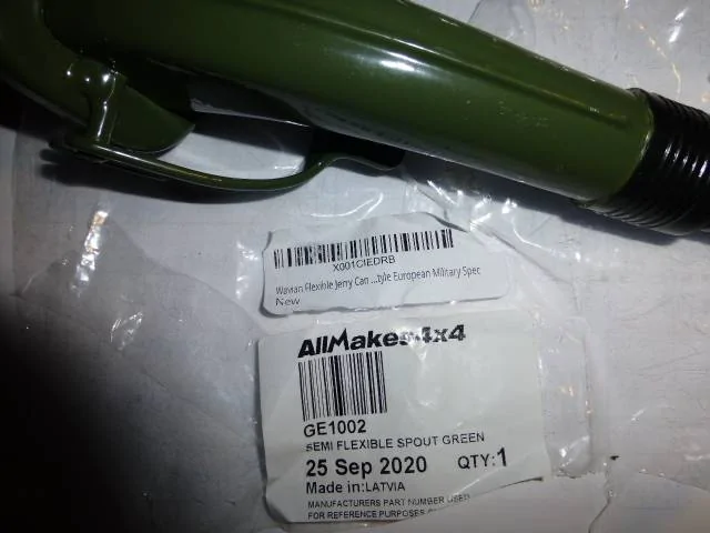

I’ve replaced the C.A.R.B.-compliant nozzles with simple flexible-spout types, and since their tips are too narrow to open the inner valve, they’ll be used in conjunction with the funnel.
