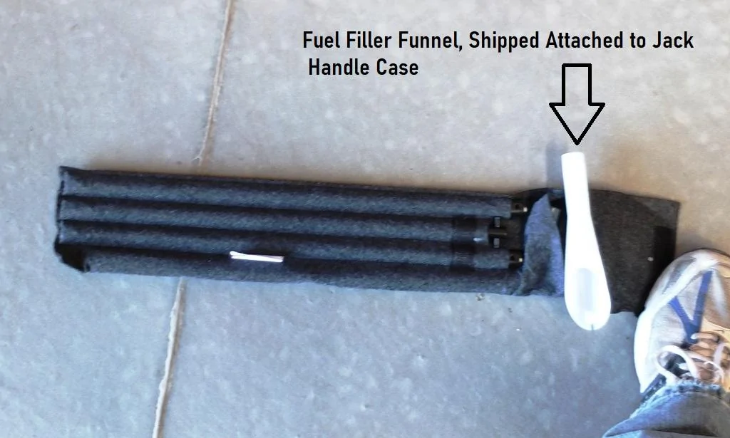

Edit: Next time that happens try using the fuel funnel that is packed in the storage compartment where the jack is. It would be interesting to see if the pump still has a problem.
