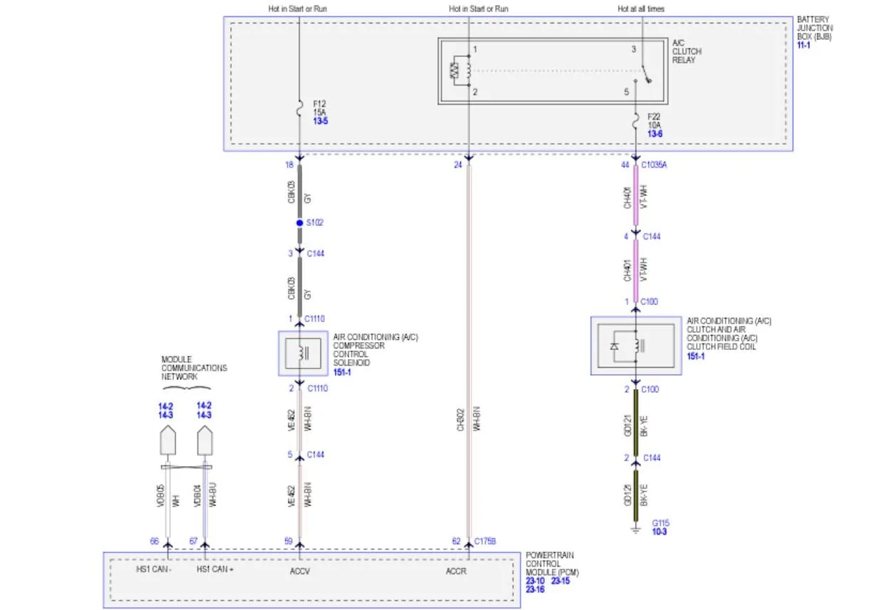

Before replacing the clutch or compressor, hook up a voltmeter to the connector on the clutch. See if there is 12 volts to the clutch coil when the A/C is turned on (pins 1 and 2 of connector C100). If not, you have a problem with something else other than the A/C clutch. Also check for a good ground connection to pin 2 of the connector with an ohmmeter.
