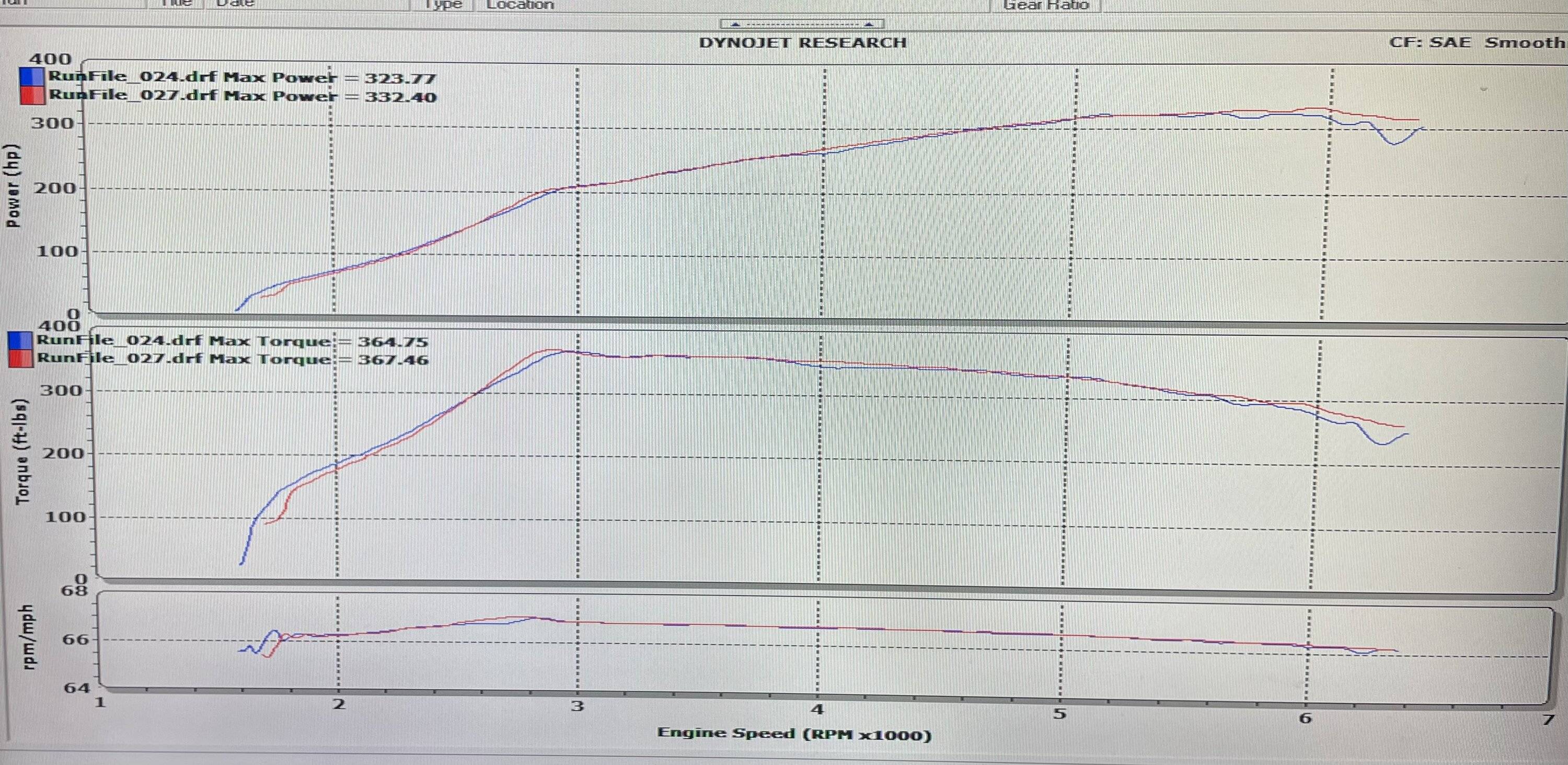

Stock turbo, full bolt on including turbo inlet pipe. My truck makes 332/367 to the wheels on 93 with stock tires. New turbo coming soon but I really don’t expect much more from it without using ethanol. It would be nice to get 350/390 but idk.
If I can stretch the fuel system a little bit I’ll mix ethanol to get a better number but I really don’t think has enough pump for that. Gonna see, might be cool. Regardless I’m not pushing my stock motor much further than 400rwhp if even that far. Just because it will make it doesn’t mean it will make it very long. ?
