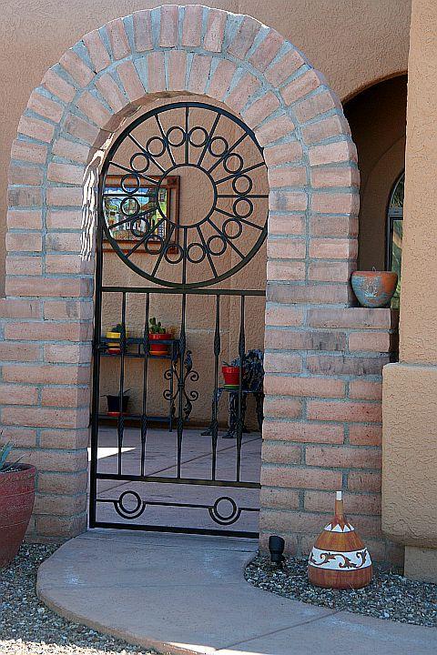

Optical Illusion...???? That is why I quite being a mason and went back to developing Trucks...:(

Gives it character.:)

Agreed...character... Rear it is not visable...the Mexican Blocks are not square in all cases, but I missed this. I have to say it was fun to build the arch and we first fit it with wooden gates that I made and painted turquoise, but wood and Arizona desert caused deterioration. There is a place here that makes such Iron gates, but they are vanilla. Wife wanted Chocolate swirl with nuts. So I embarked on a redesign and when I hit on the half circle of the arch and why not continue it to make a circle, the design flowed out of the drafting pencil onto the paper. Love the creative process and then have it really accomplish what was drawn to scale on engineering grid paper.

It’s very pretty. I like it a lot.

Thanks! Have had a few people want the same gate and wife and I said no as we want it to unique, so the photographed and took it to the Ironworks...They would not produce it as they were concerned it was copywrited...smart company...
Anyway we like it and I have a bunch of scrap metal which with to work!

Thanks for your input! I made something similar for a coworker’s truck using flat bar with a key shaped hole in one end and a stud on the other. It fit into the tailgate latch and over the striker to be used when their ATV was loaded as an added safety measure. Nice looking gate by the way!
