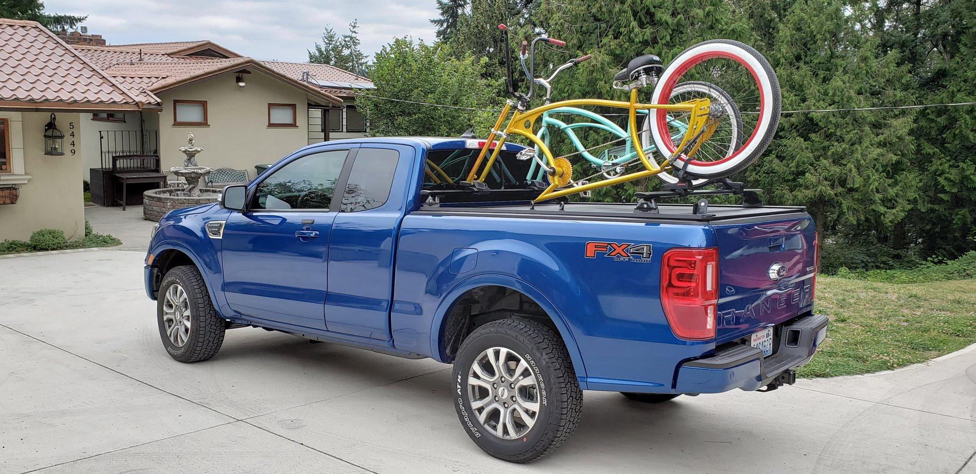

We installed the Retrax Pro XR aluminum series tonneau cover and have absolutely zero problems with the tailgate not being able to fully shut and lock. Nor do we have any problems with water leakage. Fitting the cover on properly was the first step in ensuring full functionality.
Attached photo of the cover properly installed and using the yakima bars and forkcops in the channels created with the tonneau system
