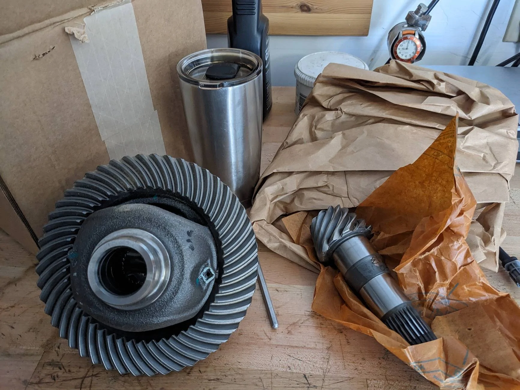

Regeared final drive to 4.7 w/ Bronco FDU and Ranger Raptor half shafts to go the the raptor control arms

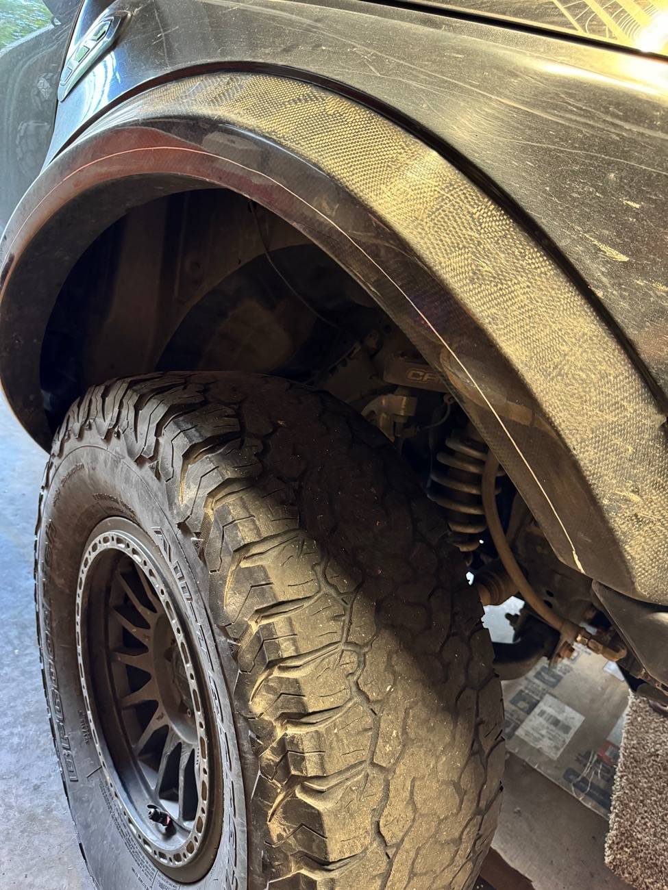

Can you share more pictures on the cut fenders? Any advice? I like the look and want to do it on my truck. Was thinking of making my own liners for it as well.
are you able to provide more details on the fender cuts?
For the fenders themselves, Ford kinda gives you a template. I took the grey trim piece off and followed the inboard crease around the trim mounting flange. I cut away the flat part of that flange and still left the outboard crease on the fender to keep some rigidity in the fender.
The rest is just cycling steering and suspension (without springs) and cutting and hammering whatever gets in the way. 34's or 35's aren't too bad. 37's were problematic, especially in the rear. I don't think 37's are possible without wider control arms or severely limiting jounce travel.
