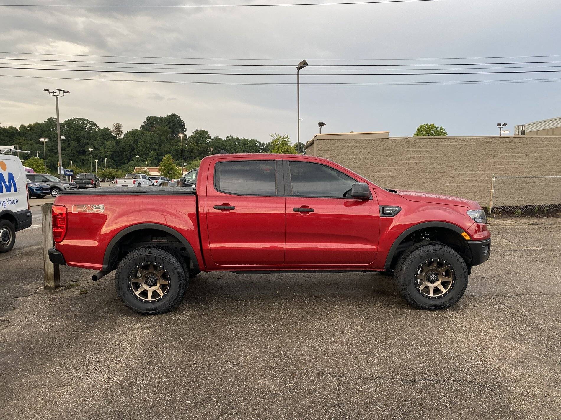

Making this thread so I can keep track of what I have done to my Ranger. Feel free to follow along!
Mods done so far:
-General Grabber ATX 265/70r17
-Icon Alloys Rebound (Bronze) 17 x 8.5 +25 offset
-AEM Air Filter
-Gator SFX Tonneau Cover
-Tinted front windows to match the rear
Mods to come:
-Ford Fox 2.0 (should be here in a few days)
NOTE: If anyone is wondering, the wheel and tire combo does fit at stock height with very slight rubbing under compression if turning.

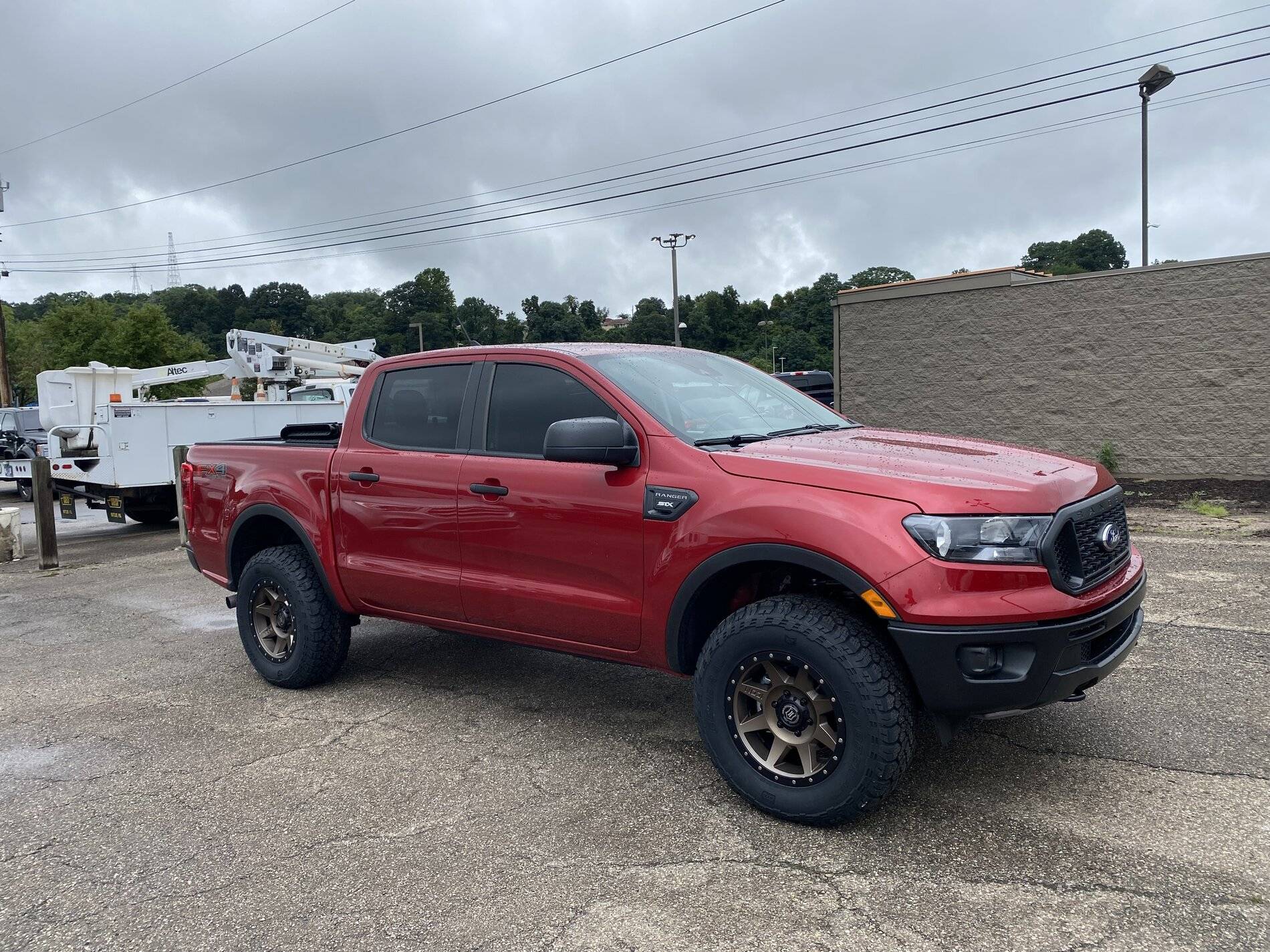

Wow the wheel and tire upgrade makes a world of difference for the looks and stance of the truck. About how big are those tires? Looks like maybe 32-33 inches?
HILKER05
HILKER05
Jul 28, 2021
Pittsburgh, PA
2021 Ford Ranger STX FX4
Ford Sales and Leasing
They are a 31.6 so roughly a 32. I agree, its crazy how much just wheels and tires can change a truck!

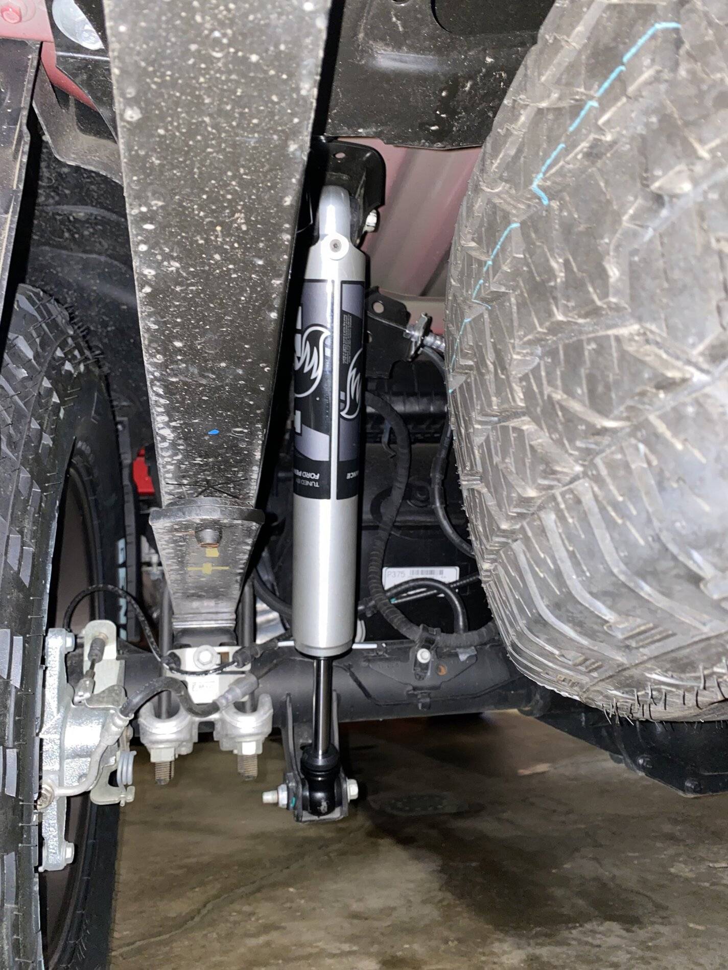

Fox 2.0s Finally came in yesterday and I installed the rear shocks on my own last night. What a royal pain that was... The FX4 shocks came out fairly easily but, installing the new ones took quite a bit of effort. One of the retaining straps came undone in transit so I had to use a ratchet strap to compress the shock and get it into place. The other shock, even with the retaining strap on, was still to long so, did the same for the other side. Both sides took a lot of cursing and muscle but finally got them in. Once in and when torqueing down the top bolts, I realized that the nuts Fox supplies were just spinning in place. I had to back the top bolts and re-use the original nuts to be able to tighten down all the way. All in all took about 2.5 hours and I now feel much more accomplished. I have a shop installing the fronts tomorrow and will report back with some pictures.

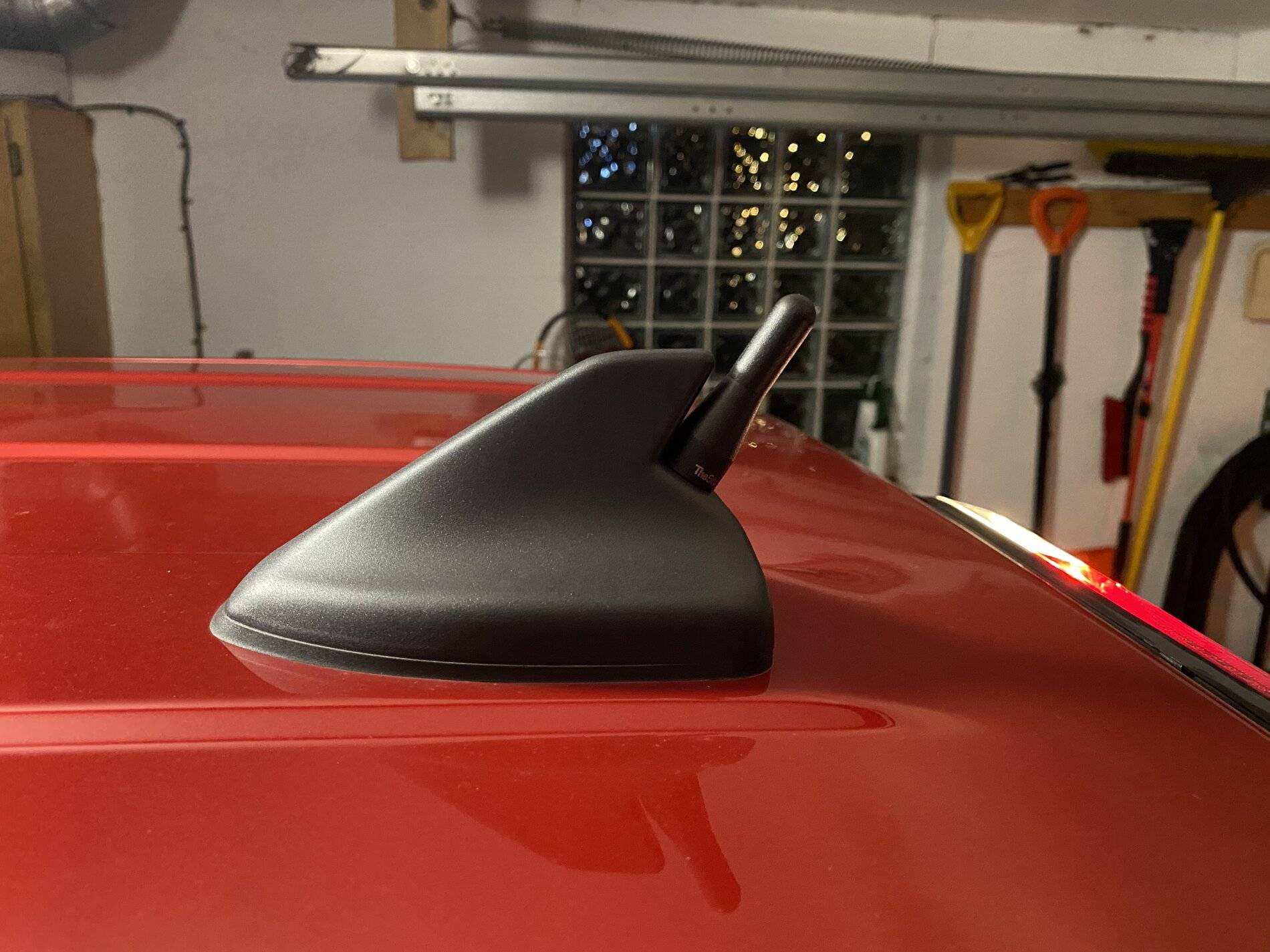

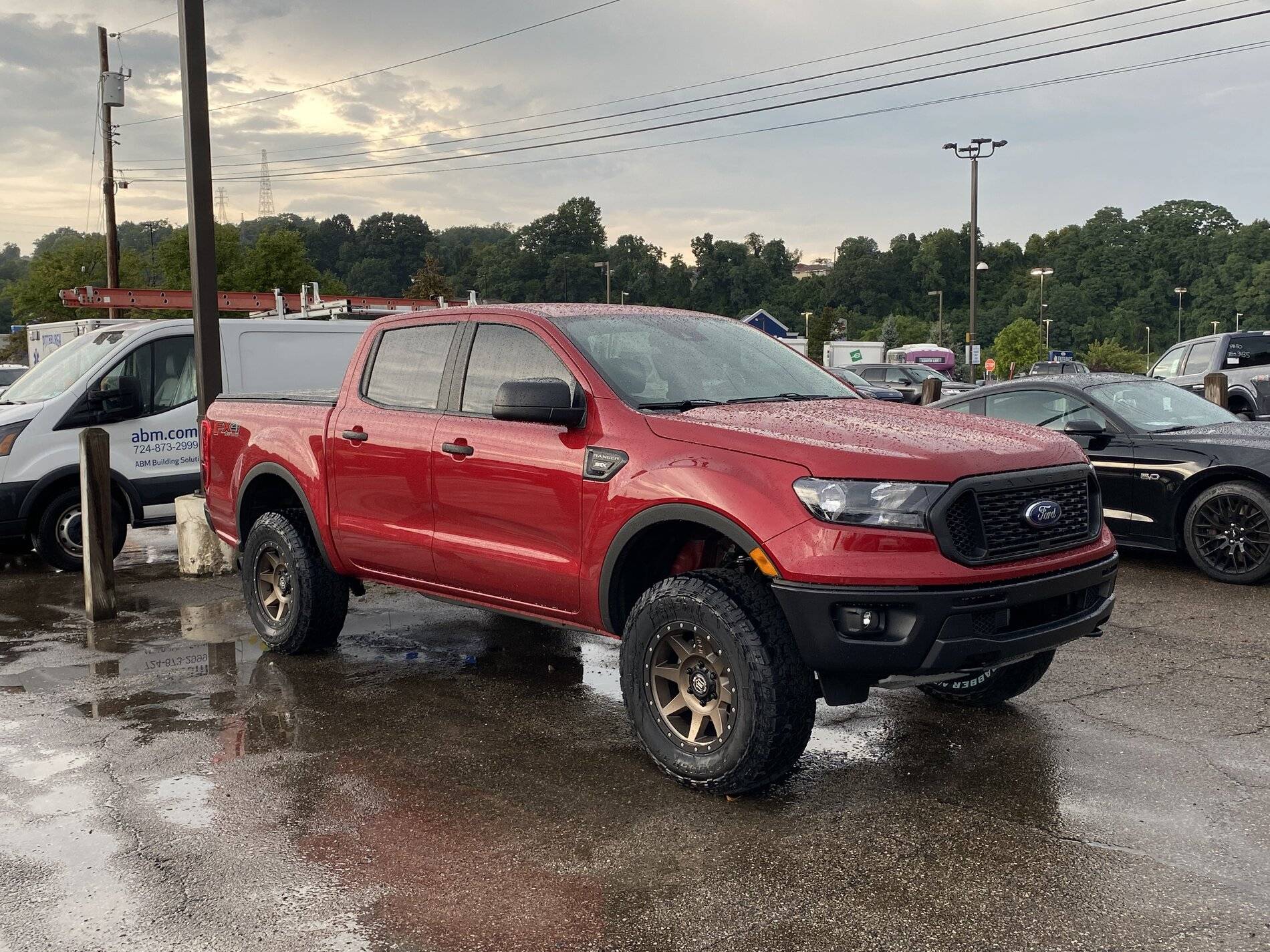

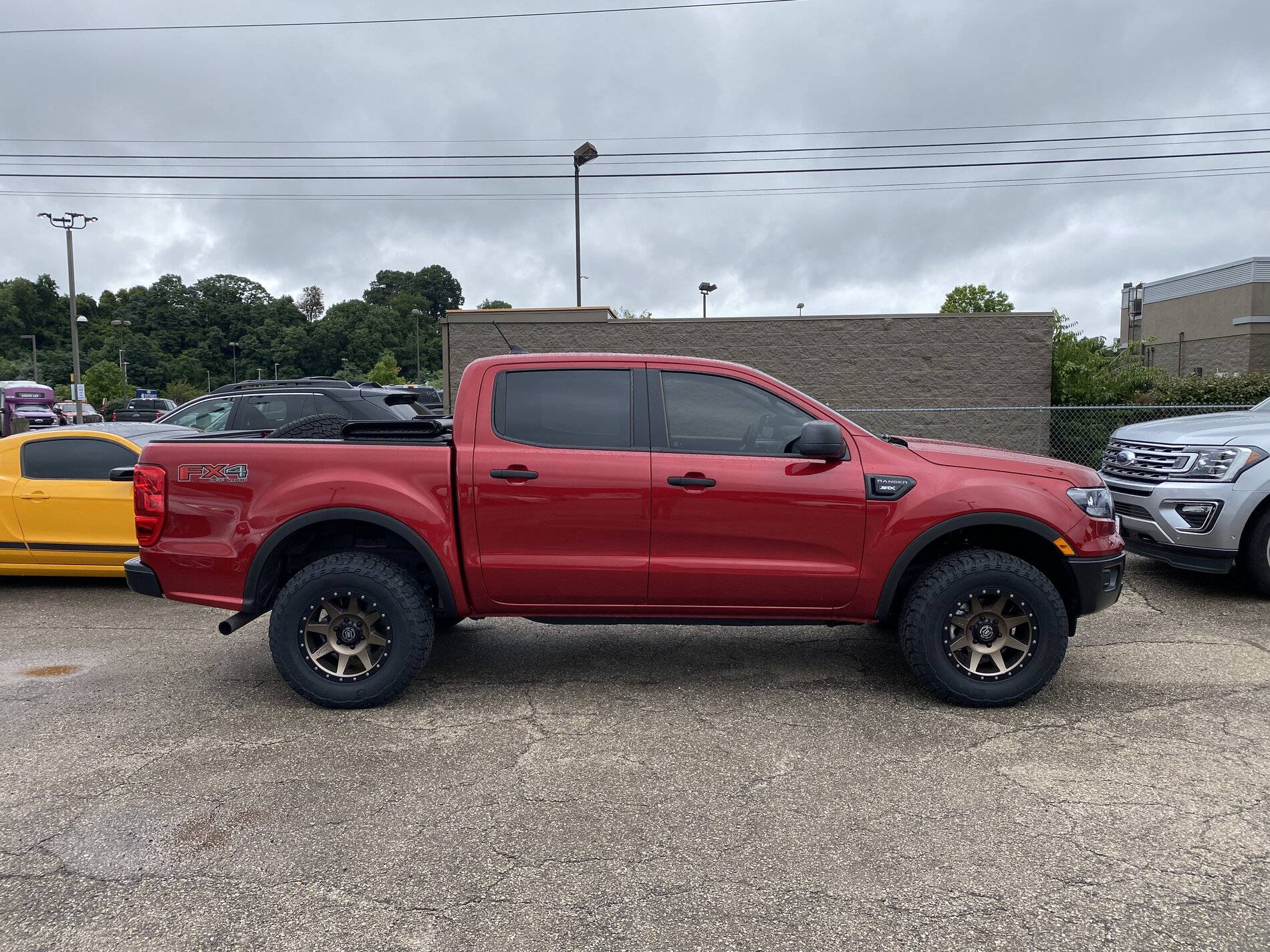

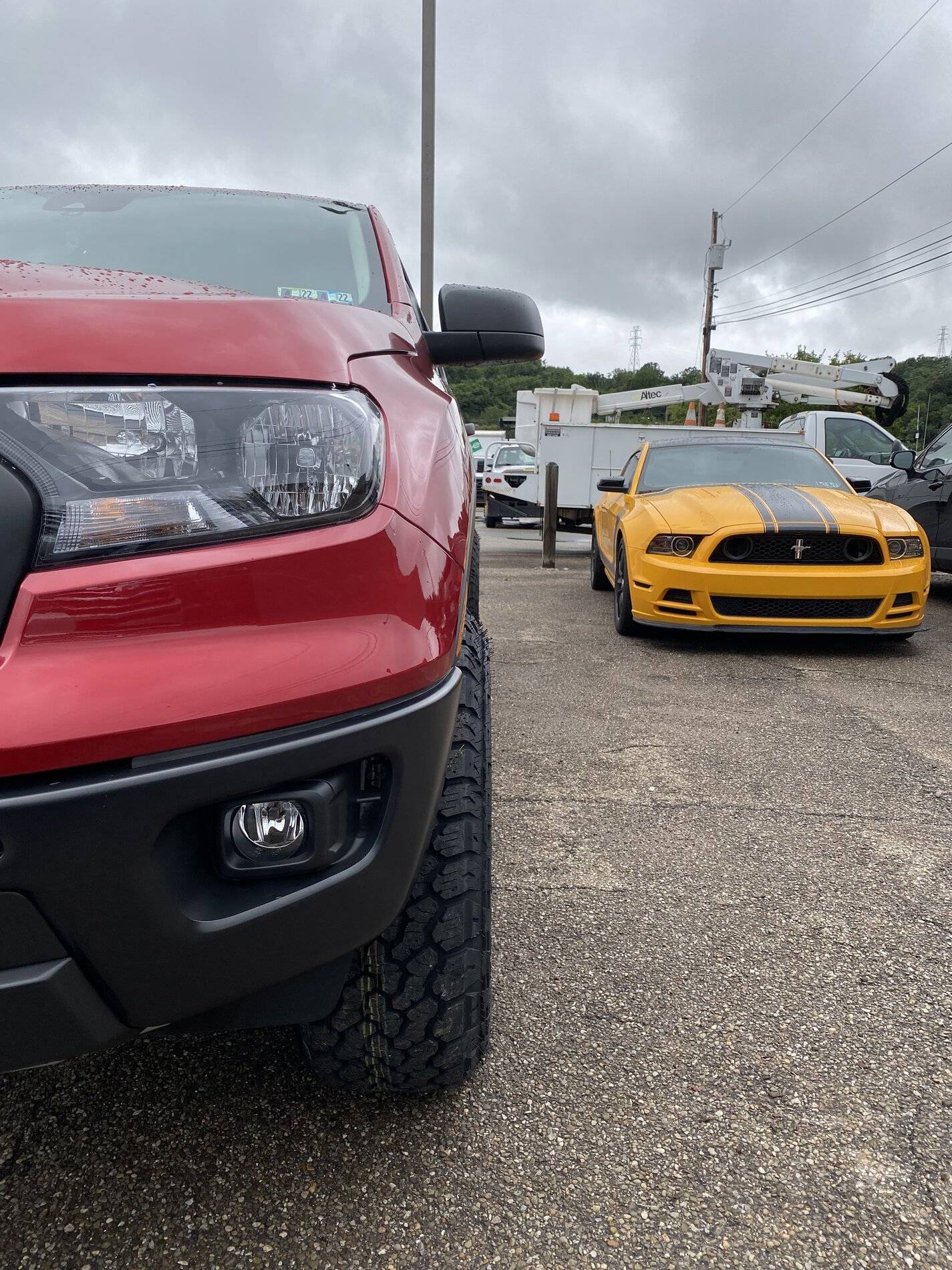

I had the front suspension installed today. Wow… what a difference in ride. Loving the Fox 2.0 so far and really loving the new stance of the Ranger. Also added “The Stubby” antenna.
next mods on the list:
Ford Performance Tune
Rock Sliders
Diode Dynamics fog lights (possibly light bar as well)
