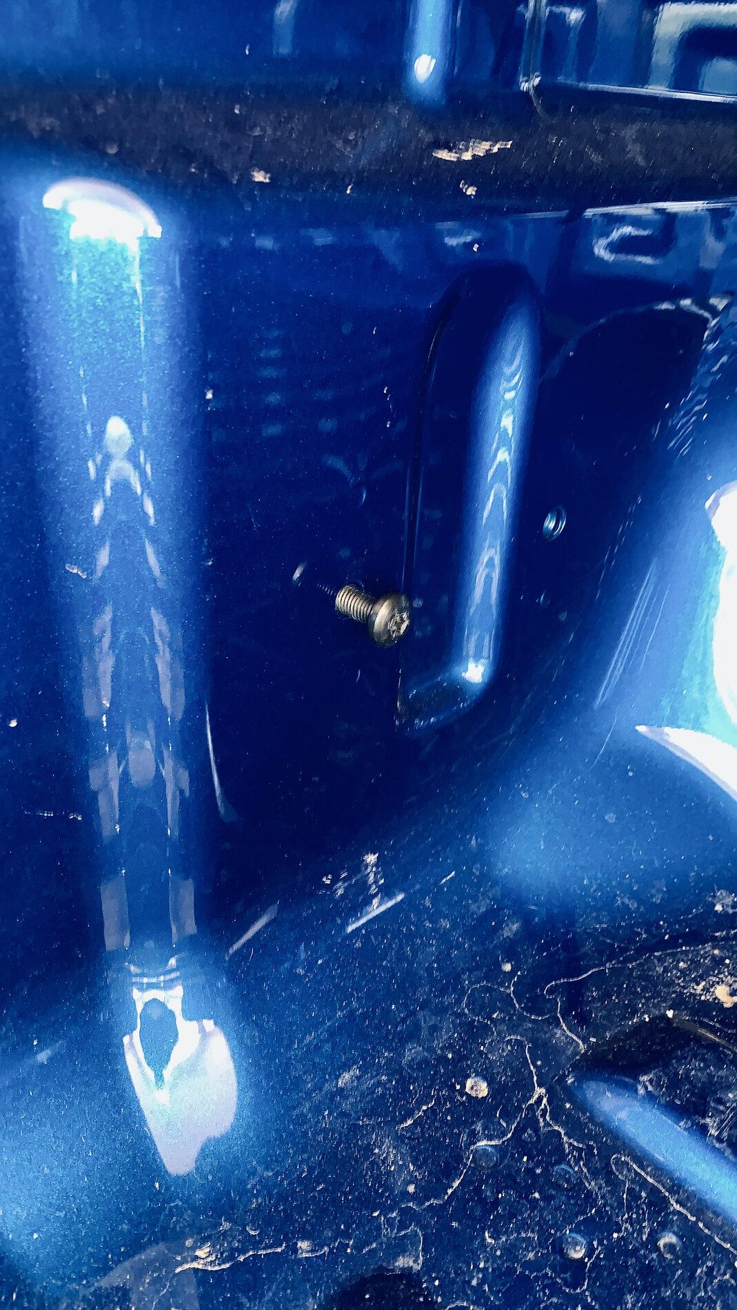

There are 4 holes available. These are slightly higher up to substantially higher up. Take a look.
You're right - there are 4 tapped holes. I am presently using the top 2 for my tonneau cover mounts. BUT - - I could easily substitute the current bolt with an eye bolt that would be more useful! Thanks

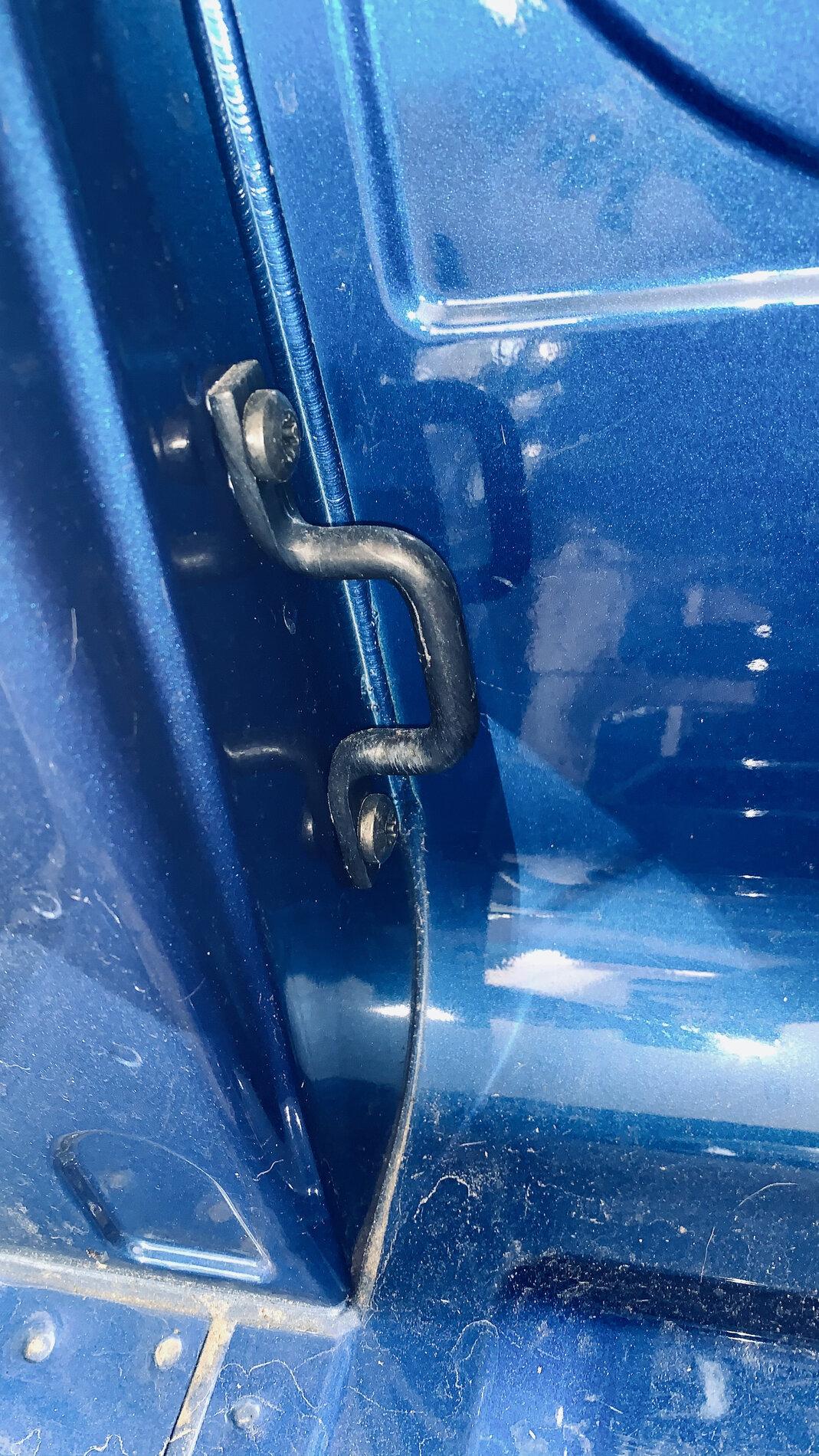

I have tie down spots in the back by the tail gate and at the front of the bed. There is a spot to put some in the middle but I want to utilize the already threaded holes but need to know the thread pattern. I took out one of the bolts of the other tie downs and took it to Tractor Supply to see if I could find some. I could not find one in standard or metric. I really would like to find an eye bolt to put in one of the holes. Thanks for any help.
M8 1.25 coarse thread
