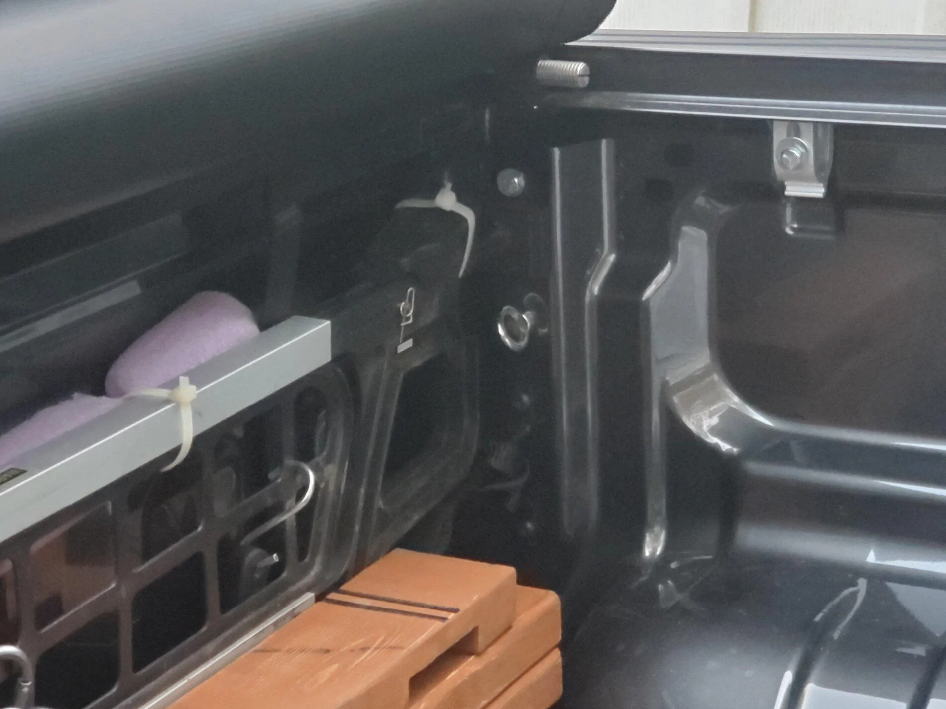

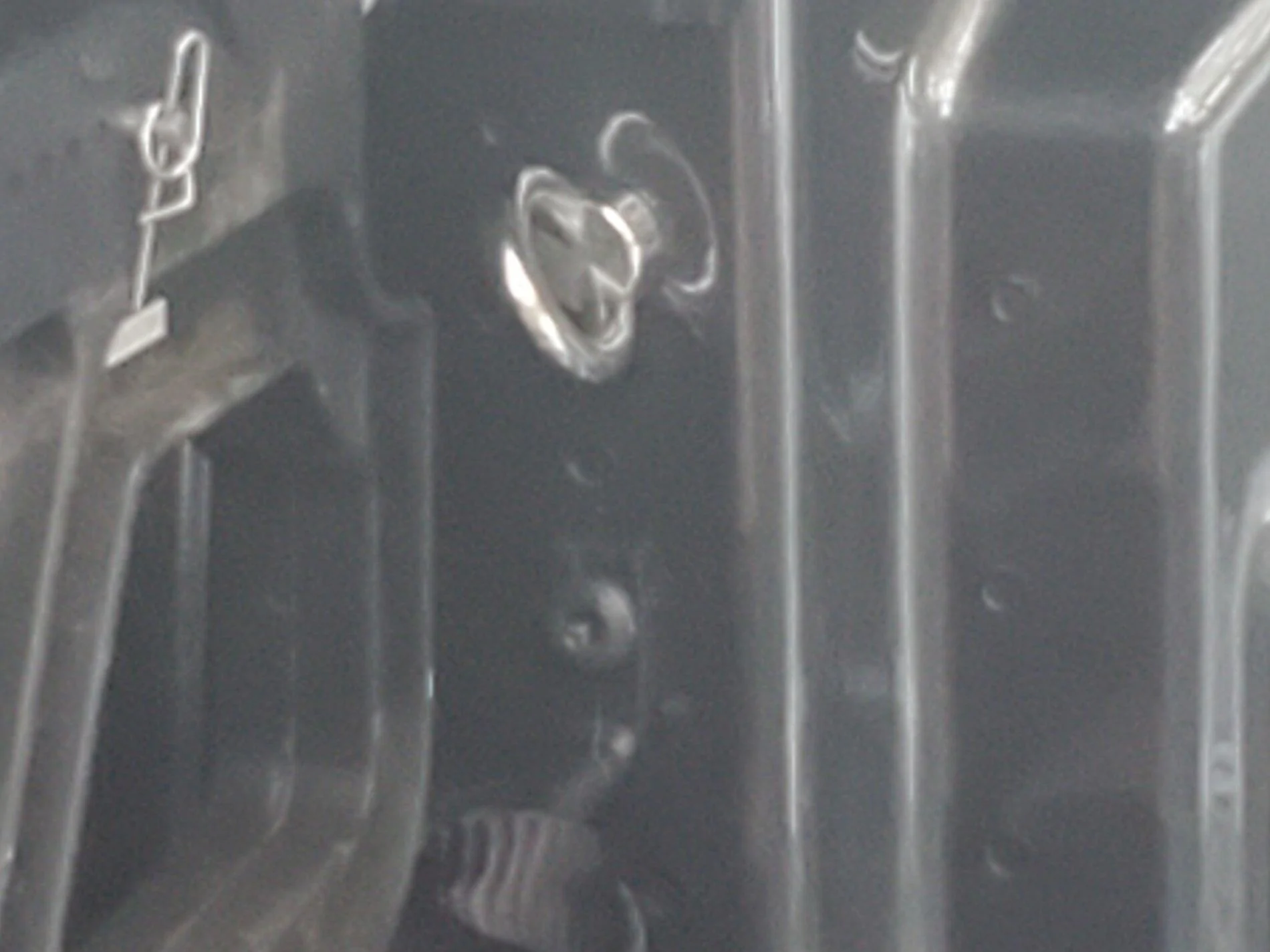

I wanted to find the holes before I ordered the eye bolts...I found four holes. You seemed to have use the upper two. I'll have to clean out the holes with a tap tool before I install.
I had the same problem with the middle tie down that Ford provided with the Ford Pass points. The sprayed in bed liner fills those holes nicely. LOL.
If owners want to adjust the eye bolts...it's available.

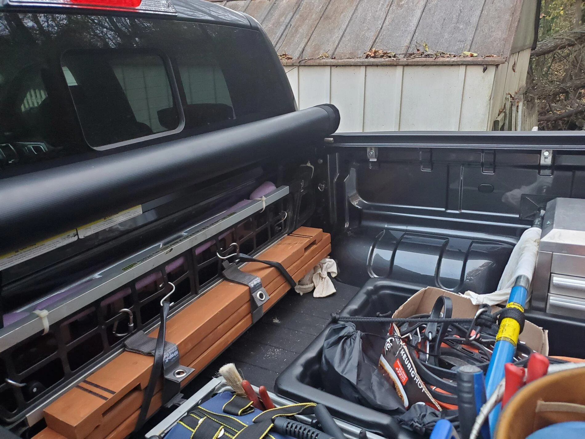

Are your new tie downs higher up in the bed. I keep loading the bed and then go through the PITA process of trying to loop through the lower tie downs next to the loaded bed.
There are 4 holes available. These are slightly higher up to substantially higher up. Take a look.
