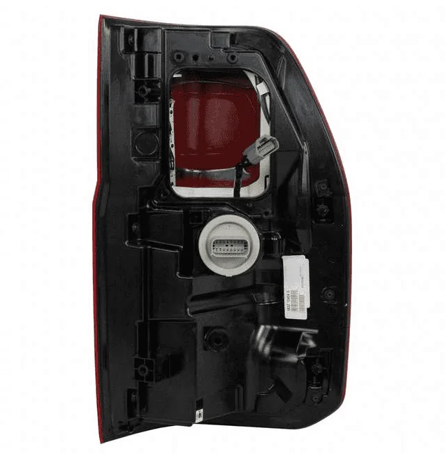

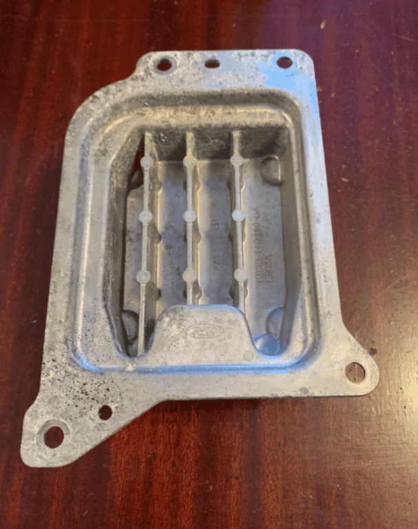

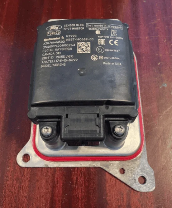

Where was this Blind Spot radar in the tailight assy?UPDATE.... today I removed the Blind Spot Radar from the boneyard taillight and installed the Radar unit from the original but cracked taillight. It works perfectly without a warning and showed the yellow dot when a car was in the blind spot. This tells me that a working Radar unit has been linked via a computer to the Rangers.
