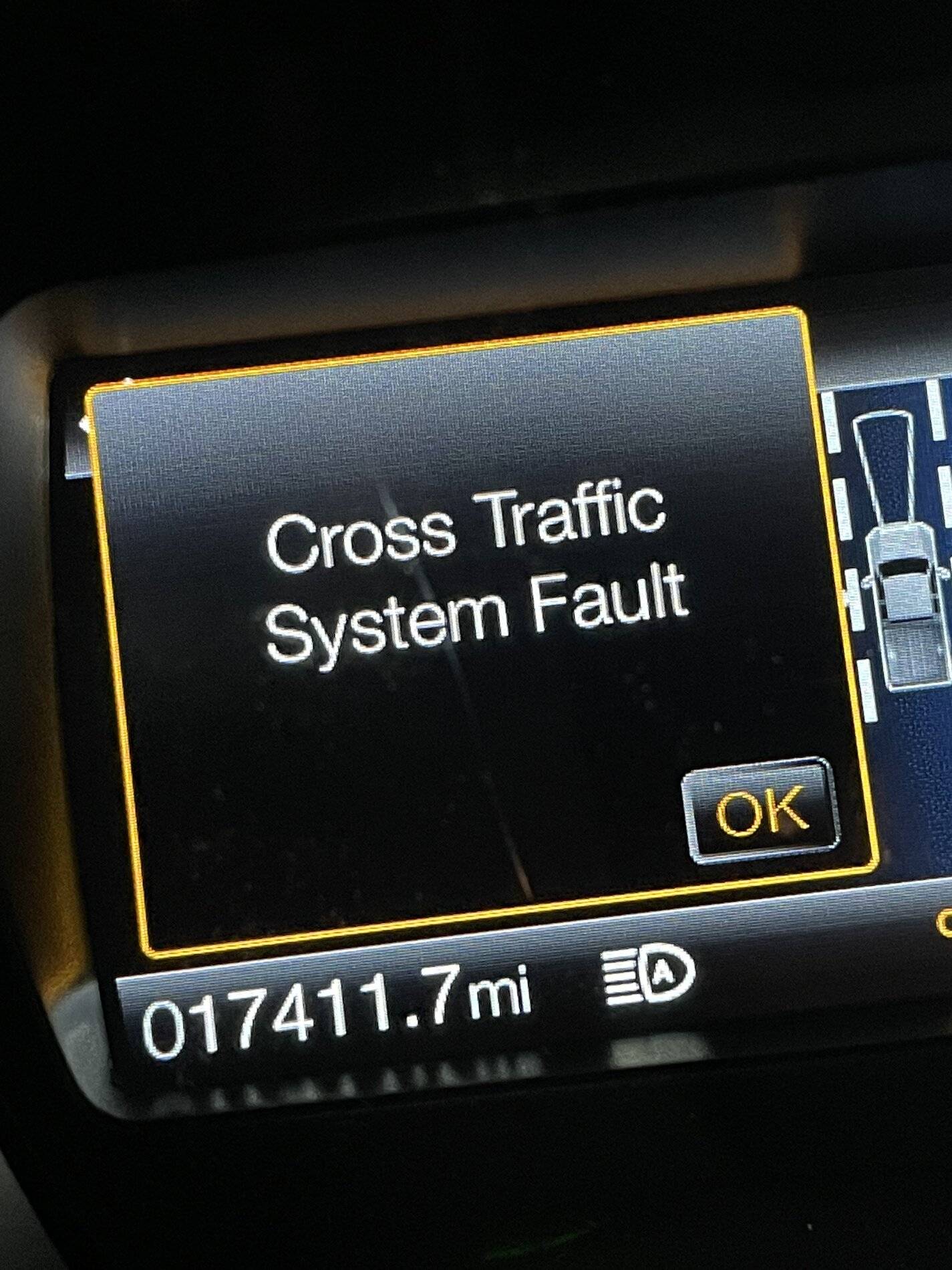

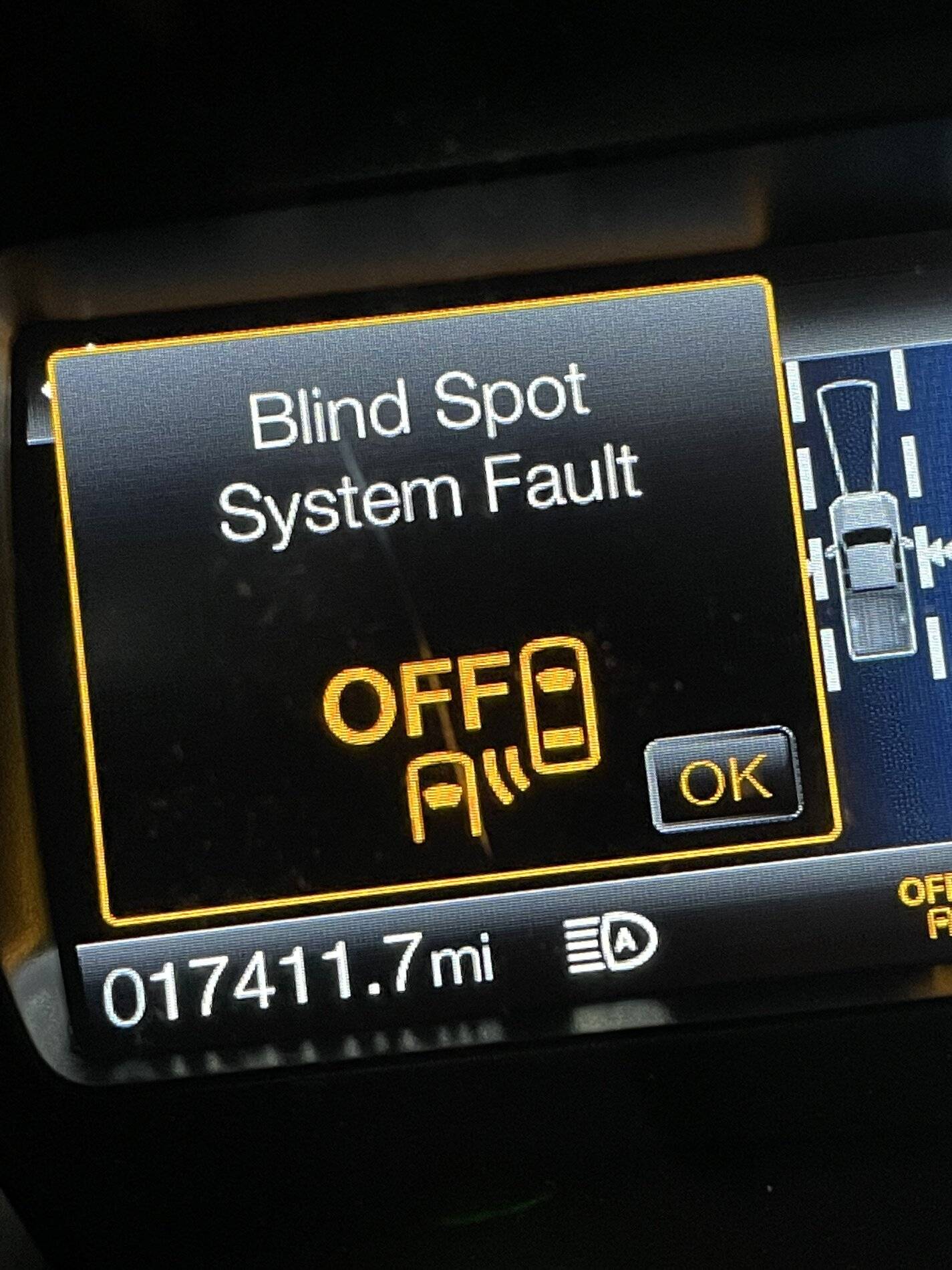

Just replaced a cracked taillight with another taillight assembly both have the radar unit. The new taillight now is sending the Blind Spot System Fault message. Looks like I have two options…go to dealer to reprogram or replace the radar unit for the original. The question I have is will the original radar unit need to reprogram also?

Just replaced a cracked taillight with another taillight assembly both have the radar unit. The new taillight now is sending the Blind Spot System Fault message. Looks like I have two options…go to dealer to reprogram or replace the radar unit for the original cracked taillight.

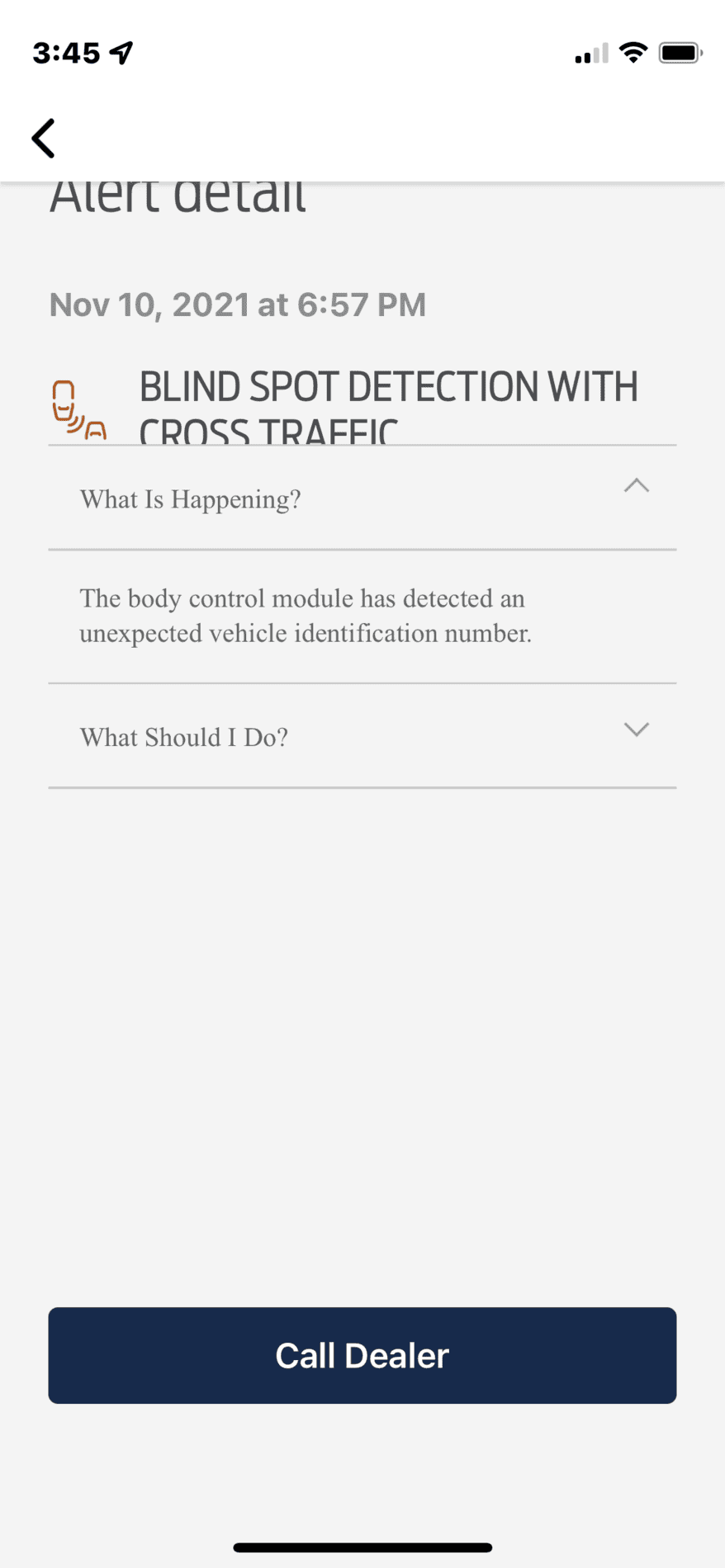

Hi, AzScorpion I disconnected the negative cable to the battery for at least 30 minutes. Turned the engine on and got the same message. looks like my next option is plan B... remove the original radar unit from the broken taillight and put it in the boneyard taillight, Apparently, the radar unit is linked to the Ranger. Attached is a message I got on my phone Ford Car Play app.

UPDATE.... today I removed the Blind Spot Radar from the boneyard taillight and installed the Radar unit from the original but cracked taillight. It works perfectly without a warning and showed the yellow dot when a car was in the blind spot. This tells me that a working Radar unit has been linked via a computer to the Rangers.
