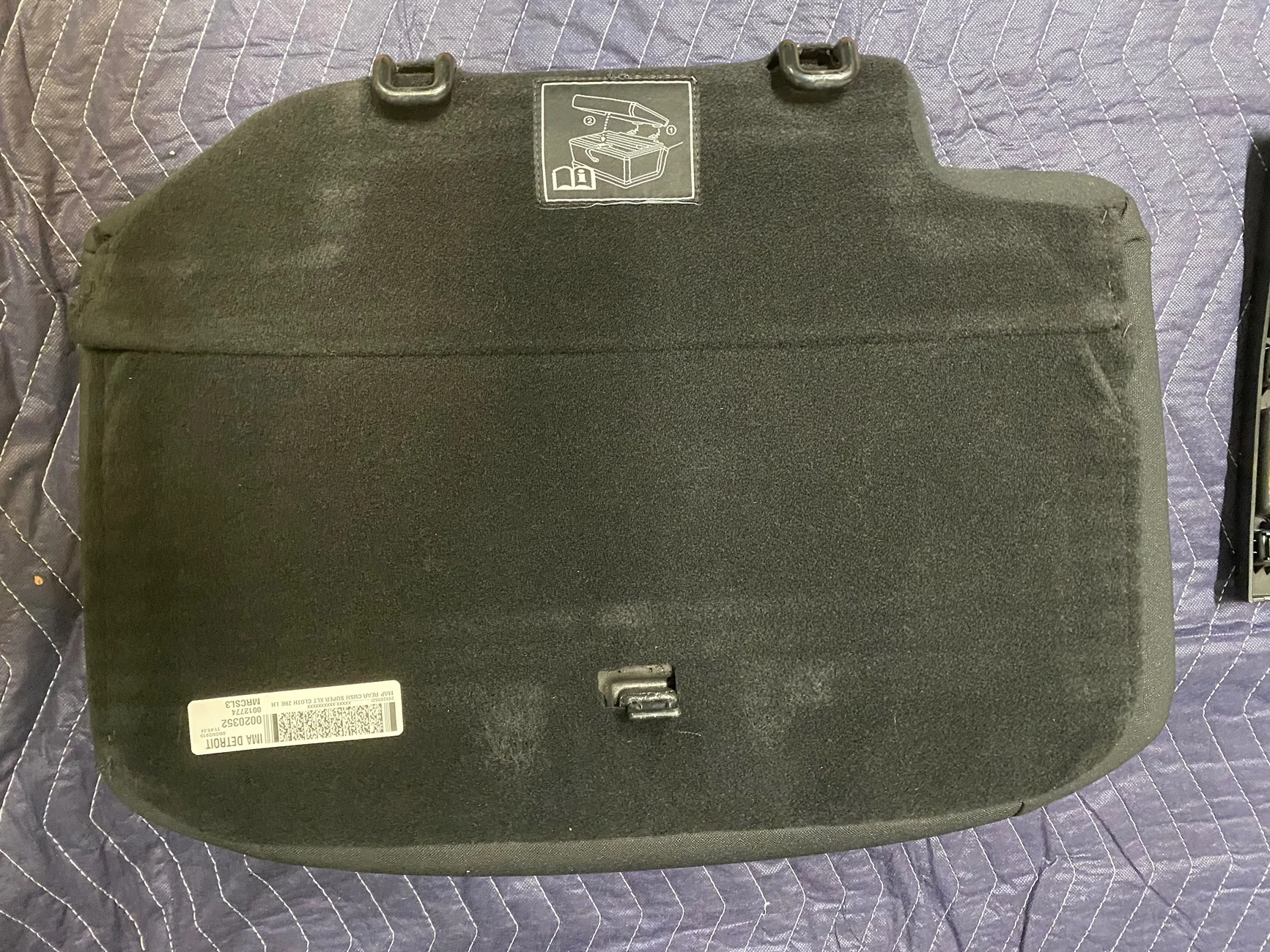

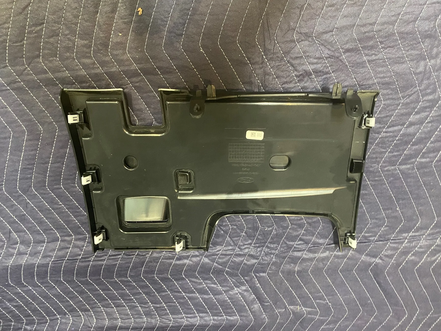

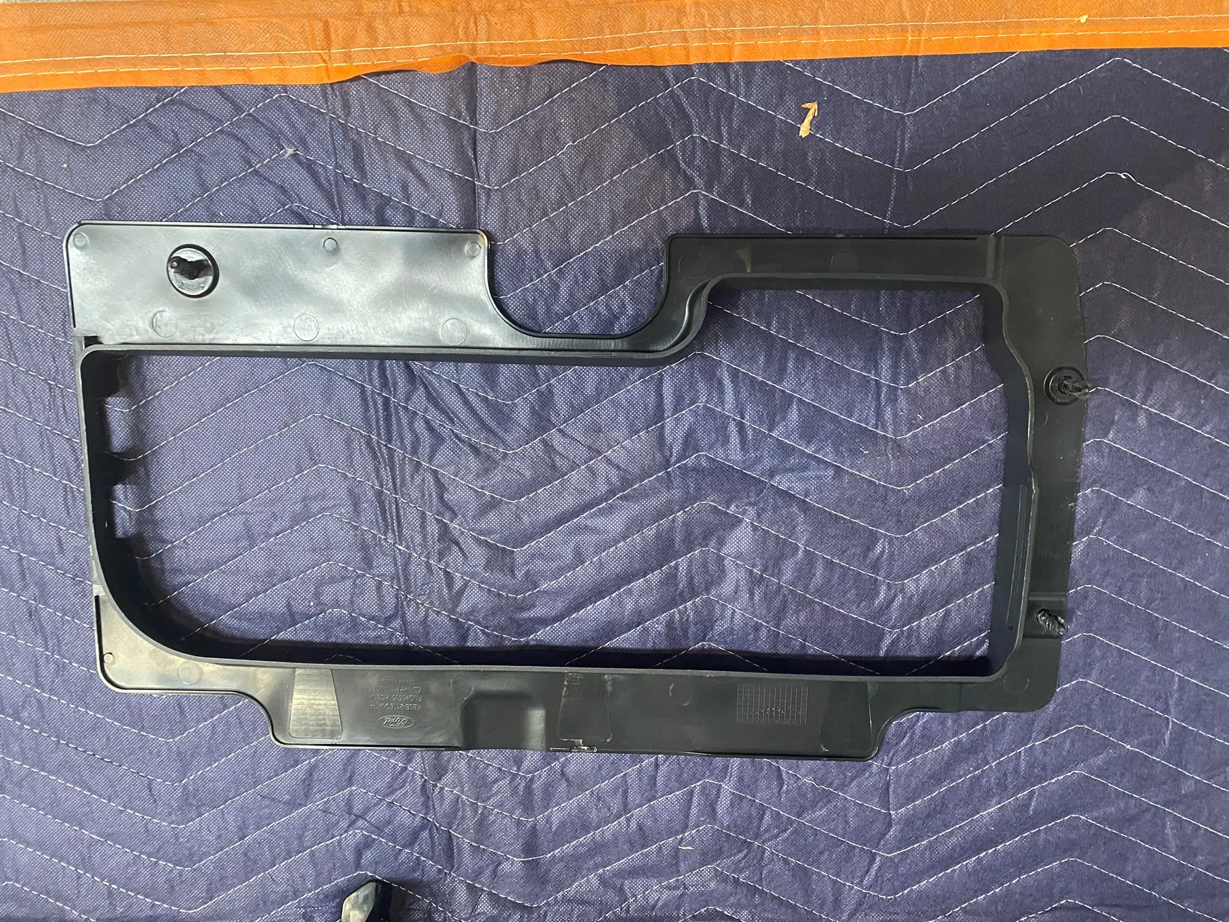

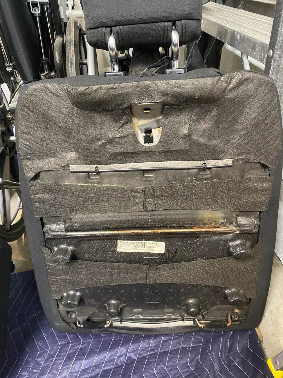

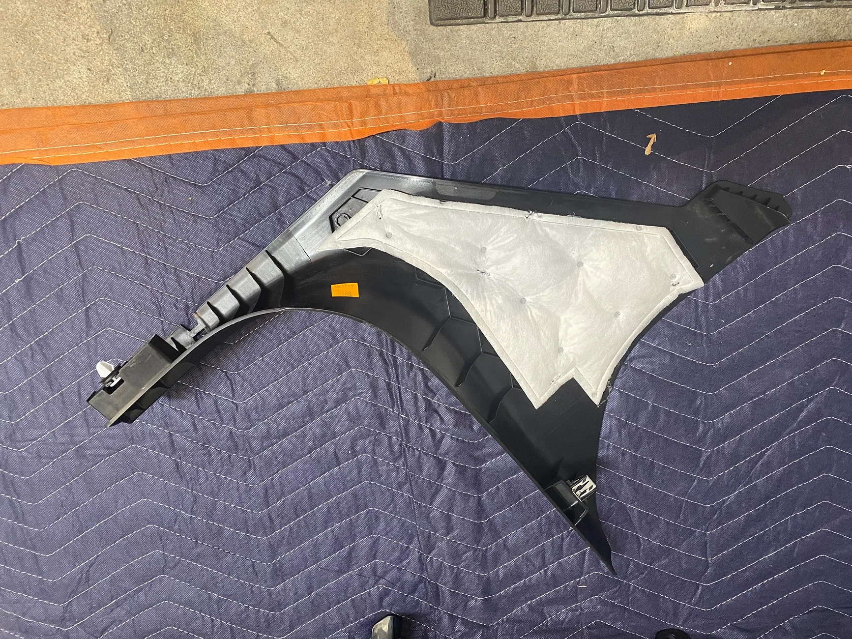

As Promised…
Here are images of the back side of the trim panels to show where all the clips and pins are located. Hopefully, this aids in removal with fewer or no broken bits.
Note: The supplied trim removal tool might be a bit small for some panels. A larger, stronger trim removal tool is recommended. So is patience and a gentle touch.
Reminder: These trim panels are for the SuperCab - FTW!
Fuse Panel Cover
Front Door Sill
Kick Panel
Rear Door Sill
Jack Storage Area Frame
Rear Side Corner Panel
Rear Seat Bottom
Rear Seat Back
Rear Wall - Hoop for Seat Bottom and Spring Clip for Seat Back
