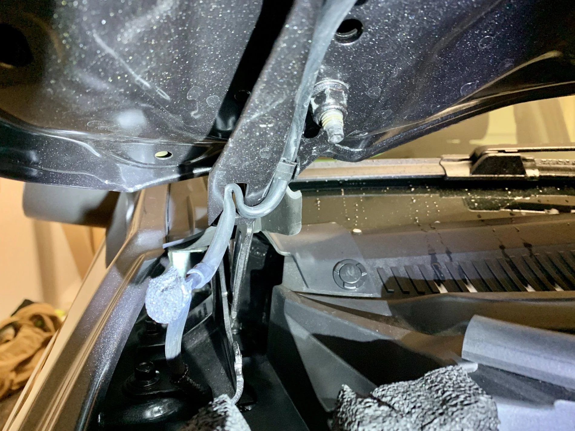

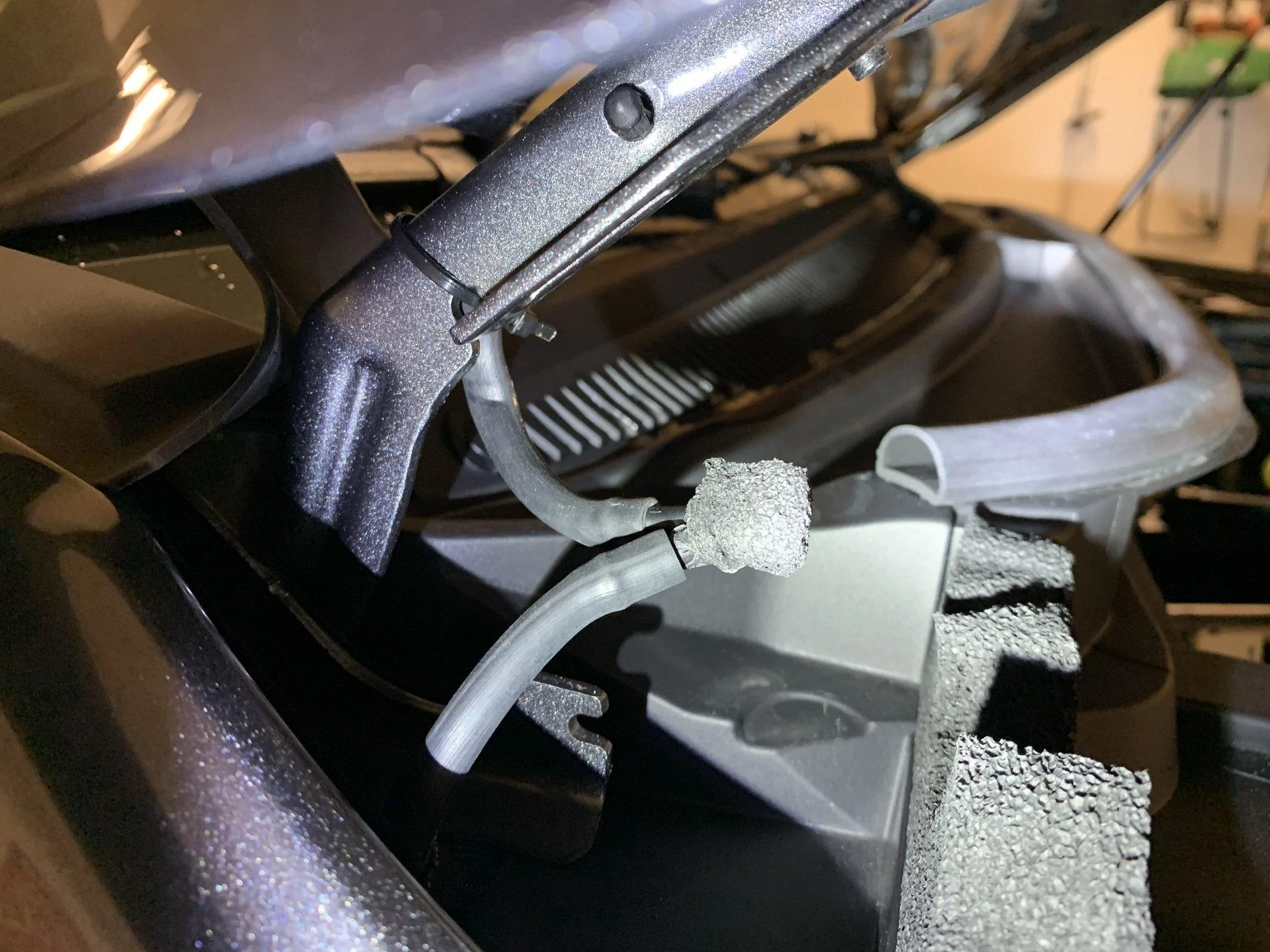

Update: the fluid line was pinched. It was caught under the hinge. I did not realize that the sprayers were attached to the underside of the hood. If someone could take a pic of their line just to make sure mine is routed properly, I would appreciate it.

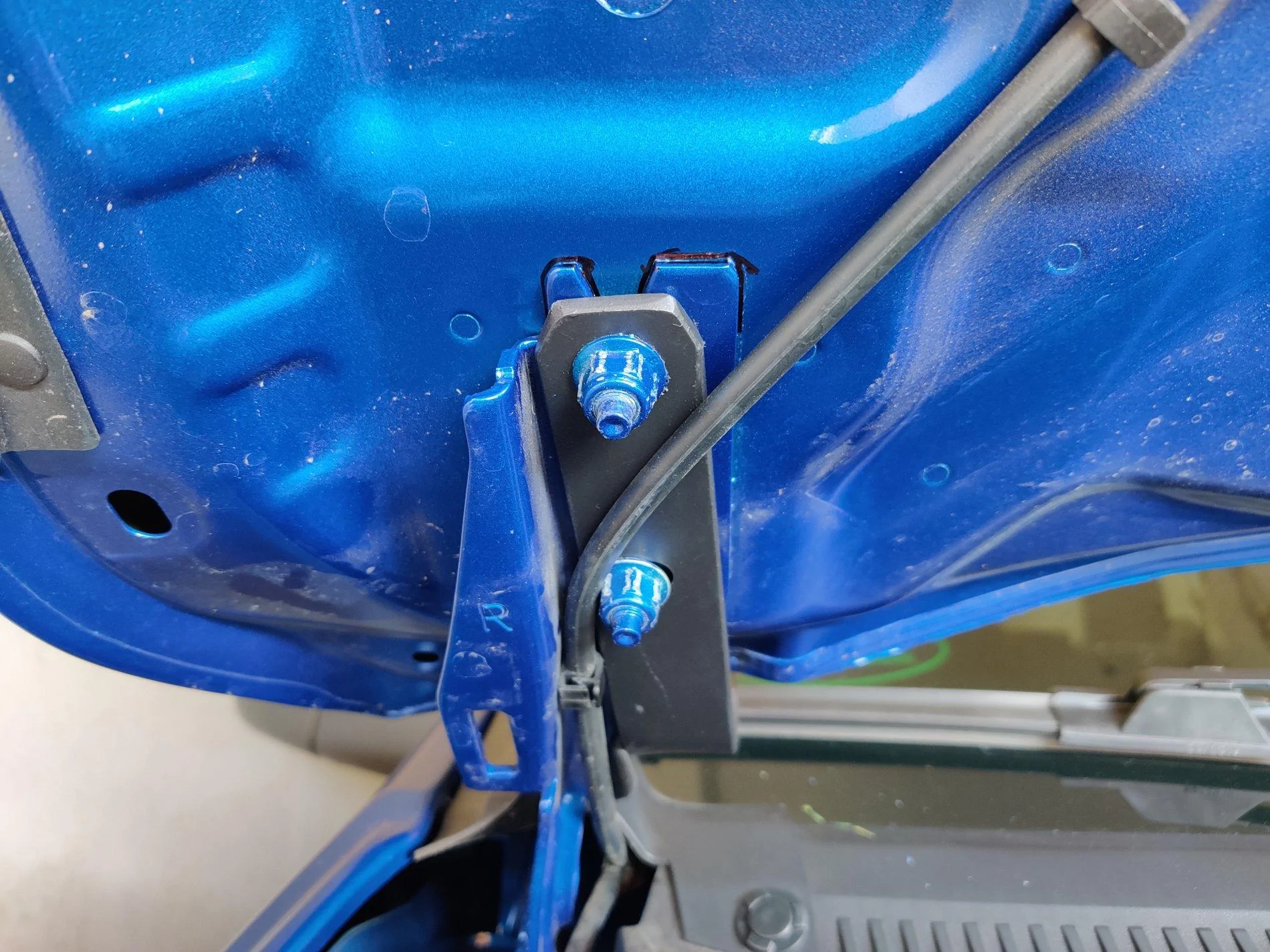

I just went and shot a couple pics. Looks like it does not stick out like yours does in your pics, but goes under the plastic cover.
Interesting. I really appreciate the pics. Looks like the factory didn’t do mine correctly.
