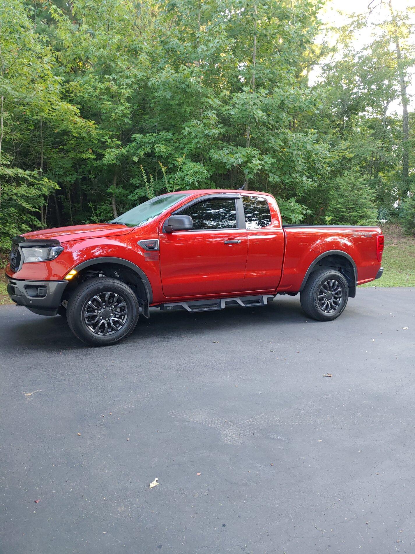

I have the stage 2 kit on mine, lariat 2wd w/ locker. No issues.

I have the Eibach front shocks raised 2.25 over stock with zero issues.

I have the Eibach strit and spring kit up front, and the shocks out back and I haven't had any issues. I don't have the Adaptive Cruise Control, but my parking sensors and lane camera all work fine. I'm even running an aftermarket front bumper with the front parking sensors moved into it and they work fine.

Couldn’t be happier! Really like the ride, the bounce is gone and the truck sits almost level now.
