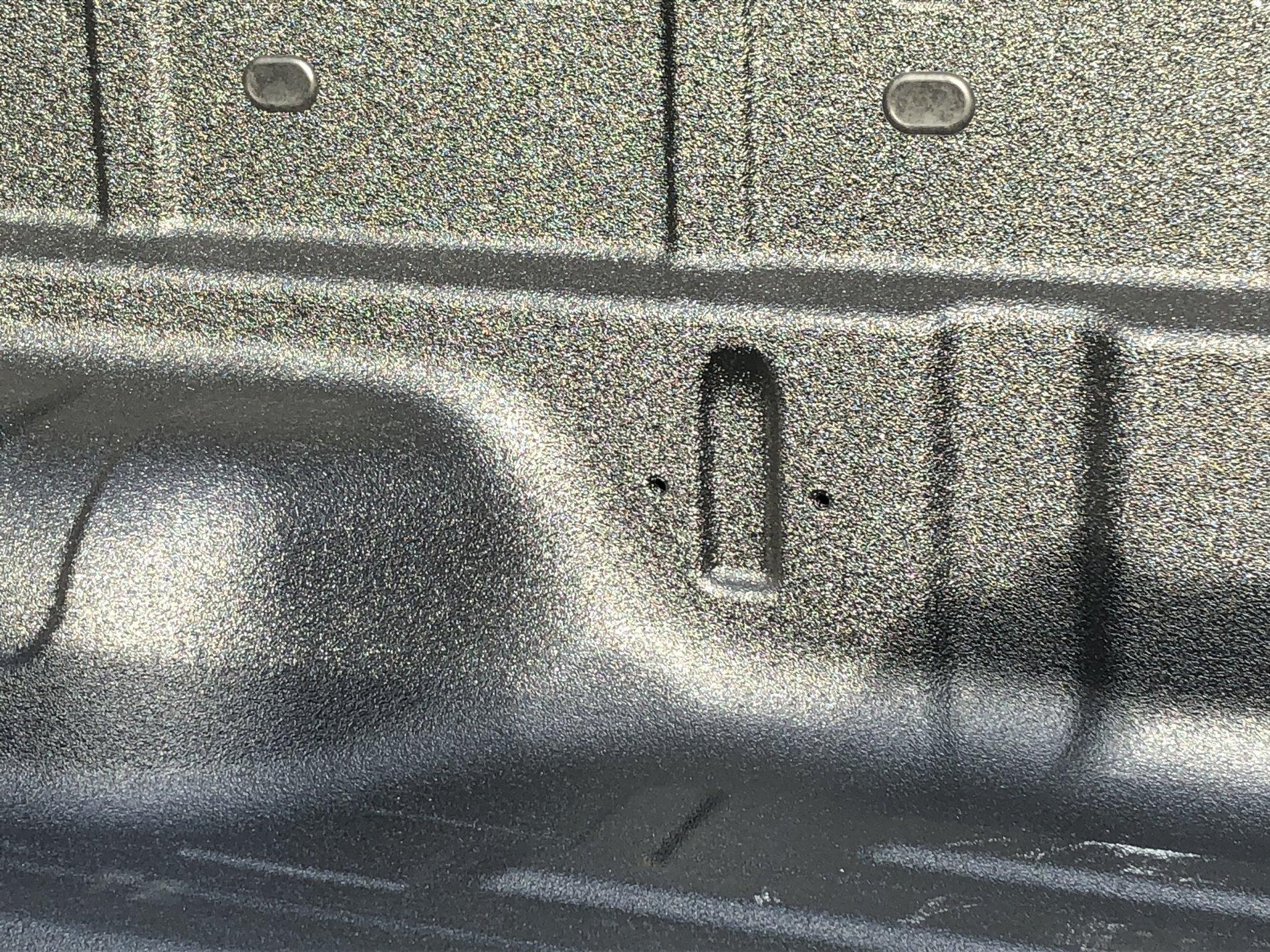

I want to secure a box in the bed to hold my tool boxes. There are two threaded holes in each sidewall just behind the wheel well that I could use an anchor points. I had a bed liner sprayed in and, of course, they got the material in the holes. I have to run a thread chaser through them but want to make sure I have the right size and thread. Anybody know?

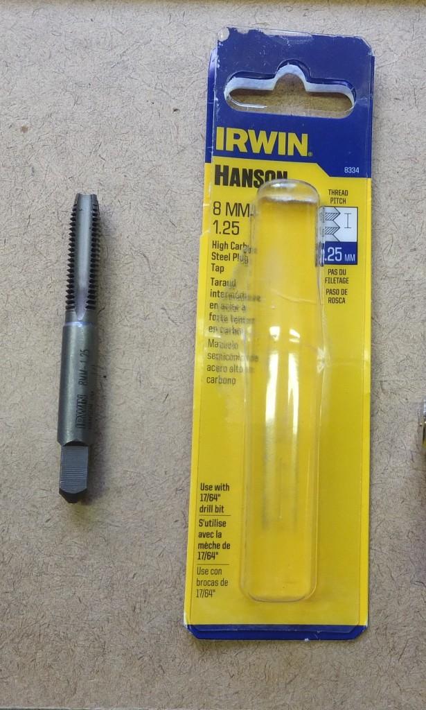

I know they’re 8mm but I can’t remember the pitch. It’s been a few months since I chased the threads on my own.

They’re M8-1.25

Photo doesn’t show it but there are two loops up front and two in back. LNK Keff - thanks for the dimensions.

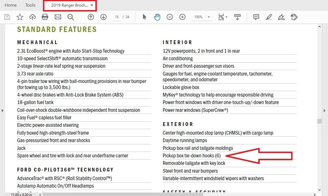

You should have 3 tie downs per side, when FORD was frantically making the ranger they ran out of tie downs, so they started to install only 2 per side. I only had 2 per side; I was able to show my dealer that the trucks should have 3 per side as 90% on the lot had 3. They gave me the additional 2. Think there was a dealer notice to give anyone that asked the additional tie downs.

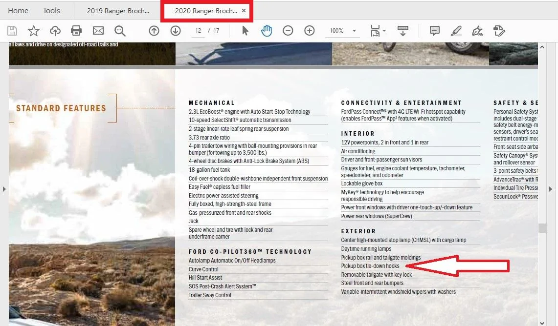

The 2019 Brochure states (6)... the 2020 doesn't state quantity. Therefore a savvy dealer could state you have no grounds to justify additional tie downs on the 2020

The last Dealer Order Guide revision for 2019 still shows six(6) tie downs, and the first 2020 version shows only four(4)
