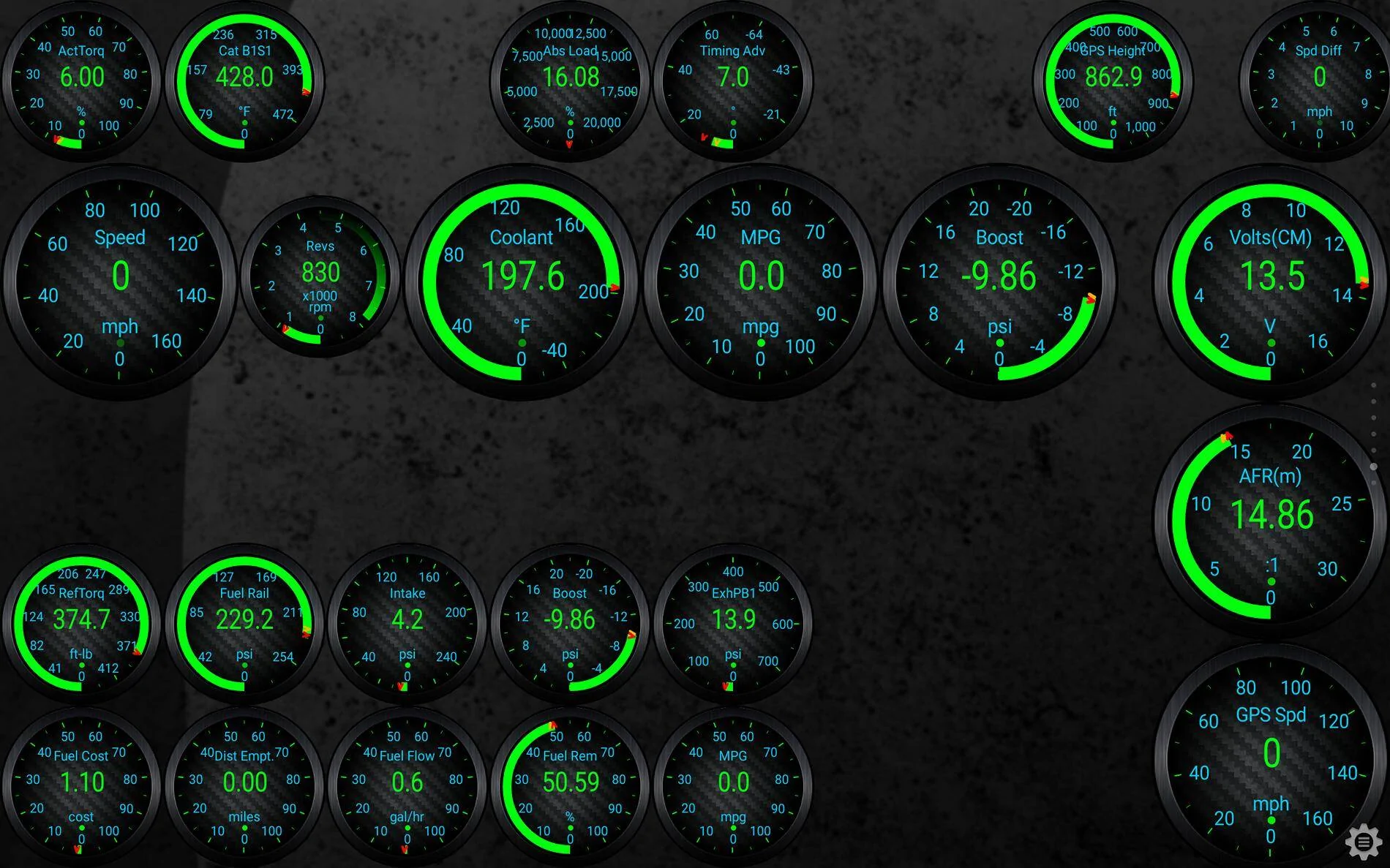

I have run an android app on both my phone and tablet called Torque for a few years now and love it, it monitors in real time read and rest codes, you can set your own screens for what ever pid you want to monitor :)

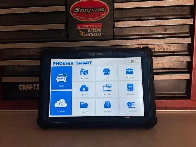

I pulled the trigger on the Topdon Phoenix Smart
Cyber Monday $1995.00
Adds SOME more functionality over my current Autel MS906TS.
This tool is great for the brief playtime I did with it today.

Now throw in a Pico and I,ll be your best friend when I need some trouble shooting ? Since were practically neighbors.
