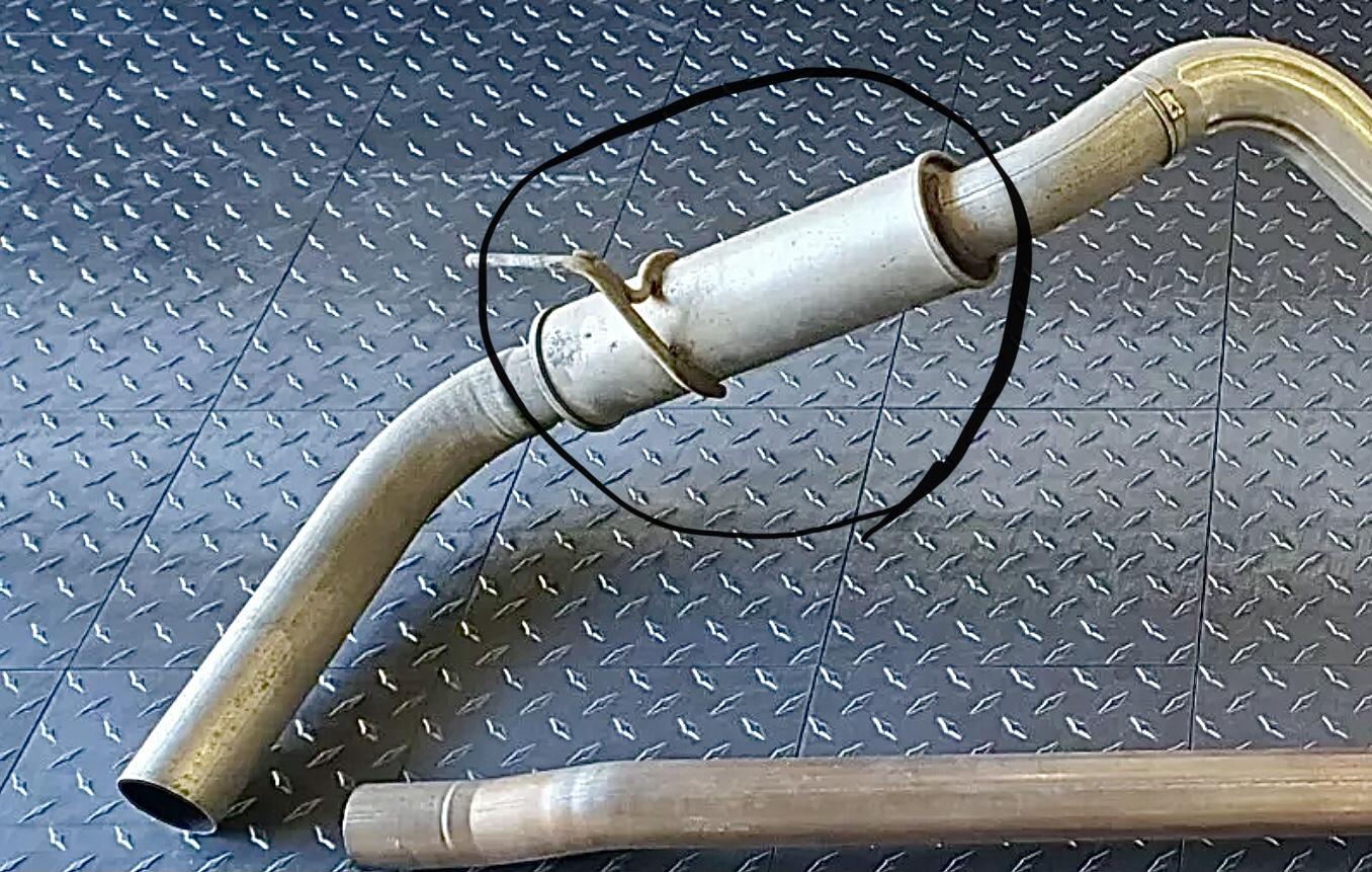

What is this exhaust part

And what is it used for ?

Thanks
Must change the sound some what

They are for removal. At least that's my opinion.
Hi Robert,
Correct...the resonator counteracts the exhaust pulses 180° to counteract the incoming pulse....To A Degree... Helps to tune the exhaust by taking out harsh, unwanted frequencies.

Hi Robert,

I removed mine on my sport trac and the sound was way better. Never really noticed any performance difference but you could actually hear the 4.0 rumble when on the gas afterwards. even got asked a couple times what kind of exhaust I was running after.
As everyone runs to get their hacksaw...?
It was before the muffler on the sport trac haha. Would have been real loud if hack sawed from there haha
