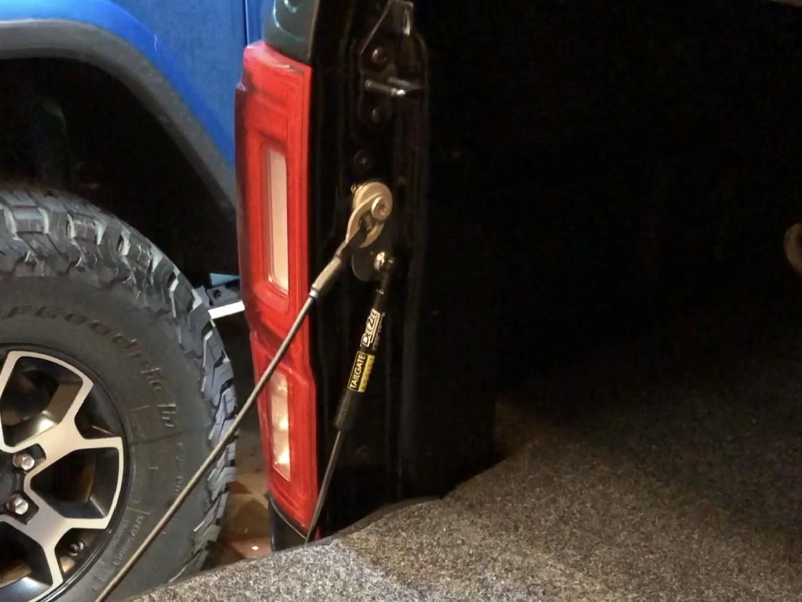

Finally......after not having one of these, I had come to dislike dropping the tailgate immensely. Lol. I know.....lazy. I can open it without hesitation now.

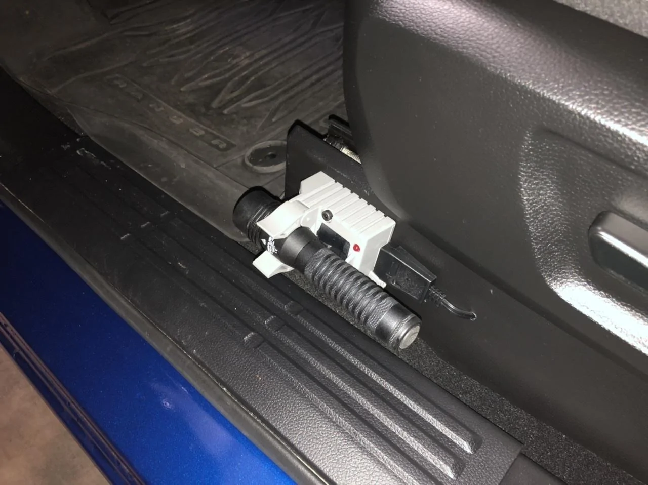

I mounted a charging cradle for my Streamlight Strion. Decided this is a good spot that’s easily accessible yet hidden from view. If you can’t tell what you’re looking at, that’s the side of the driver seat.
Edit, months later: if you're wanting to do this, mount it farther back where the head of the flashlight is away from where you swing your leg into the truck. I knock it off quite a bit and I've had to retrain myself how to get in.

How to?
dmeyer302
Daniel
Feb 18, 2019
686
1,646
Carthage, MO
2016 Odyssey, 2021 F-150
Mechanical Engineer
1. Remove sill plate and kick panel
2. Loosen seat trim just inboard of the flashlight in the picture.
3. Fish wire under the carpet down to the sill plate, then up to the fuse panel. I found another unused fuse like I did in this other post.
4. Mount cradle as required.
Pretty simple process, really. I thought about using the power wire for the seat motors, it's right there in a harness. But I wanted it switched with the key instead of hot all the time.
