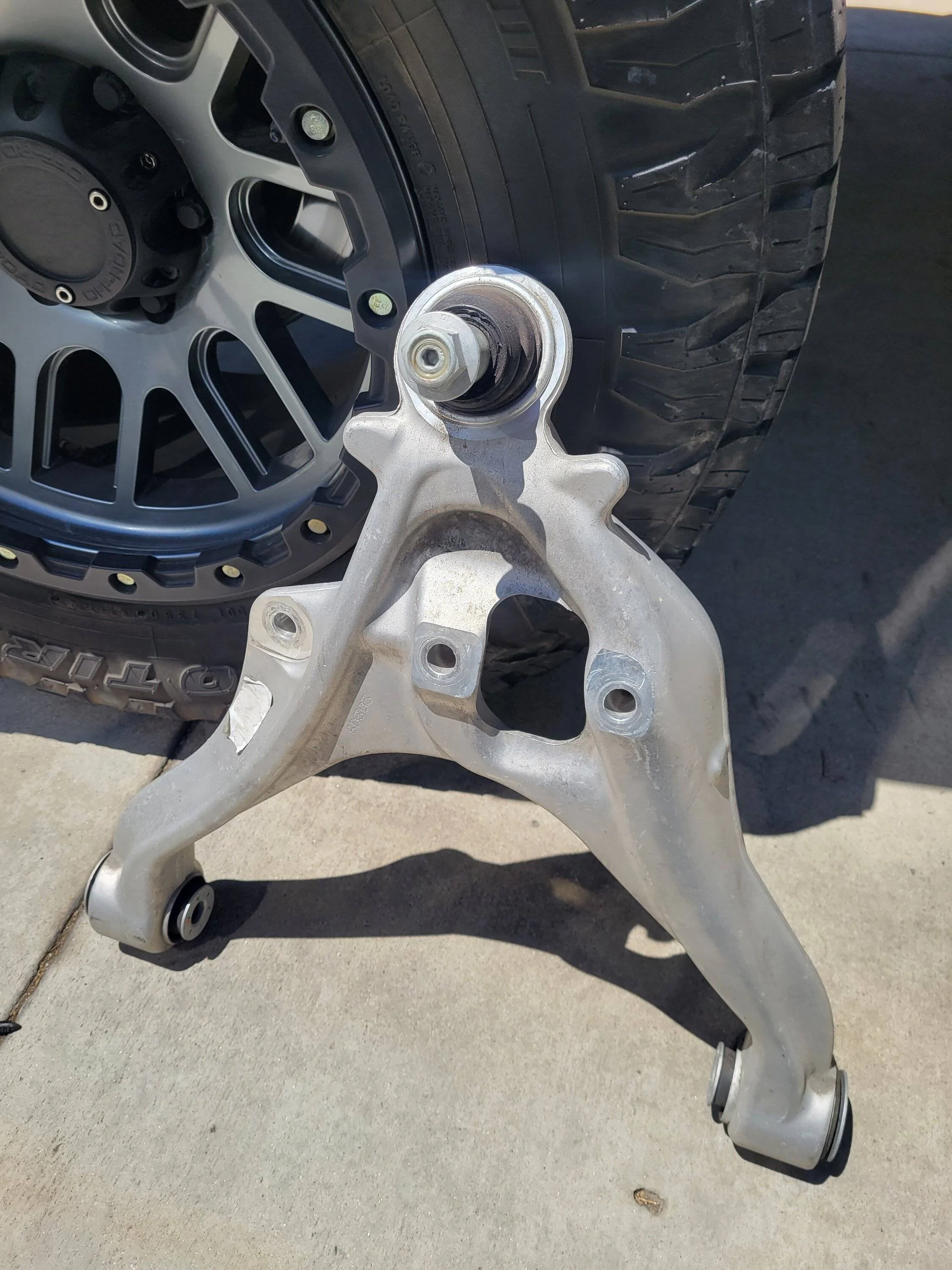

@TerraMechE @Colo_Ranger @20XLRangerFraptor @APG i went today to apg. Man theyre awesome people. Several of the theories ive had that several people have said couldnt be done. Yes a m210 from a bronco will bolt up. There is a bracket the needs to be flipped. If youre going to retain stock width will need to get some rcv axle, but if you go with bronco width you should be able to use standard axles. They said no front driveshaft was required just axles. Now with that being said doing a full bronco swap or bronco long travel on a ranger should be pretty straight forward. I purchased theyre bronco take off parts a set of upper and lowers for a bronco. I will be saving to buy a m210 and regear for rear to do full mid travel until i decide to build my bronco width long travel set up since that would be very expensive just on axles will be a 2k purchase.o and from what i was told theyre pretty much no longer focusing on ranger, and shifted theyre attention to the Bronco.
I’m definitely interested in the LCA and UCA from the bronco and what it takes to make it fit. Can’t wait to watch your journey.
@TerraMechE was the pioneer in that. Now i think with all the information gathered most people should feel comfortable with gathering parts. Now my restriction is money lol.
That’s very nice to hear!!! I figured they were close enough to make work but any time I commented on a company online they would make it sound like it wouldn’t work. If you don’t mind how much did you get the take offs from them? I’ve been lightly searching for some myself but kept getting scammers messaging me. I would like to do some bronco arms until I get full long travel!!
Your plans are same as mine. I picked them up for 500 they had several in stock.
