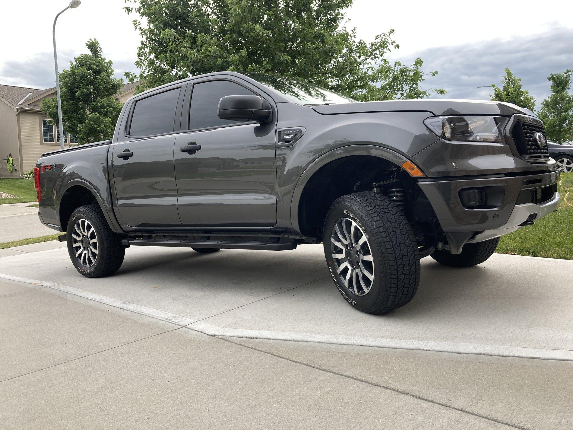

Installed the Fox 2.0 State 1 kit the other day.
Not too terribly hard in your own garage. A lift and some AC would be nice tho 😂. Loving the kit so far !
Nice, where did you purchase the Fox2.0 and how much lift added on the front? Thanks.
