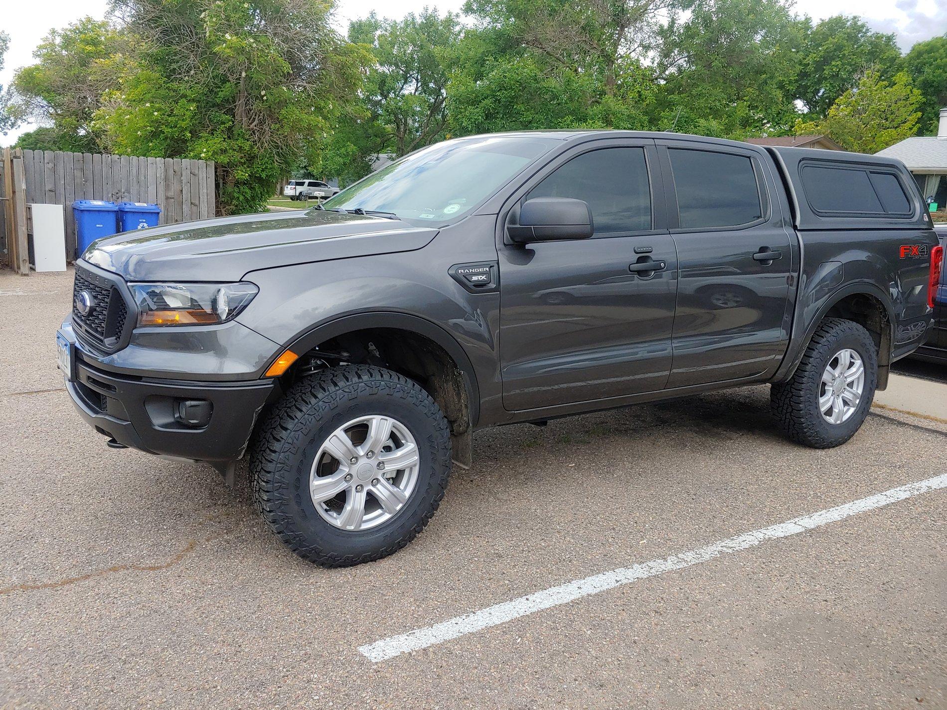

runner69
Eric
Jun 5, 2020
61
126
80538
2019 Ranger
Transit bus mechanic, former Ford master tech
runner69
Eric
Jun 5, 2020
61
126
80538
2019 Ranger
here it is with the Ford/Fox leveling kit and the 265/70/17 Goodyears
