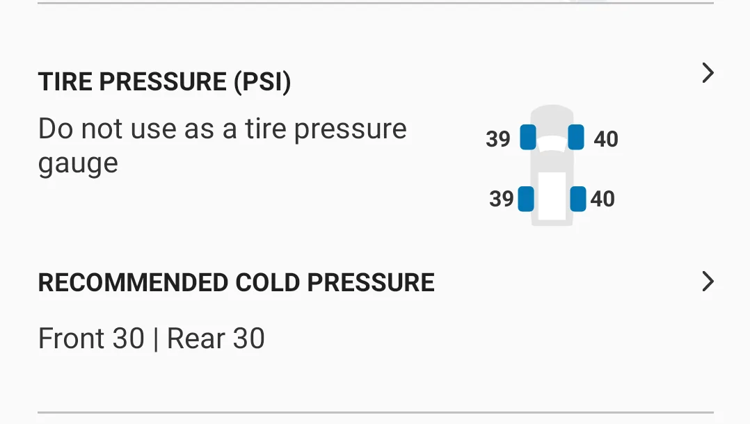

Have you checked your air pressure?
My new Ranger came home with 45 psi in the tire. WTF people, I thought I was going to start bouncing. Actually I got my FordPass Android app to report the tire pressure.
But aside from that, it's very comfortable for me. I come from a late model Escape. I have to duck my head a little to get in but not like people have to do with a Tacoma.

I’ve had multiple Rangers and s10s over the years and my 4wd crew sport is the most enjoyable truck I’ve ever had. When I drove it the first weekend I was bouncing all over the road until seen my tires were at 47 psi. I put them on 30 and has been great so far.

My ford pass says 35 as well
My door jam and FordPass both say 30 PSI. Mine is a 4X4 crew cab. I suspect where you're seeing 35 in the manual is on page 213 and that is merely an example being provided, not the actual rated PSI you should be using. The door jam sticker and/or what's printed on the tire sidewall itself is the gospel for your tires. The only time the door jam is wrong is if you're not using the stock OEM setup which I suspect you are. It's extremely odd that FordPass wouldn't be the same as what the OEM settings are.
Mine came from the factory/dealer with 40 PSI in the stock 255/70/R16 Bridgestone Duelers.
Upgraded to 265/70/R16 Falken Wildpeaks, tire guys only put 30 PSI in, I'm guessing reading the door numbers, on a tire that is .5" bigger, wider, and more aggressive. Checked online, same tire company recommends 41 psi, and I believe their max load rating is at 45? I've been running them at 40 without it feeling stiff.
I believe the Fordpass app tries to tell me they should be 30 psi.

35 is on the door tires manual fordpass and on google it is literally everywhere?
Don't feel like going out in the 20 degree weather to take a picture of the door sticker.
But FordPass says 30 psi. Pretty sure the manual and sticker does too.
So no, not literally everywhere.

Based on other threads I have read with actual door sticker pictures, different configurations come with different tires and ford does have different door stickers to accompany that. I believe I have seen 30,it 35, and 40 psi door stickers in threads. So is possible that you are both right for your specific truck.

...and I specifically said that it depends on the tires but more importantly I can't find a single place in the owners manual that recommended tire pressures are given. They'd have to reprint the manual every time Ford changed vendors which makes no sense. That's why the door jam is the best place to start. I wouldn't trust what FordPass has in the first place since there's no way it knows specifically what's installed on my truck. I run the OEM tires therefor the door jam is the right PSI.
I cannot possibly fathom how anyone driving today would resort to Google to get an answer that is printed on their vehicle and the tires themselves in the first place. YMMV...

Funny how people are saying go to 30 PSI while it depends not only on the model but also the packages installed. Mine should be 35 according to the door sticker, similar as with @Nbenninati. When I took delivery, they were actually at 45, I lowered them to 38 to get rid of the stiff ride, I never had them at 35 yet.
