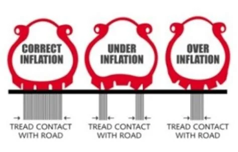

You'll risk prematurely wearing out the center of your treads when over inflated for extended periods...but you'll get better mpg...

Back in my off roading days,often the larger tires needed some extra attention. To see if the inflation is about right,we would 'chalk the tires'. Using the big chalk you can get at most builders supply store,( Lowes/home depot) etc. Take that chalk and lay it on it's side,(length wise) and chalk a two or three inch wide stip across the top of the tire(s) and drive it in a straight line for a couple of hundred feet. I used to use an empty parking lot,plenty of room. If the chalk scuffs off the middle of the tire,you are over inflated. If it scrubs off on the edges,your tires are under inflated. Easy as pie...

Just saying that if you're running 45+ psi and not carrying extra load, you're reducing your contact patch, traction and creating unnecessary harsh ride. Yes, if you're at max GVW then by all means pump them up to 80 psi to maintain said contact patch.
