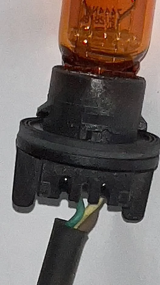

Set your DVM to measure DC volts, turn vehicle on, turn on working bulb that blinks, go to working side bulb, connect BLK lead to GND, using RED, measure both pins, one should indicate ~ 12VDC, the other 0 VDC. Record results as to what wire has DC voltage. Repeat on other side.

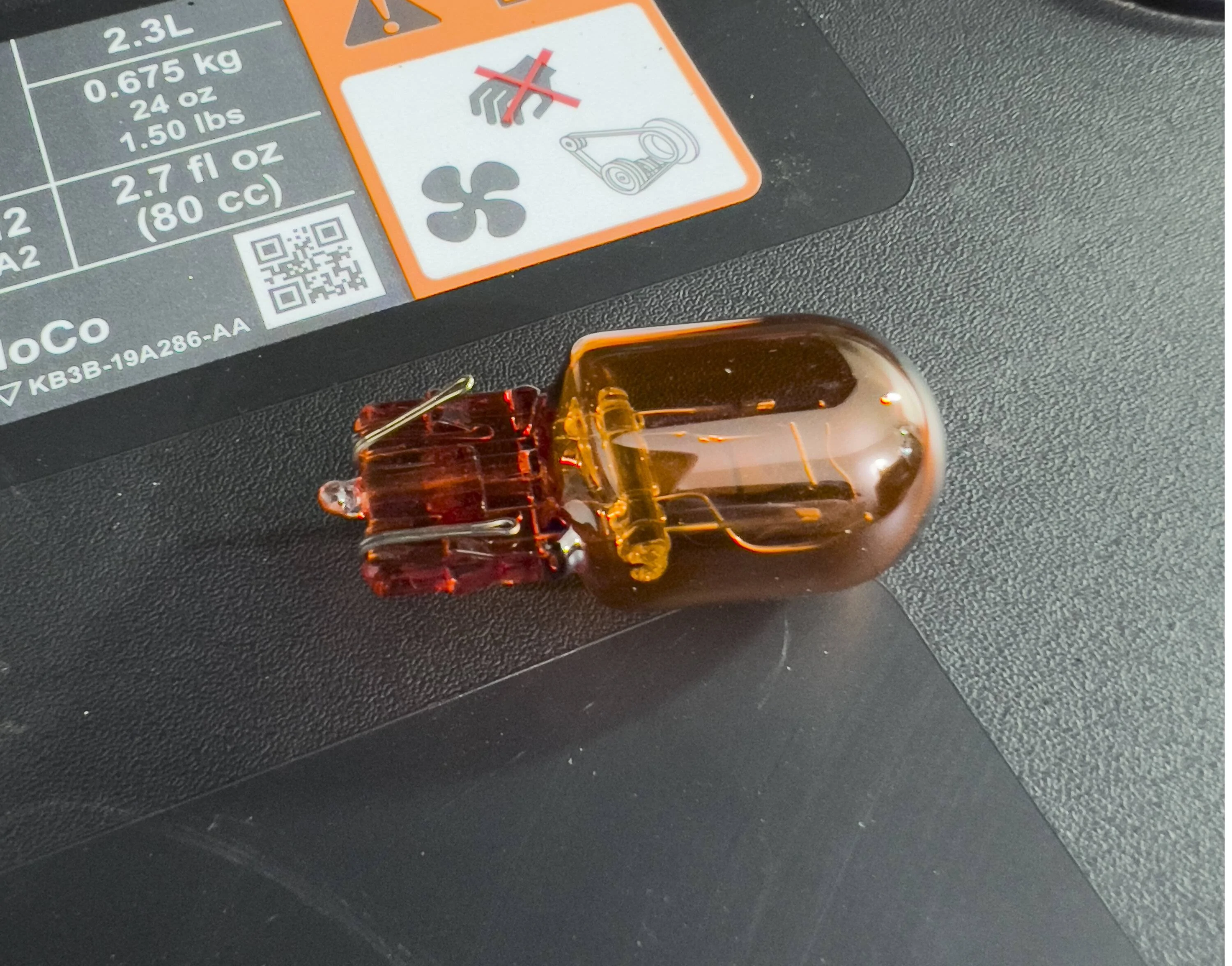

Update on my turn signal not working:
This morning after work I did what Trigganometry and SigOris suggested and found that I was getting a range from about 2 volts to about 18 volts with the blinker on. This was the same voltage range as the left blinker. Plugged the bulb back in and still no right turn signal. I pulled the bulb out and decided to bend the wire on the bulb put a little bit and reinstalled the bulb. Success, the I now have a right turn signal again!
Reading Trigganometry's reply gave me the idea to bend the wire to see if that would make a connection.
I know it's not the proper way to fix it, but I am able to remove and replace the bulb and still have a working turn signal now.
Thank you to everyone for ideas and advice to trouble shoot my issue!
Actually what you did is exactly the right thing to do to fix the problem you were having.
Those type of bulbs can get the contact wires pressed down during manufacturing or packaging so that they don't make good contact with the socket. The only way to fix it is to pry them out a little to give them some spring pressure.
Matter of fact, I usually spend all the contacts out alittle before I put a new bulb in to save me the trouble you had.
