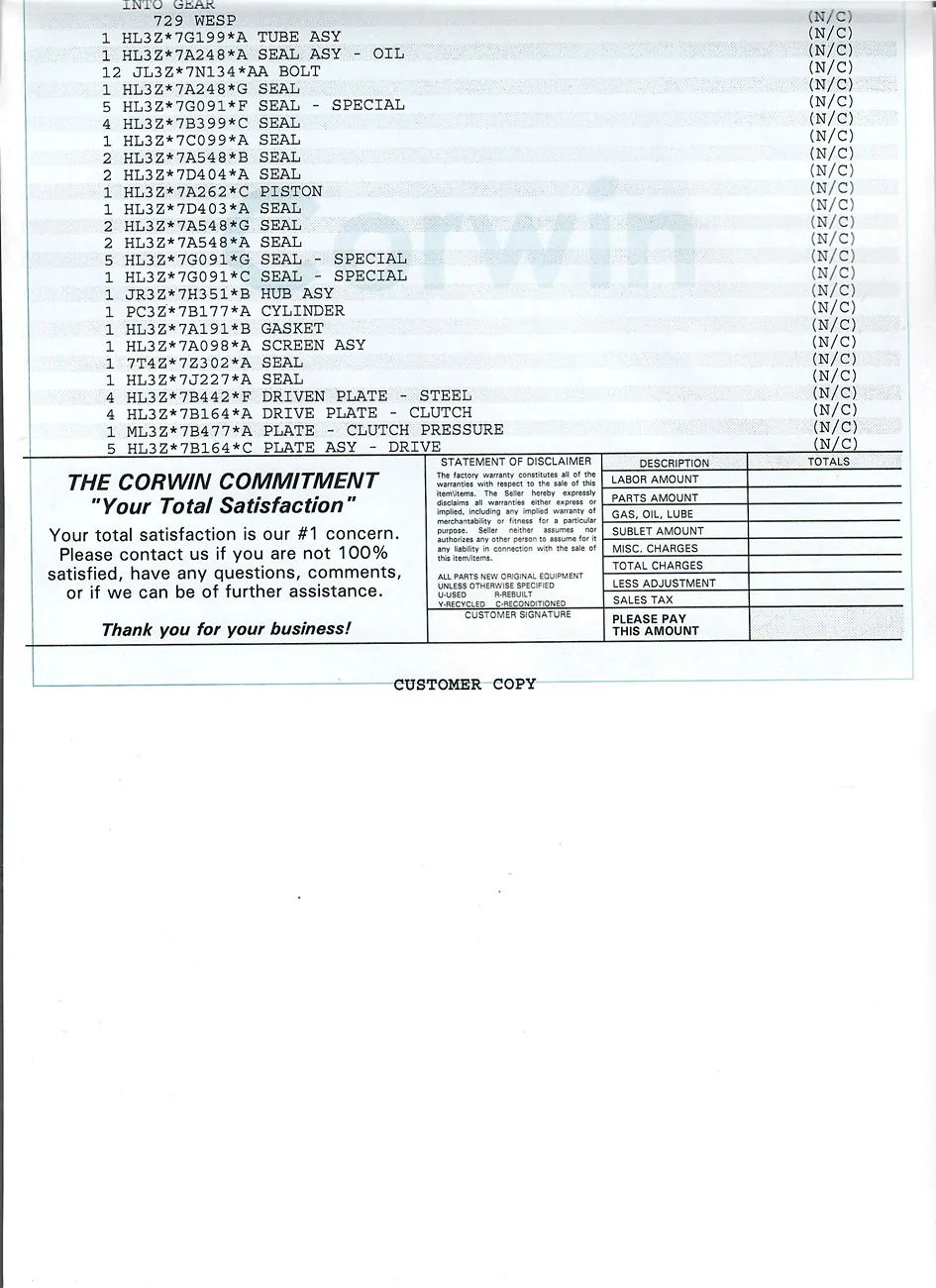

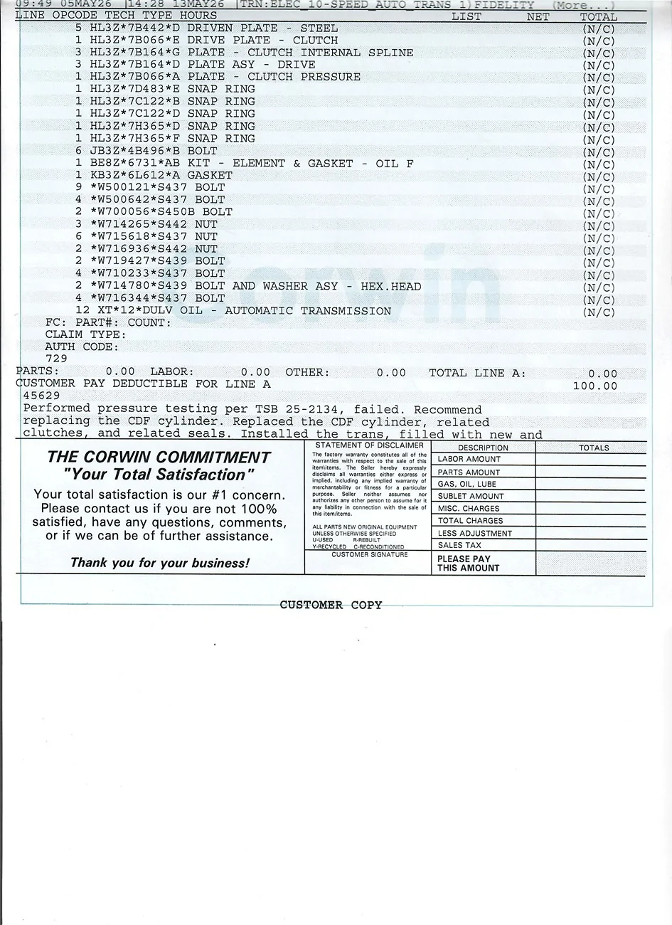

Picked up the truck this morning and the short bit I drove the shifts seem much smoother. Will be interesting to see how it really is going to run after the adaptive learning cycle.
@Stevedbvik1 before you ask here is the part list. And no they didn't replace the valve body.

So I've got to say the shifting is much smoother but did notice that with the new CDF drum different gears are skipped than before.
Still get the occasional skip 2nd but also get an occasional skip 5th. Downshift is still a bit harsh during the relearn cycle.
Reloaded the Livernois tune today so will see how the shifting goes with that
