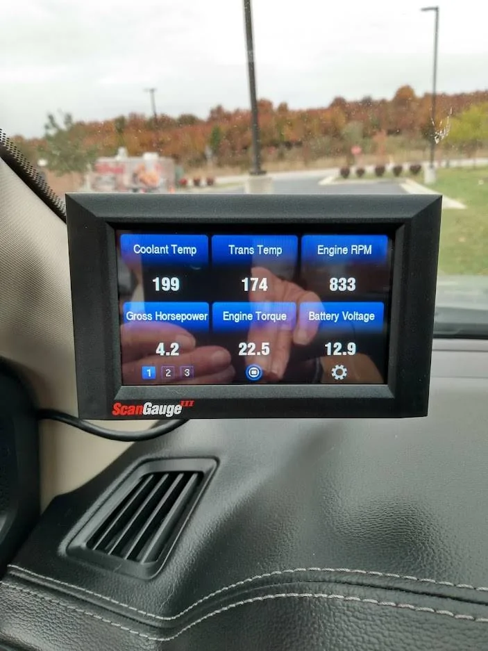

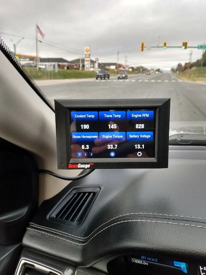

Took these this morning....outside temps were 32 for teh first and 35 for the second.
First was after a 10 mile 15 minute run in traffic from my home to Bojangles for my morning biscuit.
Second was a 10 mile run on the X-Way from Bojangles to Home Depot running 70 mph.
This was on my new Scan Gauge 3 which has the trans temps already loaded into its programming.
Granted, outside temps were low, but you can still get an idea of how ling it takes the trans fluid to warm up.
