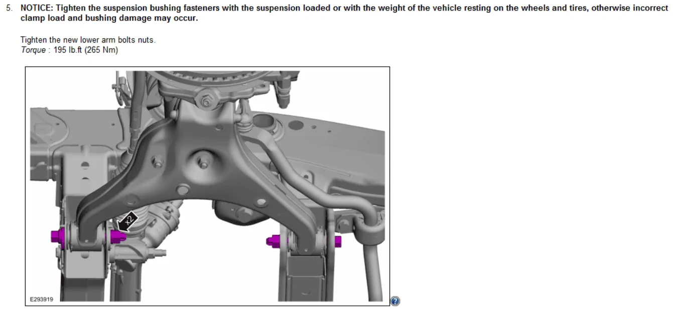

This is from the 2020 Ranger shop manual:

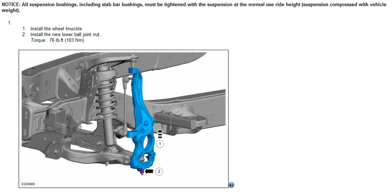

And there's this:
