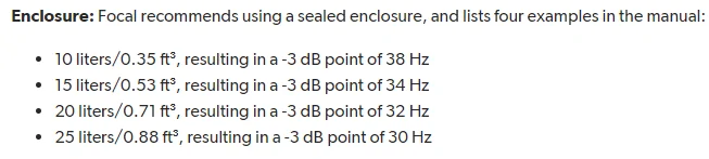

Has anyone bought and used the Aussie sub box? How do you like it? How's the quality? What sub did you put in it? It seems that it's volume is only about .36ft3. Is that correct? Looking on Crutchfield and I only see one 10" sub that recommends a box that small and it's actually .35ft3. It's the Focal Sub 10 slim. Anyone heard of it? Any other recommendations?
Focal Sub 10 slim
Did a little more looking around and found a couple more that would fit in that volume. I assumed that the shallow depth speakers wouldn't need as much space. Need to find out what mounting depth the box has.
JL 10TW1-4
Focal Sub 10 Dual
Focal Sub 10 slim
JL 10TW1-4
Focal Sub 10 Dual

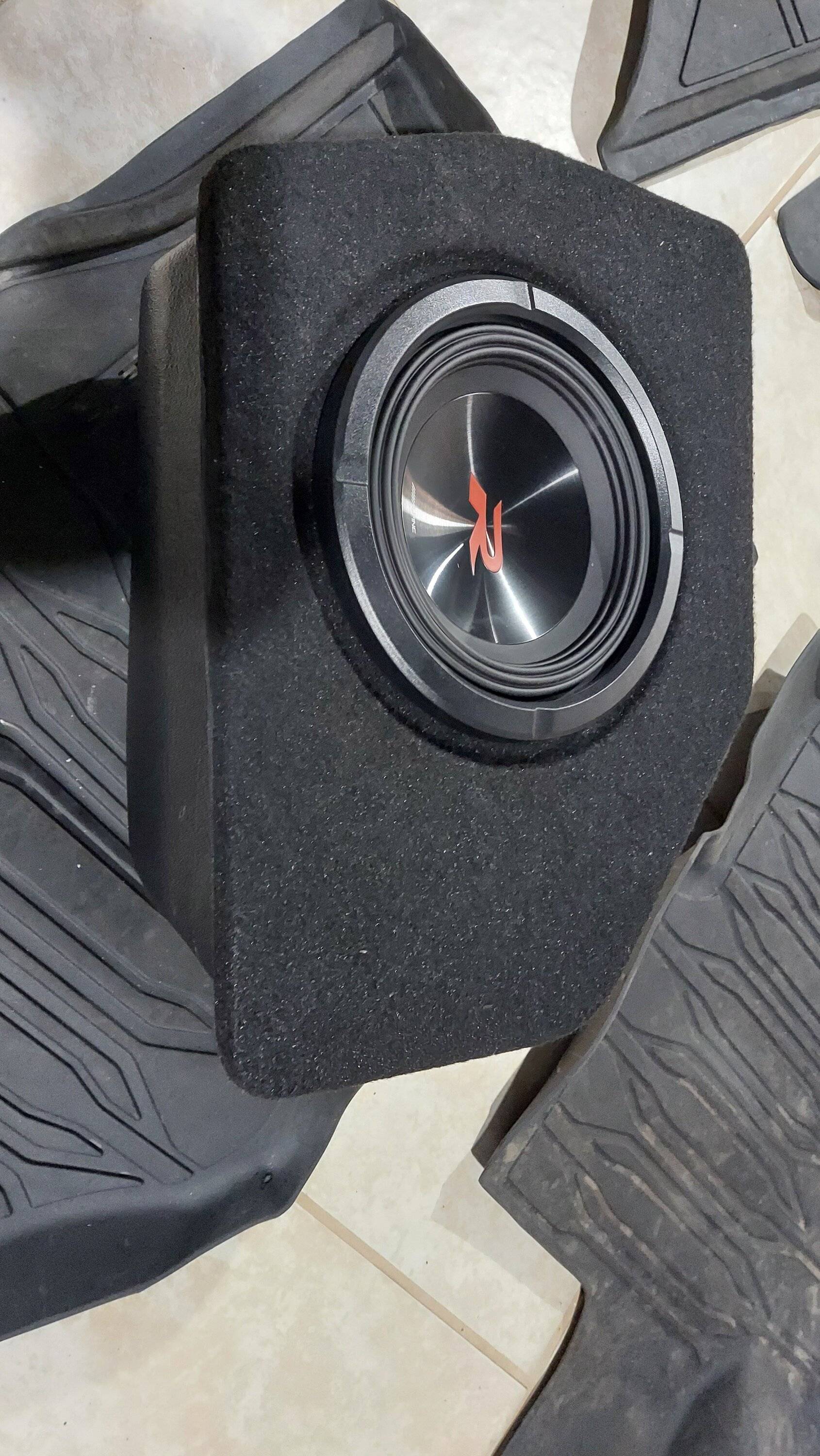

You can go with the 10" box but the AussieBox guy also sells these in an 8" version.
I went with the 8" version because you can get a much beefier sub and you are not stuck getting a shallow mounting depth sub. Many standard depth 8" subs fit in this box.
I went with the Alpine Type-R R2-W82. 350W RMS, 12mm of XMAX works in tiny sealed enclosures (rated for .15-.45 CuFT according to Alpine). It was estimated by the AussieBox vendor that the box volume was somwhere around .4 CuFT.
I am a big fan of the Image Dynamics IDQv4. This could also work in this box with an extension ring as the 5" of dept can hit the slope part of the box. The RMS output though is a bit weak (125W RMS) vs the 12" version (750W RMS).
Other models that could work:
  • CDT QES-820
  • Morel Primo 8
  • Infinity Kappa 800w (these are cheap, around $100 on Amazon)
