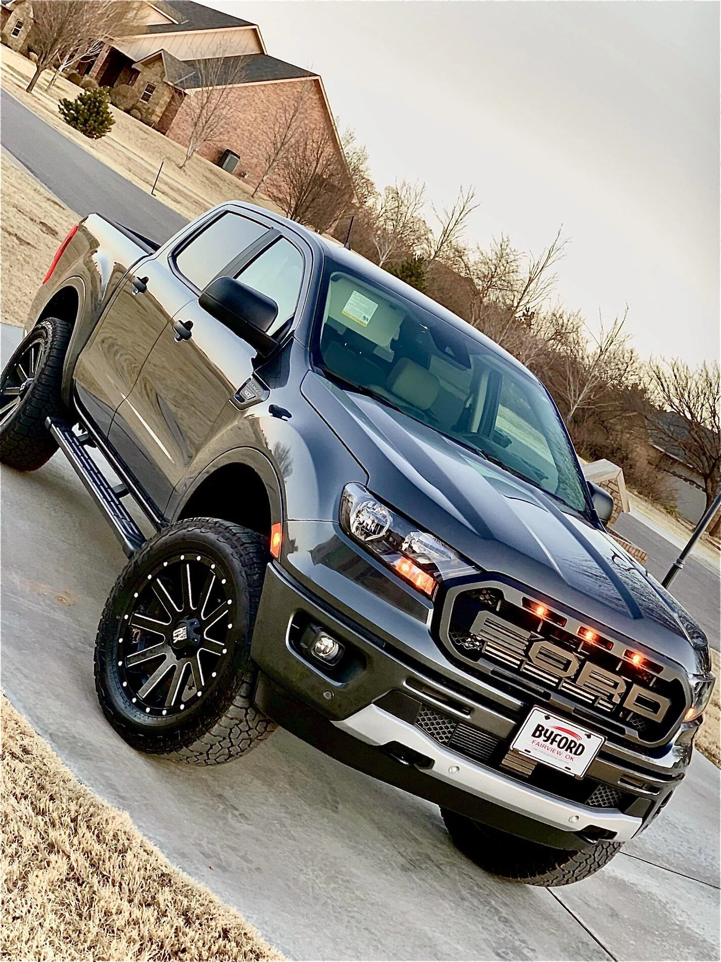

Probably a dumb question- I bought a 2019 Ranger
and immediately changed out the stock tires/wheels with 20” tires.
Do I need to do anything to tell the computer/speedometer that it’s got bigger tires?
Also I’m getting 16mph, we mostly drive on the highway. Seems a little low- does this sound about right?
Photos just because.
I’d drive it myself and give my 3/4T Ford if it had any power at all, it’s a very nice looking truck. Y’all should be be proud of yours- I’ve seen some killer pictures on here.
Thanks gang!

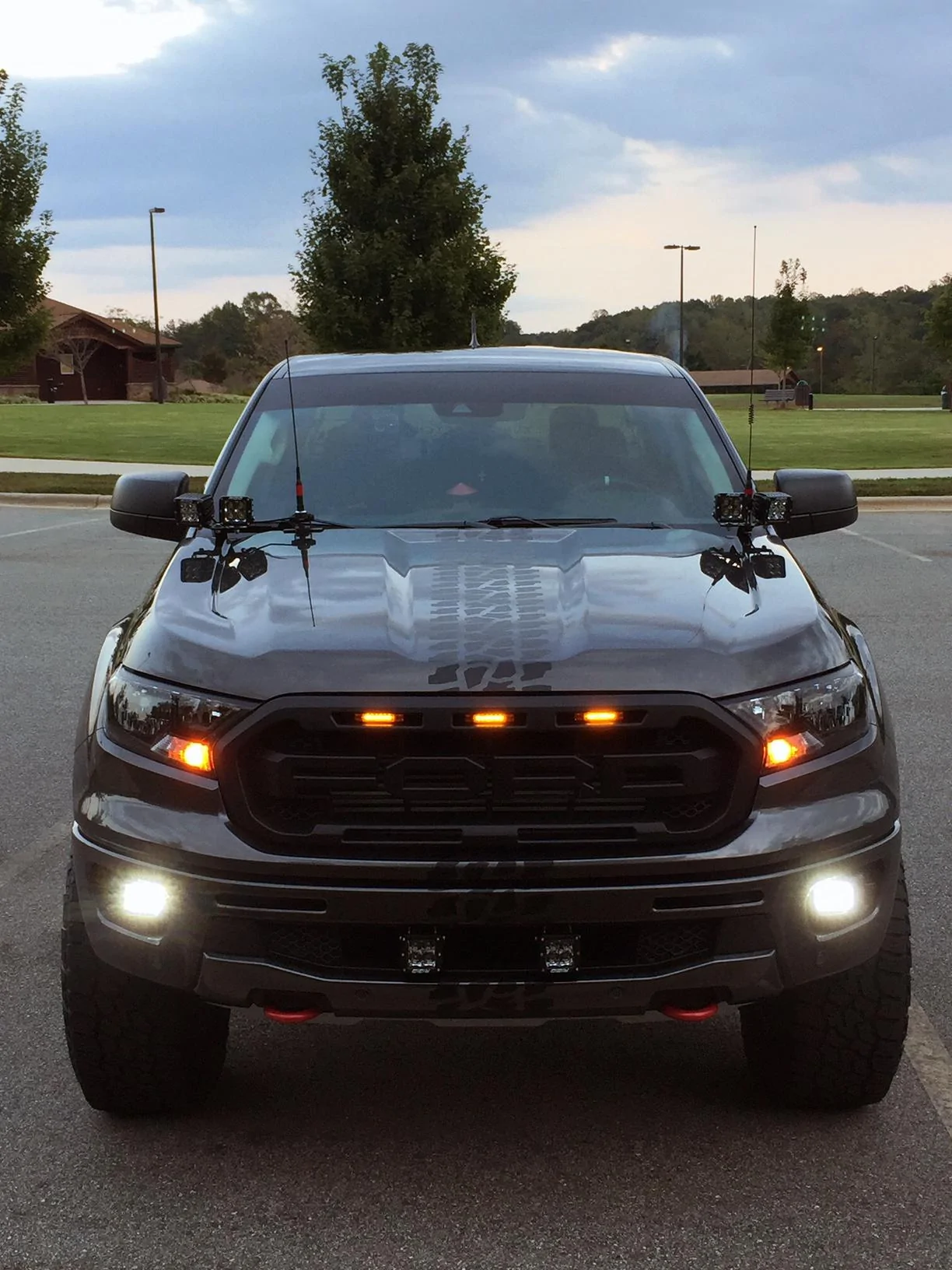

I had a double take then realized the first pic is an older pic of mine lol...I have 285s and adjusted the calibration with Forscan...

LOL- I was riding home from dinner last night with my son driving “his” truck when I wrote this, looked for pics of the truck in my phone and found...I guess yours. I must have done a screenshot of yours when I was picking out stuff, I can’t imagine why else it would be there.
I even mumbled something to him...”I thought I had some good pictures of your truck saved in here somewh...Oh, here’s one. Here’s another...we’re good.”
Nice looking truck, I guess I‘ll just leave it there now that it’s been claimed by its rightful owner.
