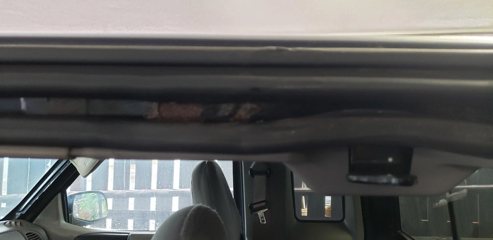

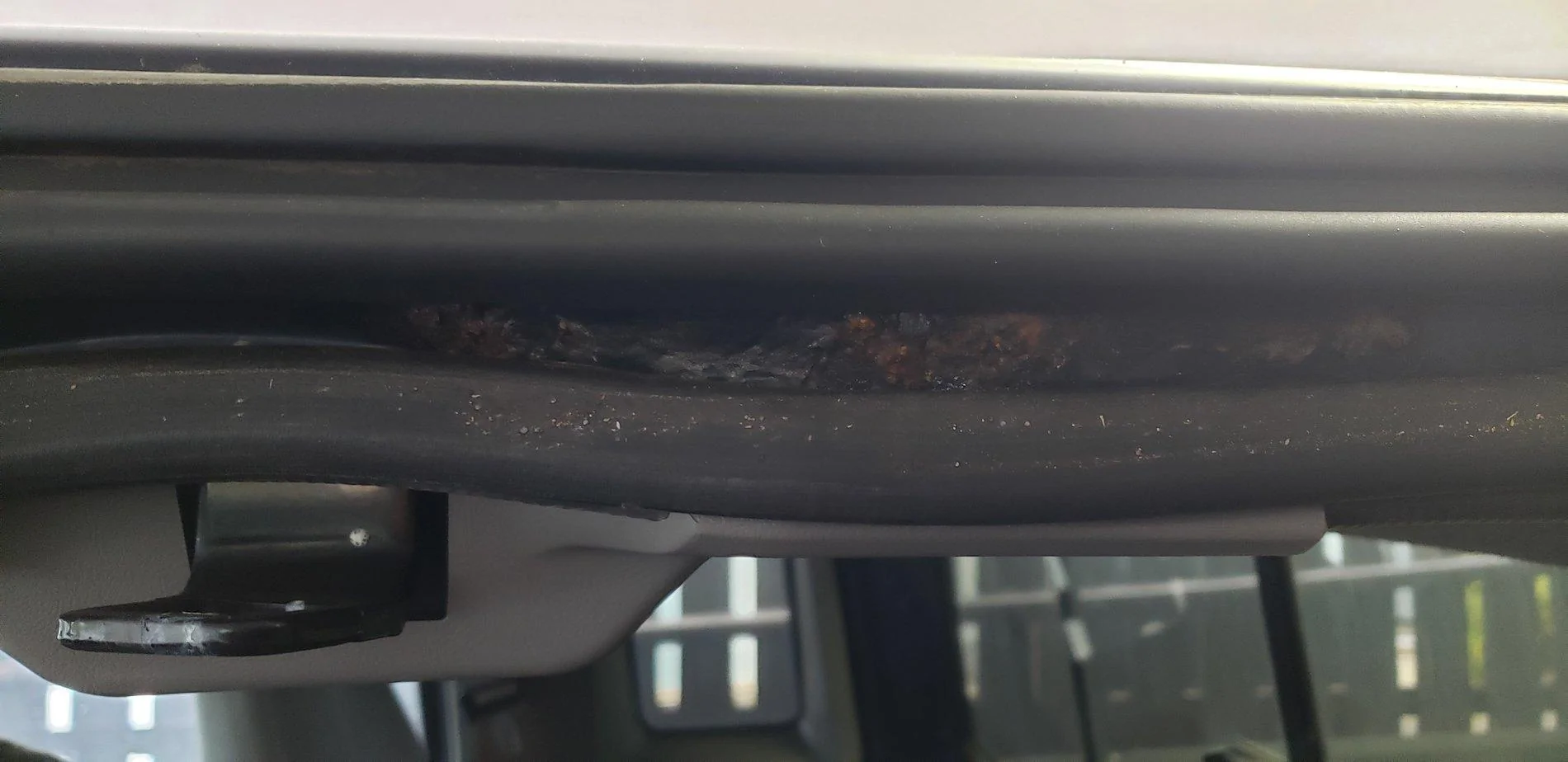

My 2000 SuperCab has rust issues on the roof panel just behind both doors on both the left and right side door openings. I've seen other SuperCabs with the exact same problem, has any other 3rd gen owners experienced the same issue?
My '91 extended cab had no such problem, but that roof structure was entirely different, it had proper rain gutters.
There were other Ford's in the family stable, all of them 1st gen. Panther bodies which experienced rust in the same area and were clearly visible, on my 2000 the rot is only visible with the doors open. A body and fender buddy of mine explained that the roof and side panels were spot welded together and unsealed, allowing moisture to get in there and be trapped on the Panther series.
I sure hope Ford recognized and remedied this problem with the 5G body structure, perhaps Mr. Schilke can elaborate?

My '99 SuperCab was a rust bucket after 220k miles/15 years in the Great Lakes Rustbelt. The Bottom of the Doors and seams were pretty much trash. Same with the door sills, near where the two doors meet. Looks like there has been years of moisture build up in the lower weather strip on the picture. Moisture found a way to wick into the seam and started to do what it does best unfortunately.... rotting from the inside out.
In my experience, rust repair on a 20 year old vehicle it to be expected. Once again, In my experience.... It may differ in your area and I'm not trying to say your expectations are unreasonable.
