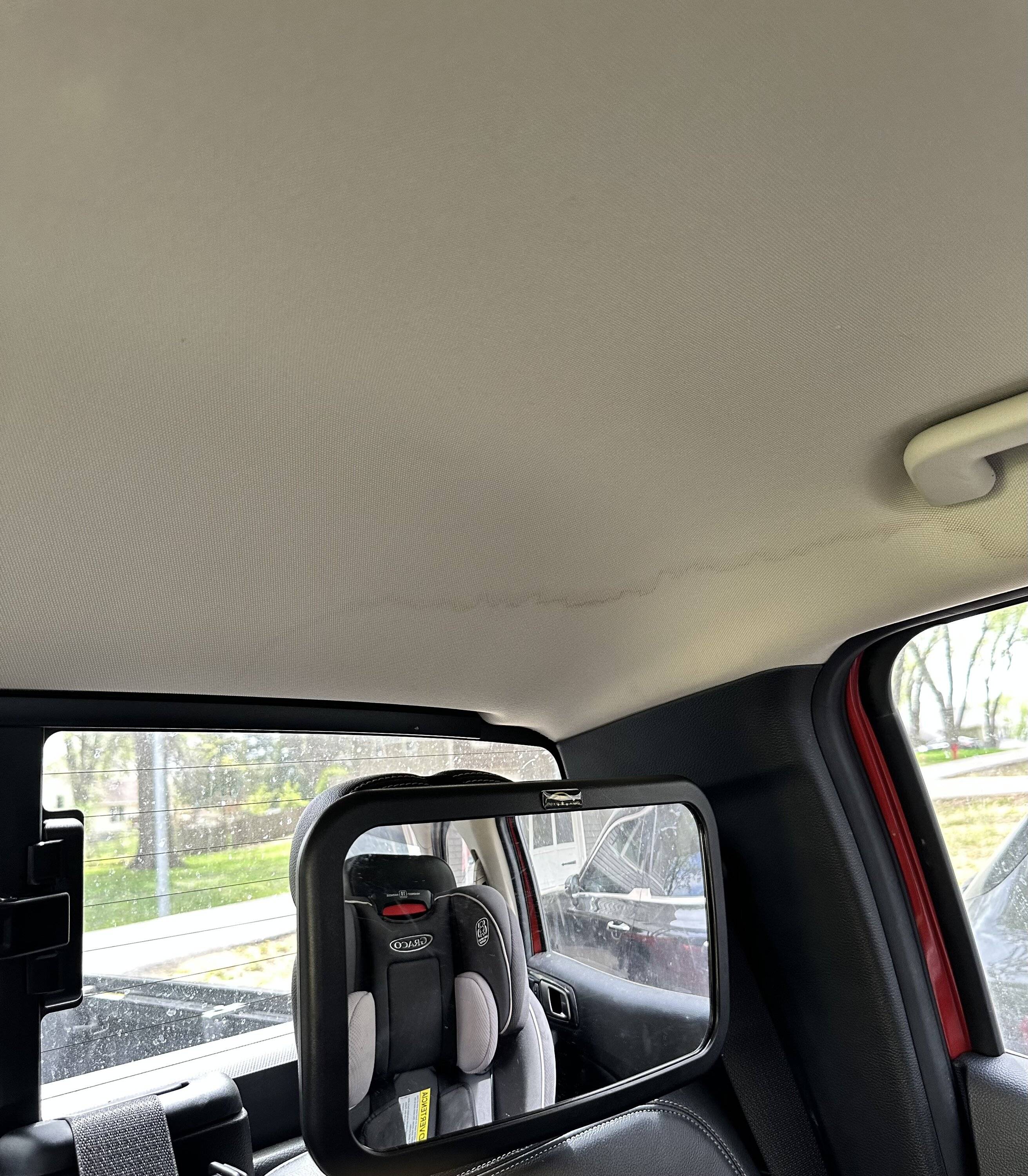

Hey everyone!
From this leak seen in the photo, would you say it’s time for a new seal on my third brake light? Orrrr?

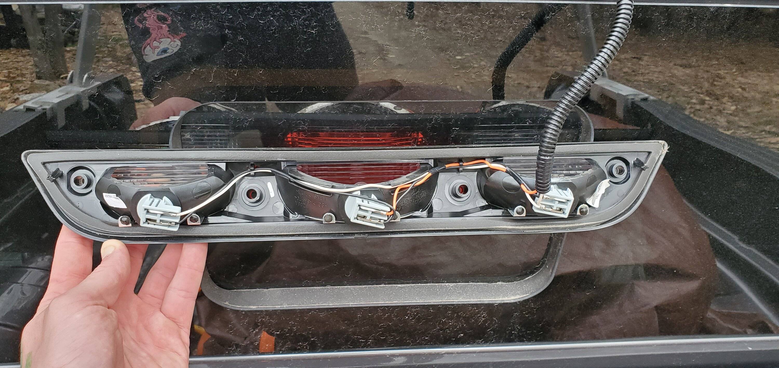

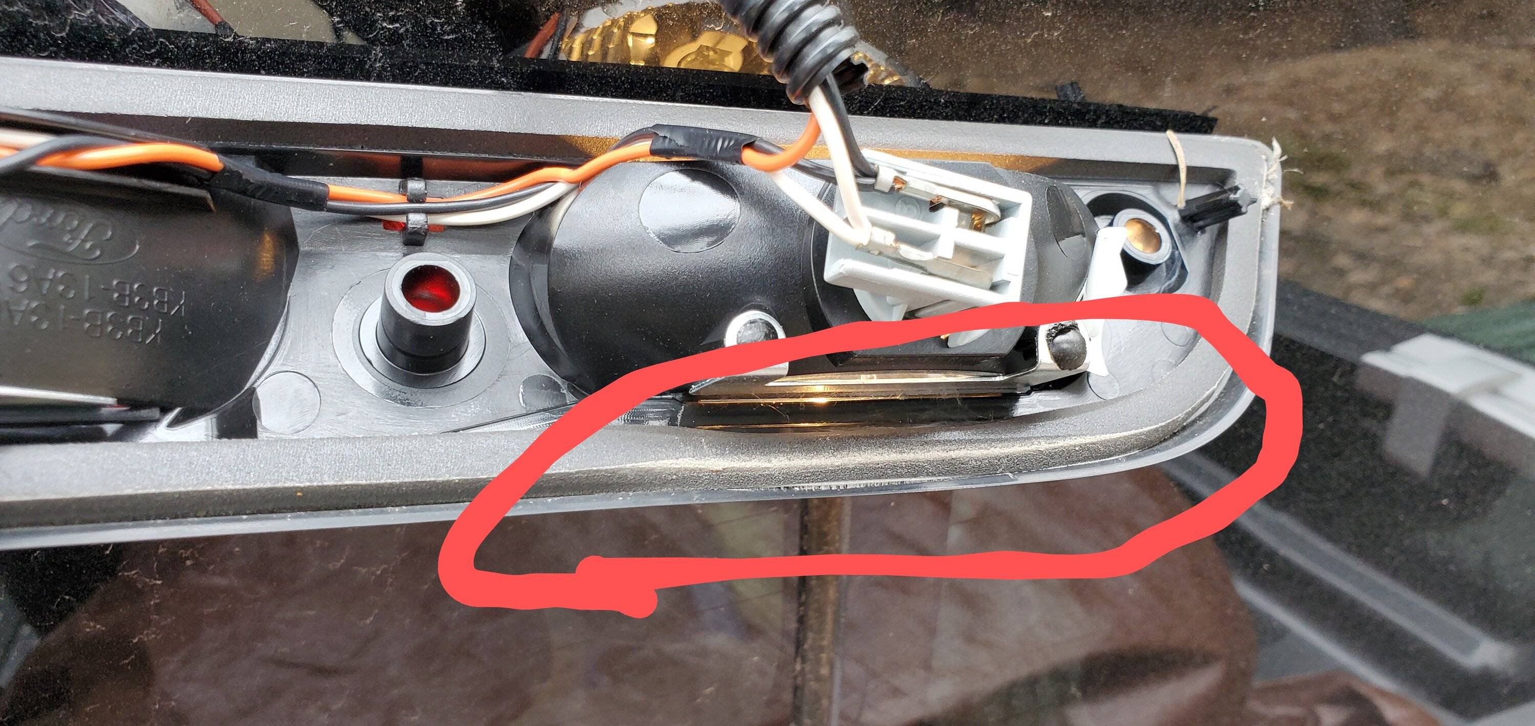

The seal on the light likely isn't stuck on "square" with the housing all the way around it. Just dealt with mine yesterday.

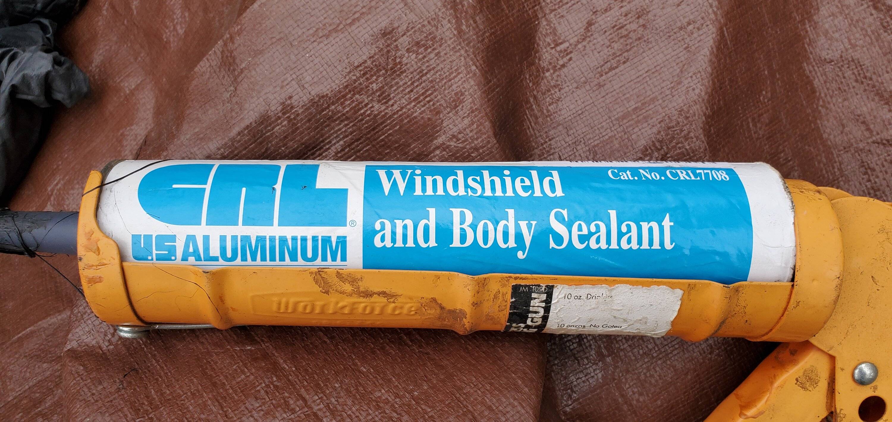

Mine starting leaking.. OF COURSE.. at 37k mIles, I have no willingness to do that dance with the goddamn dealer at the moment so I just gobbed some of ^^ this all around the mating surface of the seal and slapped it back on. MF'ers days of leaking are long gone now.
