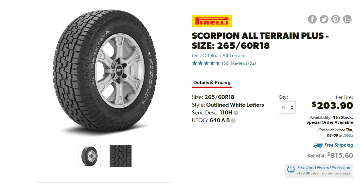

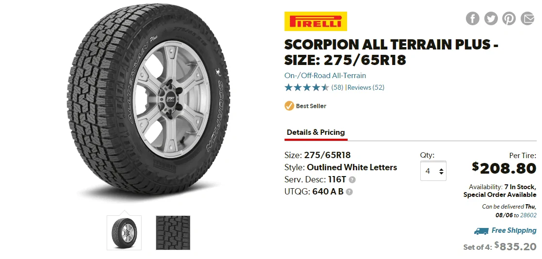

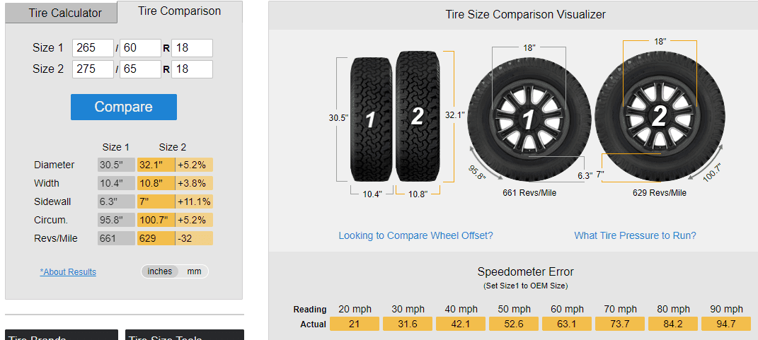

Just thought I'd get some extra points of view. I have a 2WD and 2.5" leveling kit. I don't think mine came with the crash bars either; unless I was looking in the wrong place. These have really good reviews, but please feel free to chime in about the different sizes and if you have any experience with them. Thank you all!

I also took a long, hard look at these tires before deciding on Falken Wildpeaks, which will get installed on Friday. The Pirelli Scorpion All-Terrain Plus are well-rated and highly regarded. I have not run this particular model, but I did have Pirelli Scorpion Verde (an all-season variety) on my 2014 Ford Explorer and loved them. Great road feel and all-around performance. You can't go wrong with Pirelli.

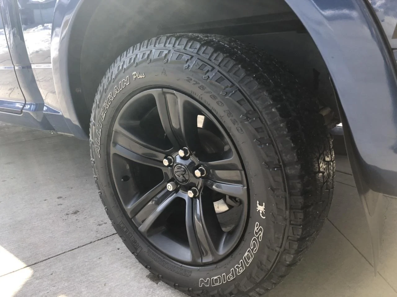

I know this isn’t completely valid review but I had installed these on my last truck, a Ram 1500 4wd. I bought them mainly because they had the 3 peak snow/winter rating. Overall quite impressed. They were quiet, very good in the rain/wet roads, decent on ice considering they weren’t a dedicated winter tire. They balanced out easily and wore even.

I honestly dont know much about the Pirelli tires but I have heard both good and bad and that goes for any tire out there. As for size I woyld suggest going to a 265/65-18 instead of a 275/65-18. I suggest that so you have less chances of rubbing. I myself went with 265/70-17's on my truck. As for what tire to go with I say go with what you prefer. For a 2wd I personally suggest a street tire of sorts but to each thier own.
