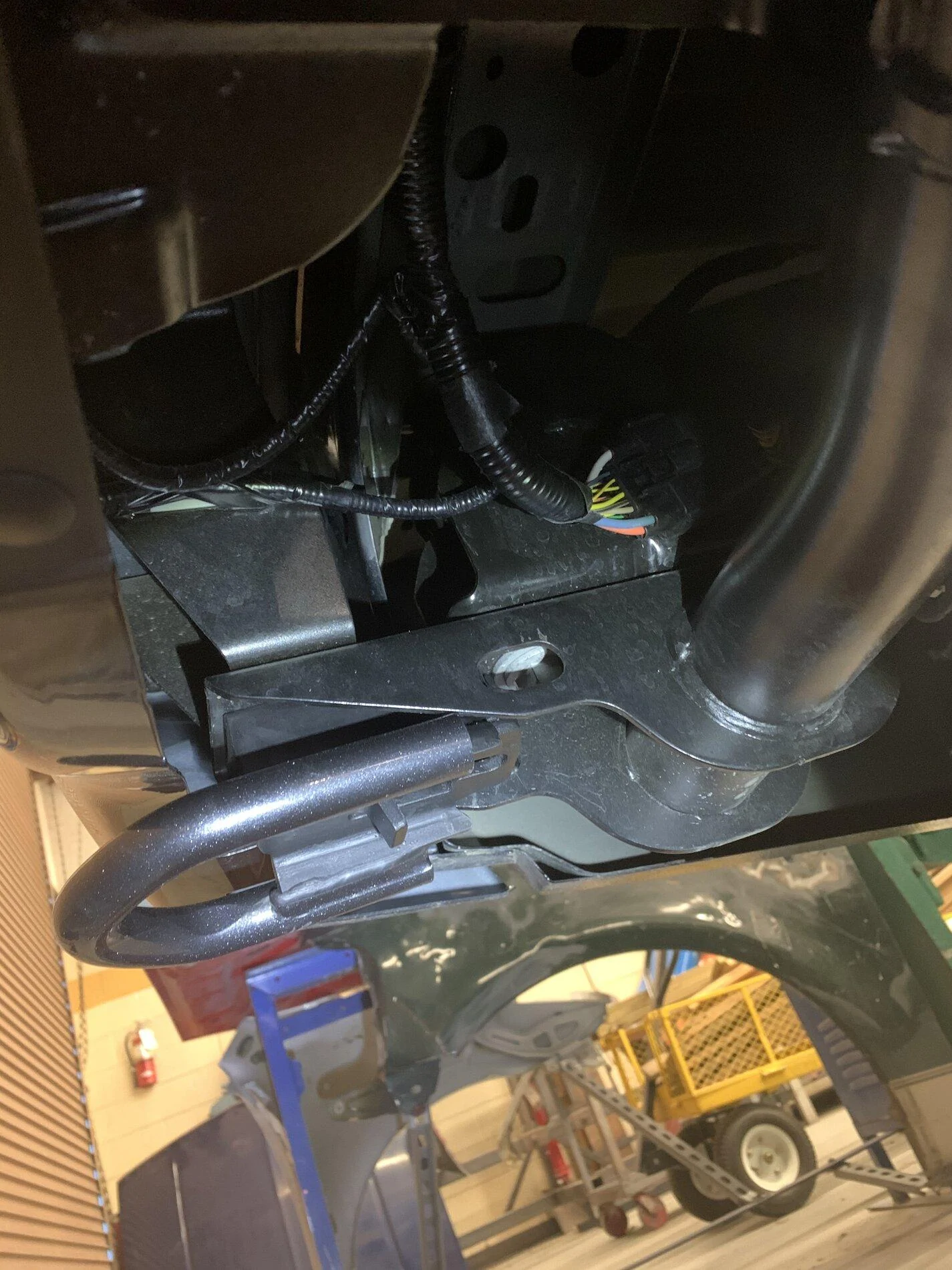

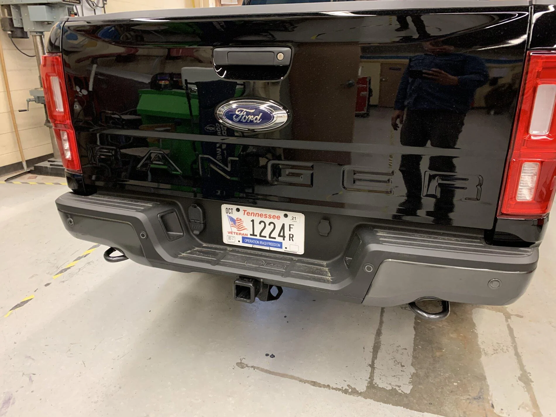

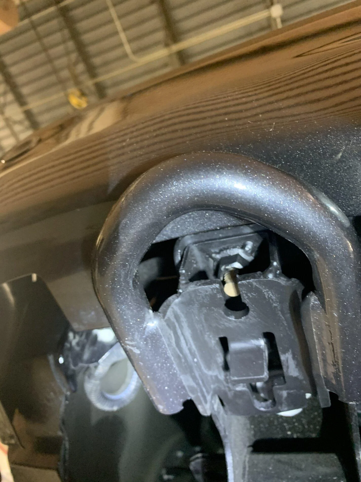

Got some shackle mount blanks and made me some..well..shackle mounts
. I recessed them just a bit more than the RC ones I’ve seen. Then I moved the hoops to the rear so now I’m 1/10th the way to having a Tremor!!
That's pretty cool. I'd be interested in seeing how the rear hoops are mounted underneath if you have a minute.
Sure no problem. I forgot to take a picture of the finished product before I bolted it in but I used a piece of 2 in.² tubing cut at 4 inches long and then ripped it in half, used 1/2 on one side and 1/2 on the other. Welded the nuts on the inside of the box before I welded the box on to what was left of the front hoops (I have an FX4 so I had the skid plate mounting tabs that I had to cut off and use on the front). It’s bolted to the trailer hitch and the bolts come in from the top. Of course I had to paint them Magnetic.
Oh okay, that makes sense. Very cool. I like repurposed fab work like that. I may look into it in the future. Thanks for your time!
