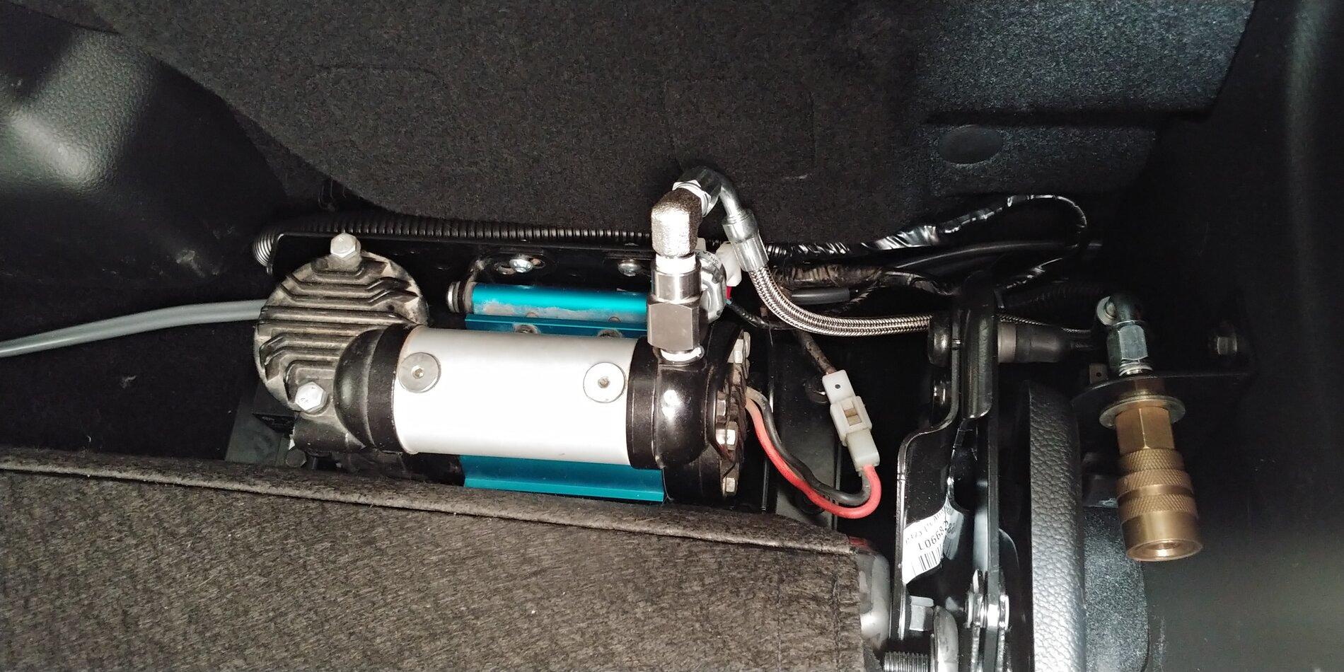

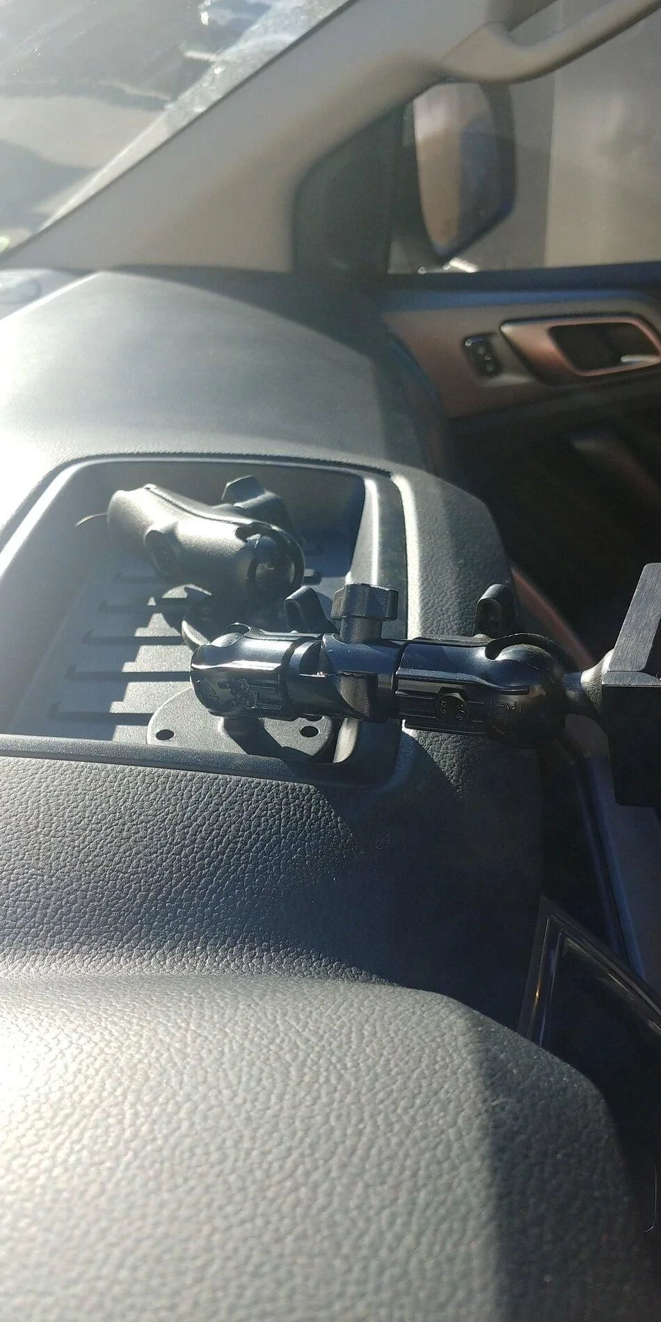

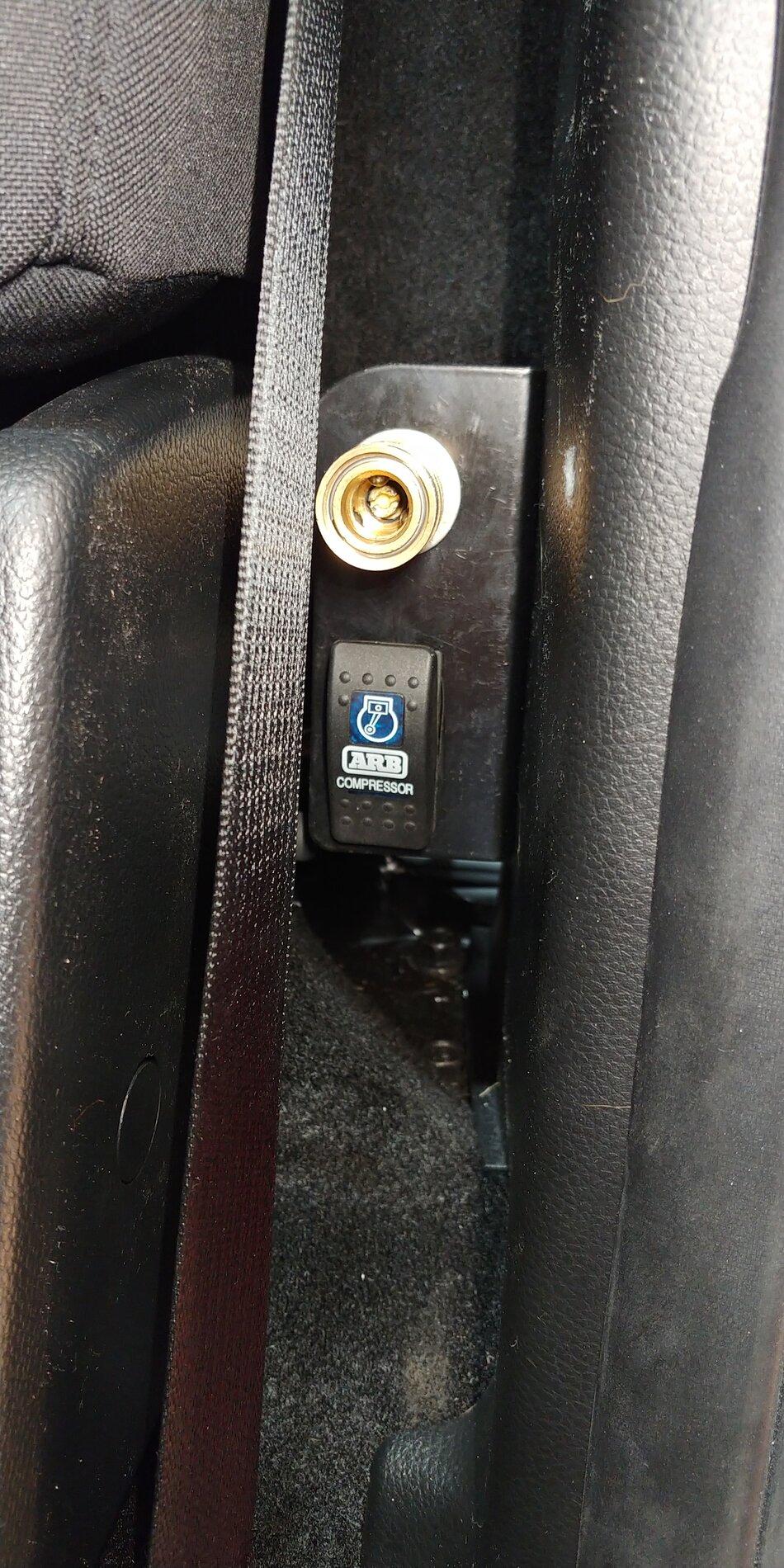

Got my ARB Single installed today and wiring for my fridge.
I also through a couple of ram balls in the dish cubby and a Tackform phone holder.

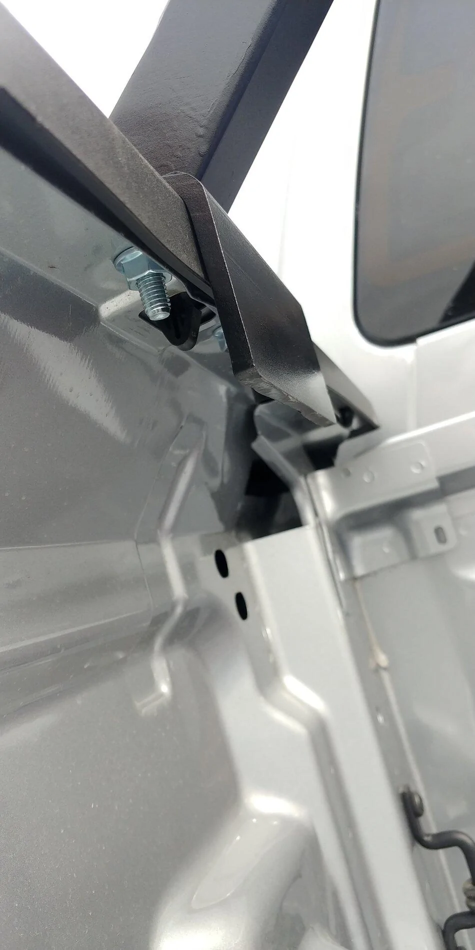

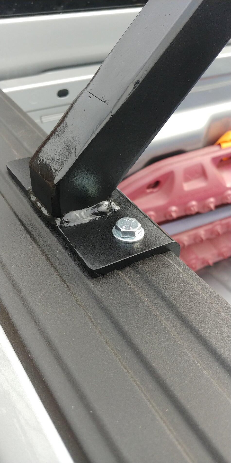

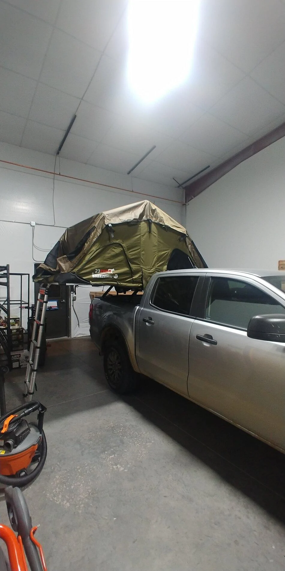

I will grab some photos tomorrow in the light, but I basically made some 2.5 angle iron (cut a square tube in half) and drilled through the top of the bed into the flat channel inside and out a bolt/but combo to hold it.

Thanks for the info! I'm terribly gunshy about drilling into the truck :oops: but I think that is probably the best way to go.

It is a bit hard to drill that first hole, but I know If I ever want to hid them, I can buy new plastic bed caps and no one would ever know.
I just drilled through were it was flat on the bottom and used M8 bolts and wiz nuts for now, that will be switched over to nylocks this weekend, I have a feeling Moab will rattle the wiz nuts loose.
It was pretty easy, but they can't be tightened down without crushing the plastic ribs on the bedsides so be a bit careful.

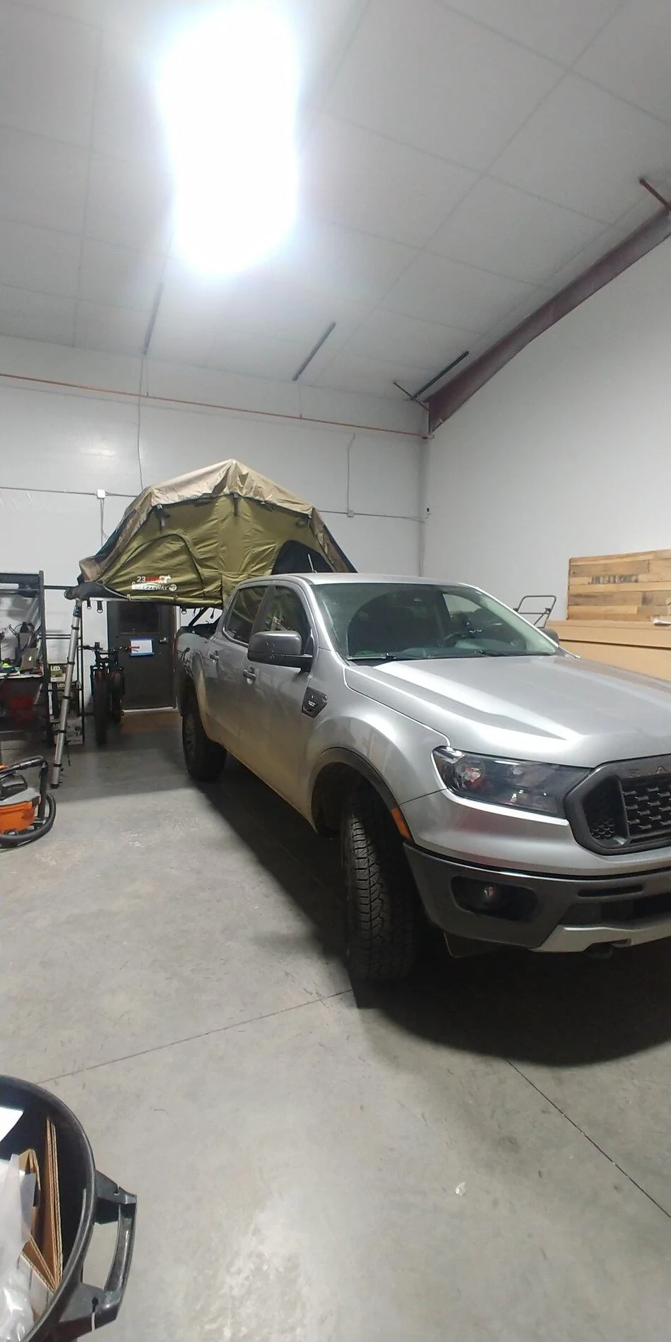

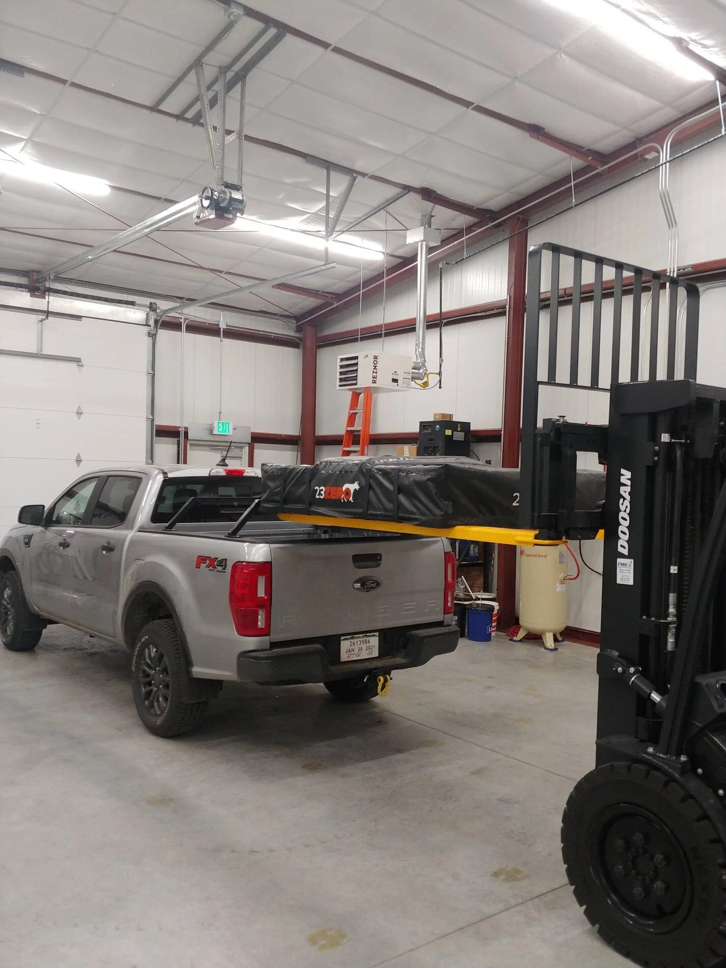

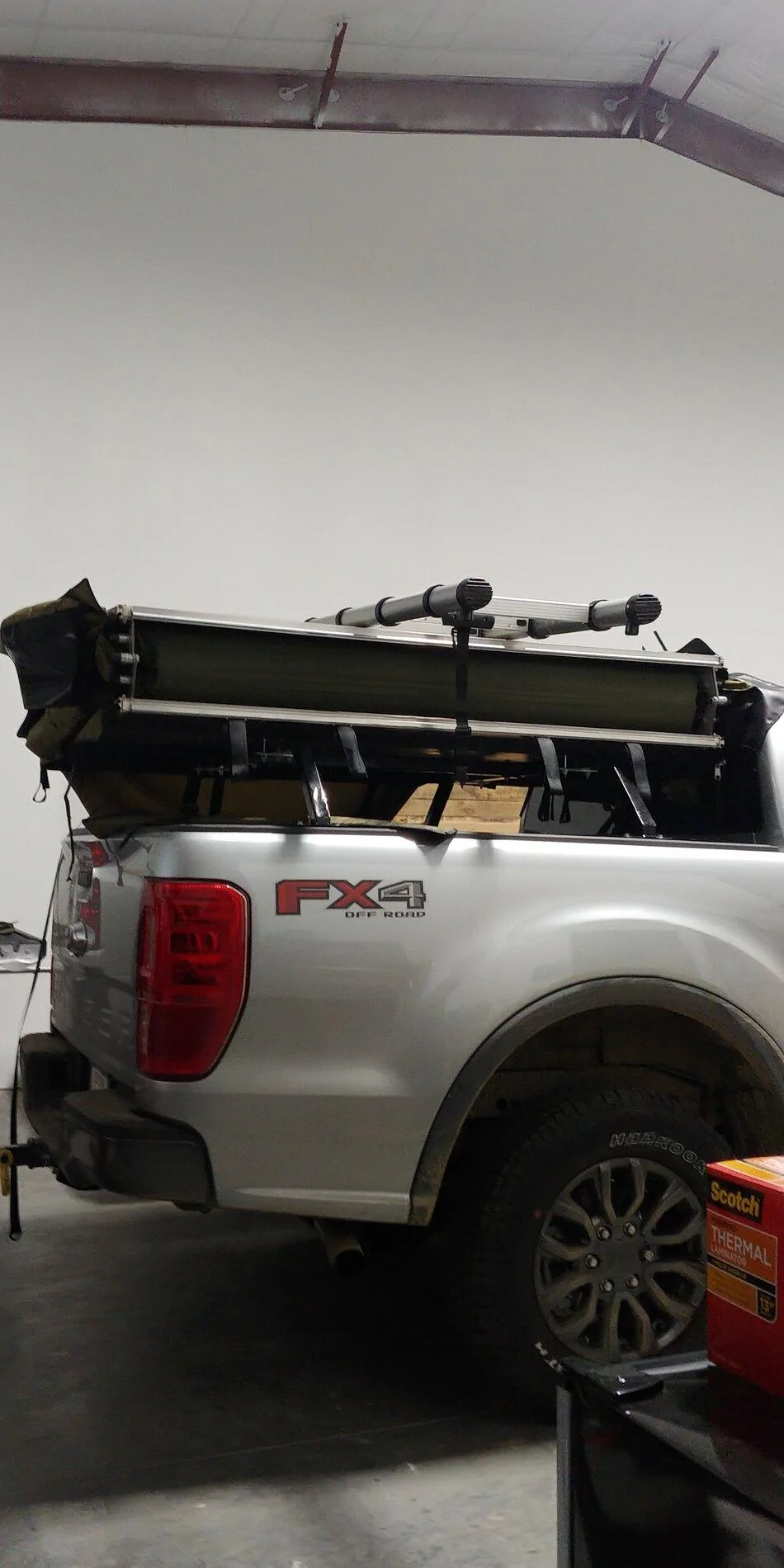

And the RTT is one! not the exact one I would by but since I am borrowing it from work I can't exactly complain. Its a 23Zero Breezeway 62. (I would just get the 56 version for a smaller footprint)
Got it mounted up on the rack, ready for Moab. Now just to pack my boxes and head out on the Rangers first big adventure!

Thanks for the pics and encouragement!

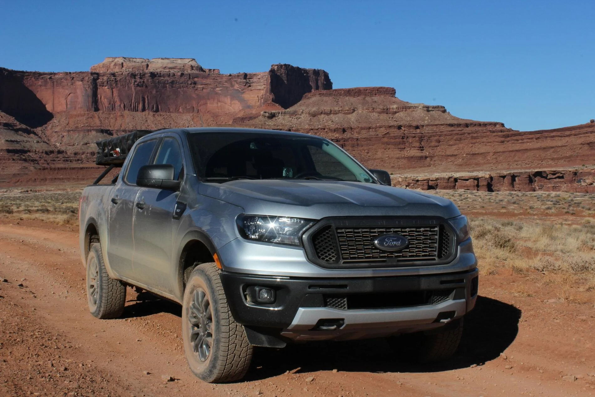

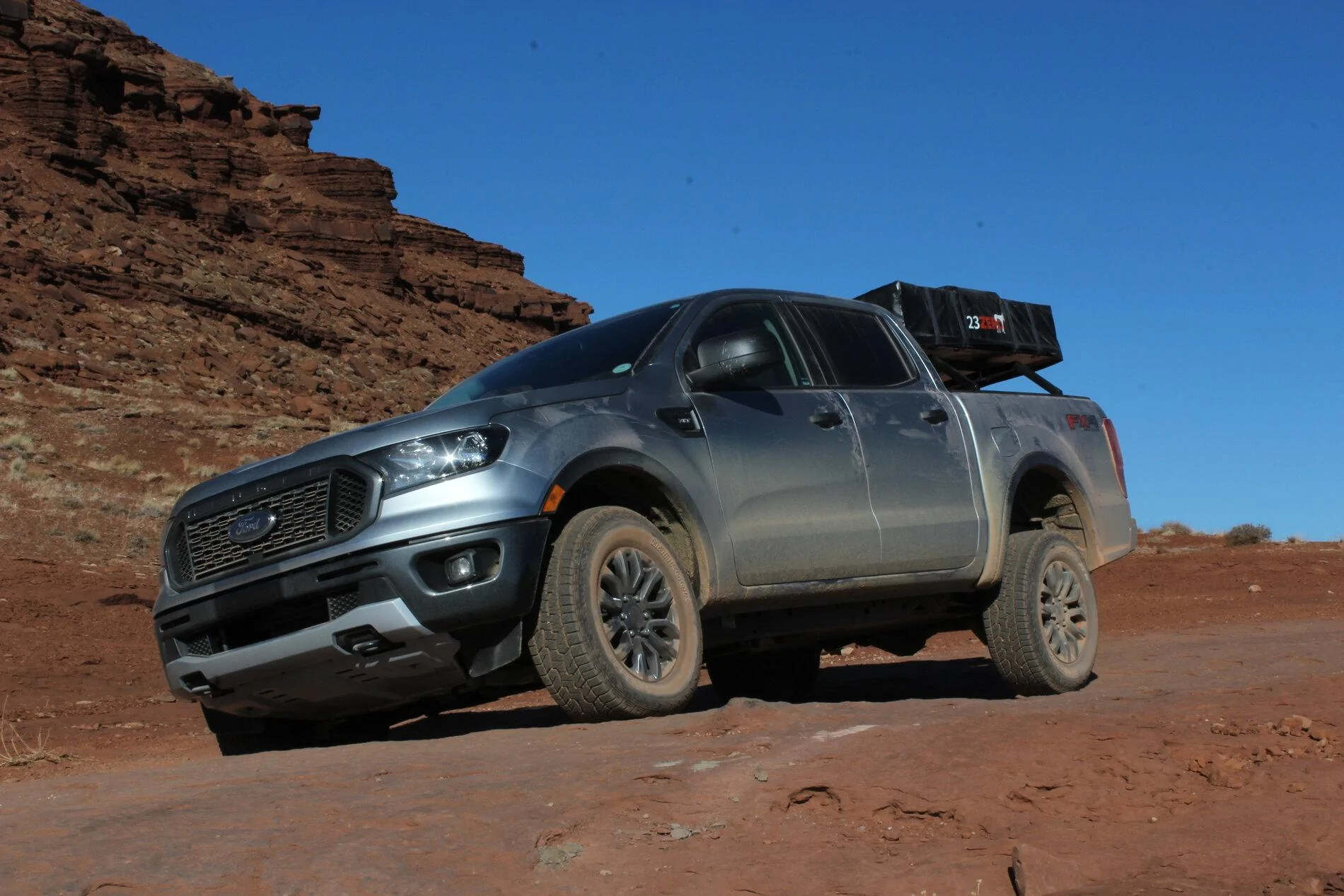

A couple teaser pictures from the Moab trip in the Ranger. Also I am at just over 1800 miles after that trip.
