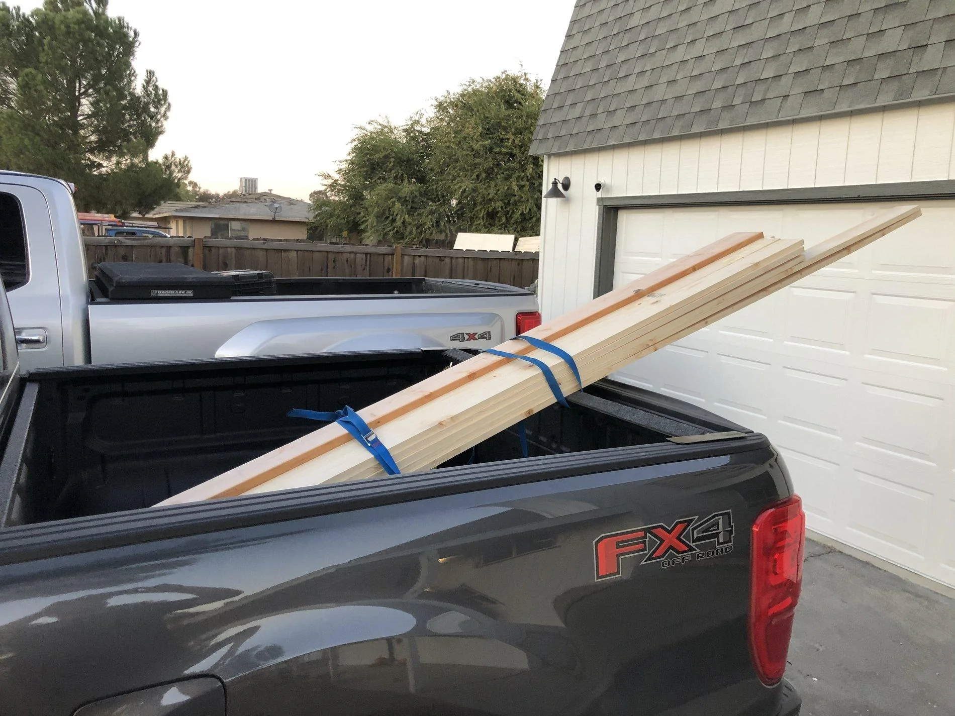

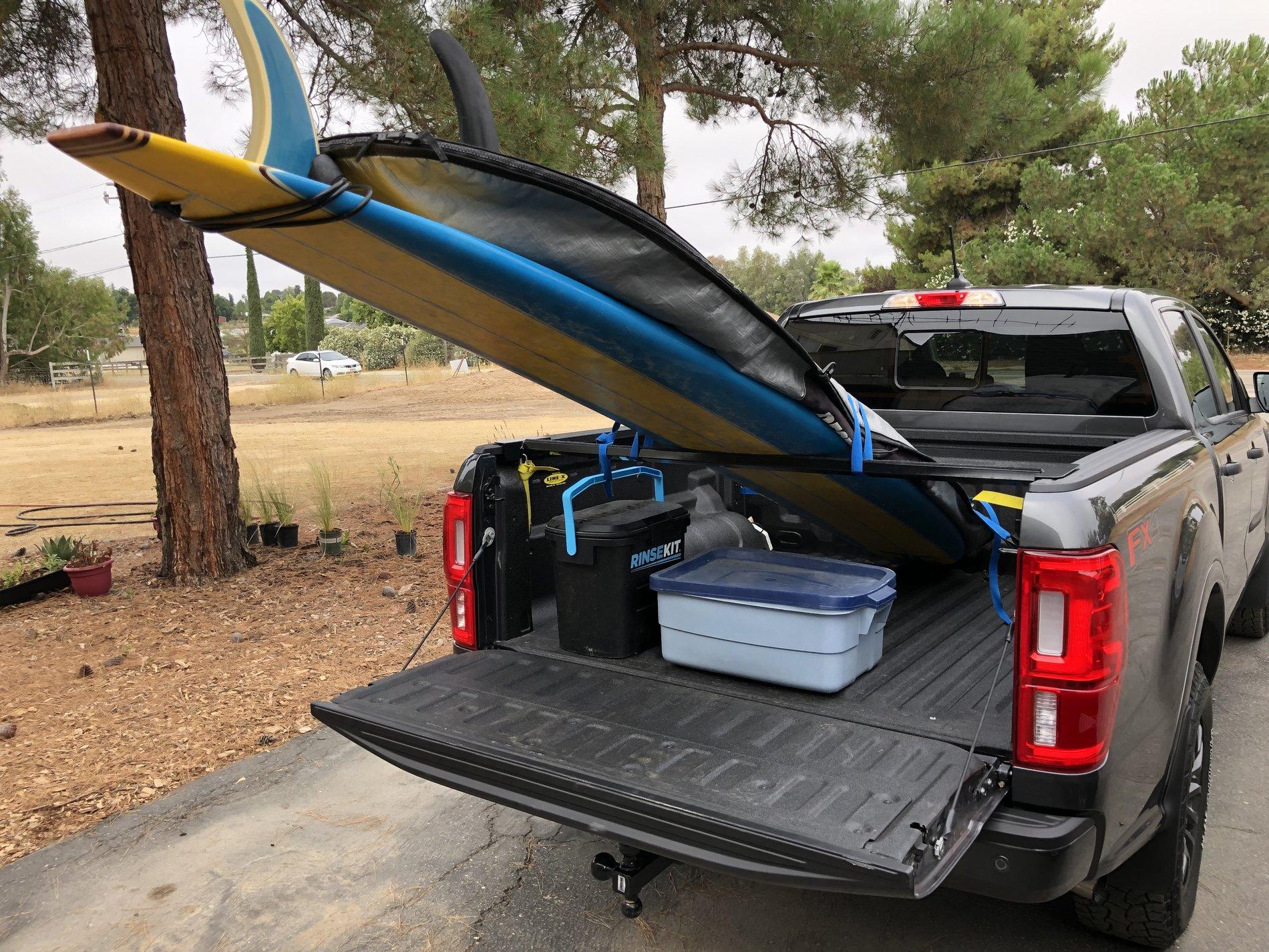

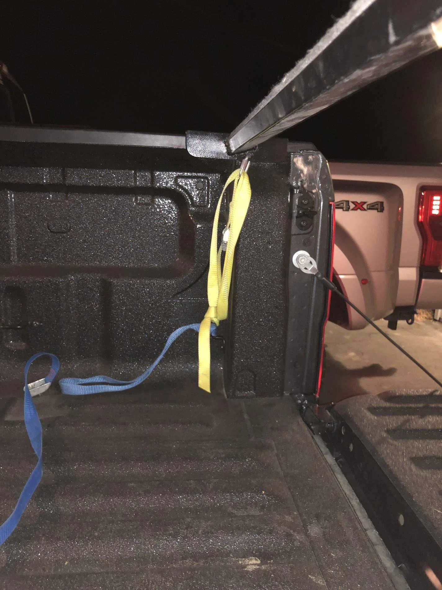

This is my placeholder rack until I build a rack, however for light duty carrying jobs up to 10 ish feet in length it’s awesome. Being able to open the tailgate and keep the lip from getting chewed up is a big plus. Angle iron on the bed rails, 1 x 2 rect tube across, straps into the rear tie downs. For reference the long boards are 9’ and 10’, lumber is 8’ and 10.’

Yep, it’s a pretty easy one to fab. Added some 1/4” foam tape where the angle fits on/over the bed rail so it doesn’t scratch/slide/rattle. @PNW_Ranger87
