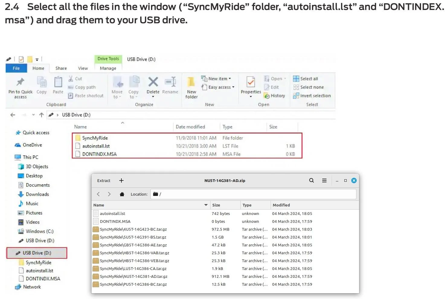

This thread motivated me to update Sync.
I am moving from SYNC Version 3.4.19274
So I downloaded the zip file and viewed the contents. Instructions say to move the 3 files (It actually 2 files and a folder (sub directory)) to a ExFat formatted USB drive.
Simple enough to do, right.
Only when I viewed the zip file contents I found the 2 files and 8 Tar compressed files!
I hate it when instructions are not accurate. So being an I/T person, I am confident that Ford has updated the installation code. But I do not trust Ford enough to put those files on a USB drive and attempt to install on my truck without an explanation. 2 of those TAR files are almost 1GB in size, so there are clearly different Sync flavors / versions in this zip file.
Is the install process sophisticated enough to figure out what to install? I obviously don't trust Ford, so I will ask here. Questions follow
1 - Has anyone installed this version of the sync update and did you see this many files in your installation?
2 - What was the install process that you used?
3 - My Sync version has not given me any issues, and I'd rather not introduce any. Will I lose any features with this update or is it simply bug fixes?
Here is what I see in the zip file and the PDF instructions displaying what I should be seeing. The zip file contents are in the window below the red box.
Thanks for the assist.
