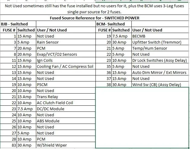

I had been wanting to put together a quick ref guide for this.
I have noted all fuse sources for switched power that I can note from the wiring diagrams
I would verify with a meter or test light to ensure the power drops immediately or does it stay powered briefly, it all depends on what you want to power (relay wise)
