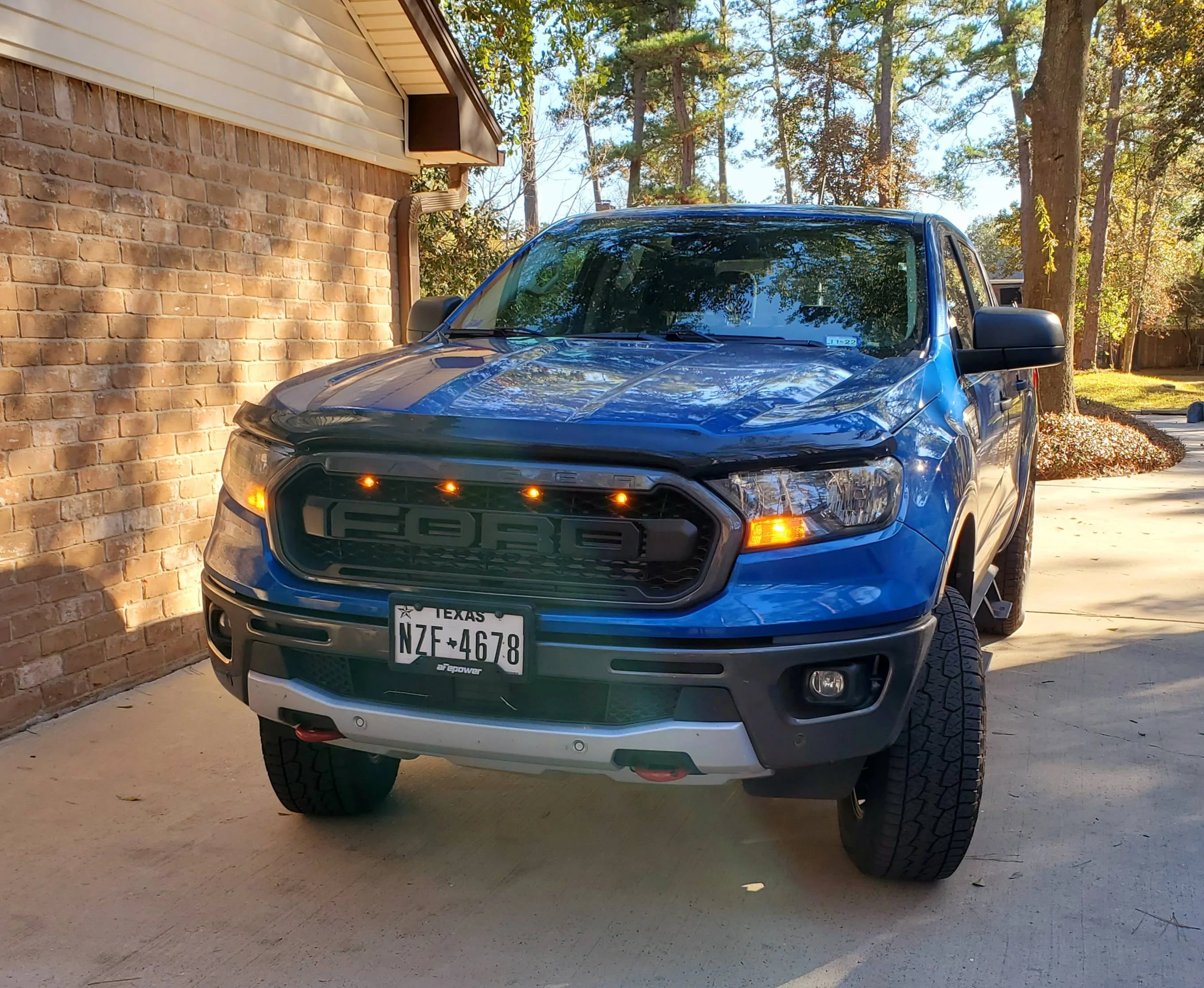

Turn signals are amber. Parking lamps are white when headlights are on. Parking lamps are white when Parking lights on. Parking lamps are amber when drls are on. Just what I wanted!

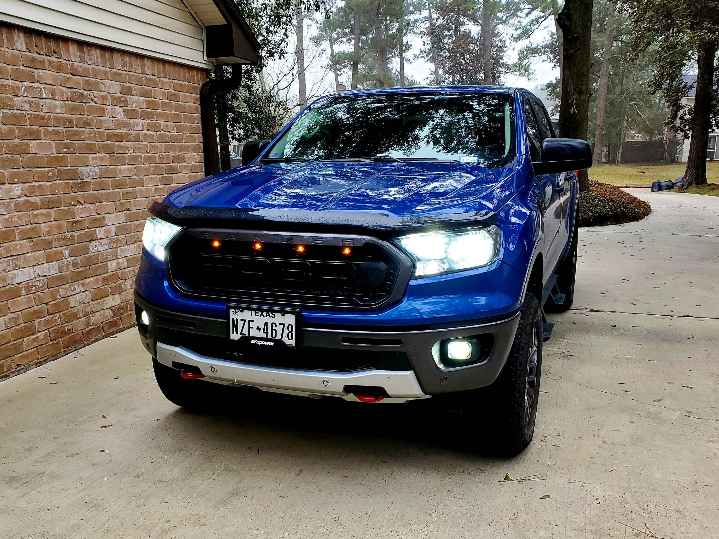

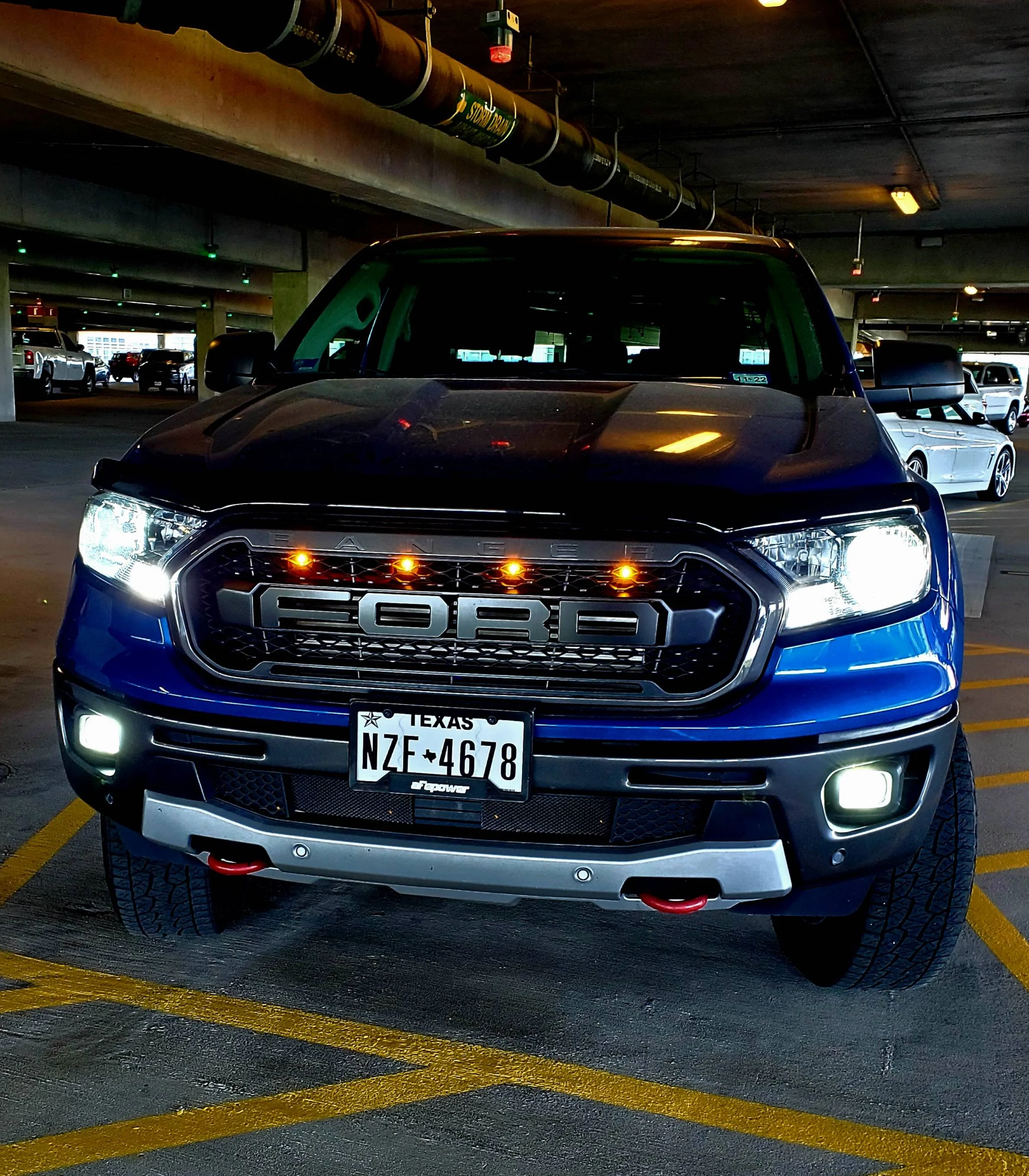

I am running auxito switchbacks in the parking lamps.
Here's how they look with the headlights lights on:
