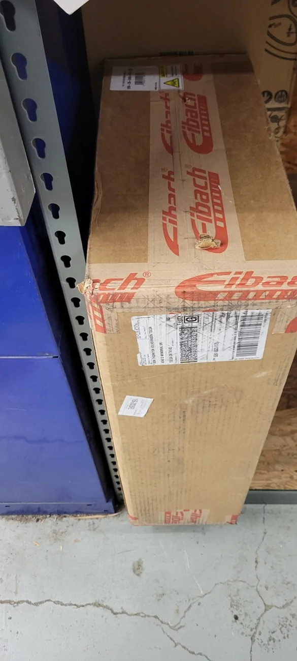

Getting ready to install some suspension, and I can't seem to find a definite yes/no answer. Can I reuse the hardware or do I need to replace them? I have watched several videos and none of them said replace. Coming from the VW world, most suspension hardware is "one time use" only. I just want to be prepared.
Teaser ;)

If that's a coil over lift kit, it should have the needed hardware.
I put a level/lift on my 24, strut spacer type. I reused the HW.

I reused hardware when I put the leveling kit on the wife’s truck. I think the only hardware you’re not supposed to reuse are u-bolts for axles. If you’re lifting the rear end and take them off to install blocks, you should replace them.
