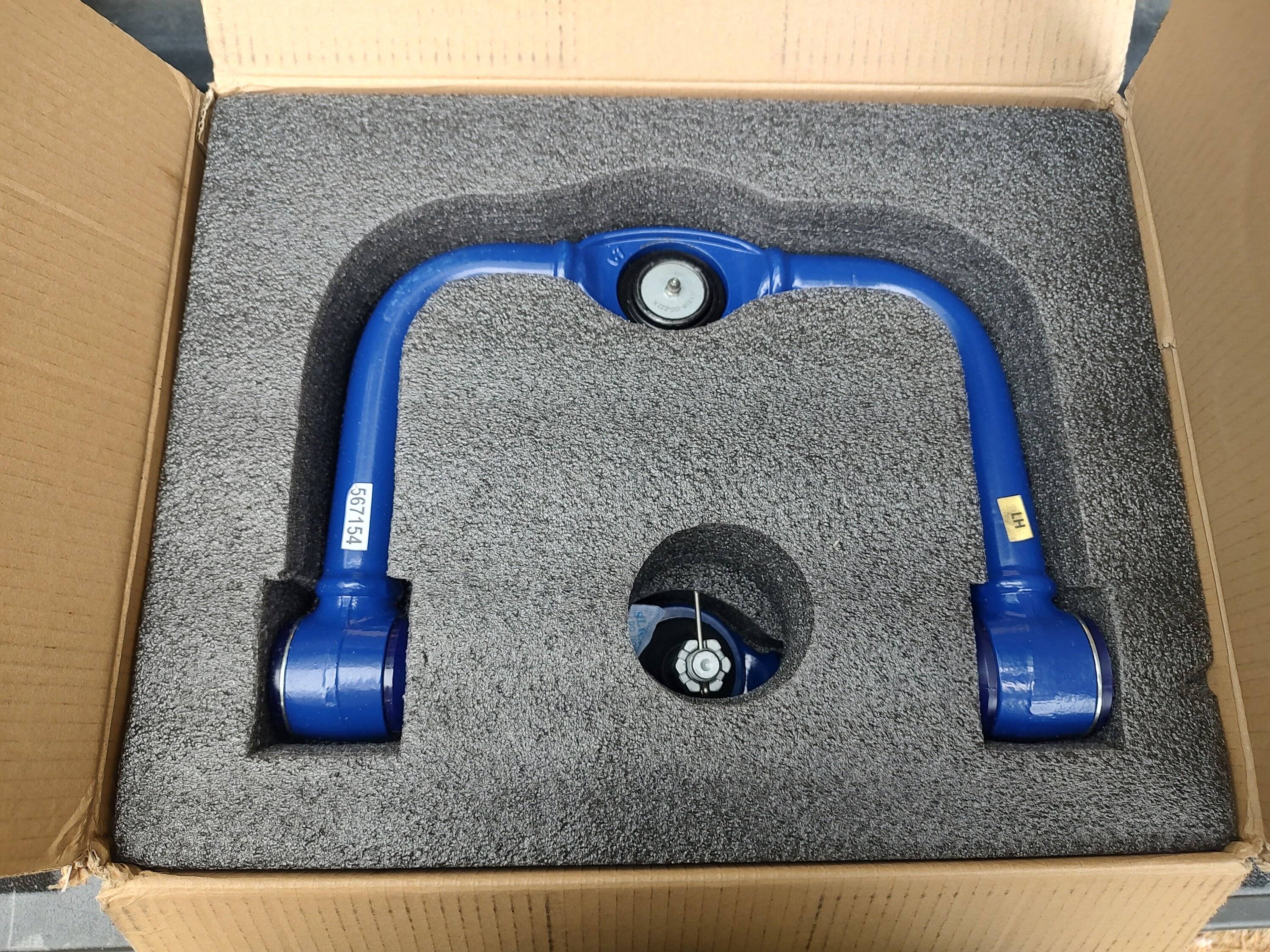

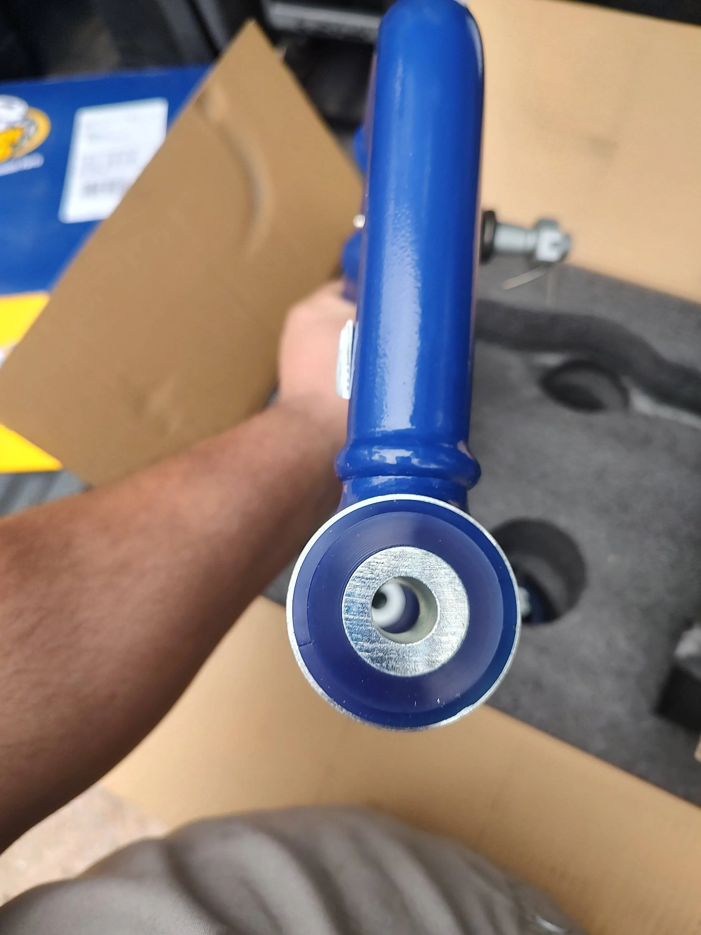

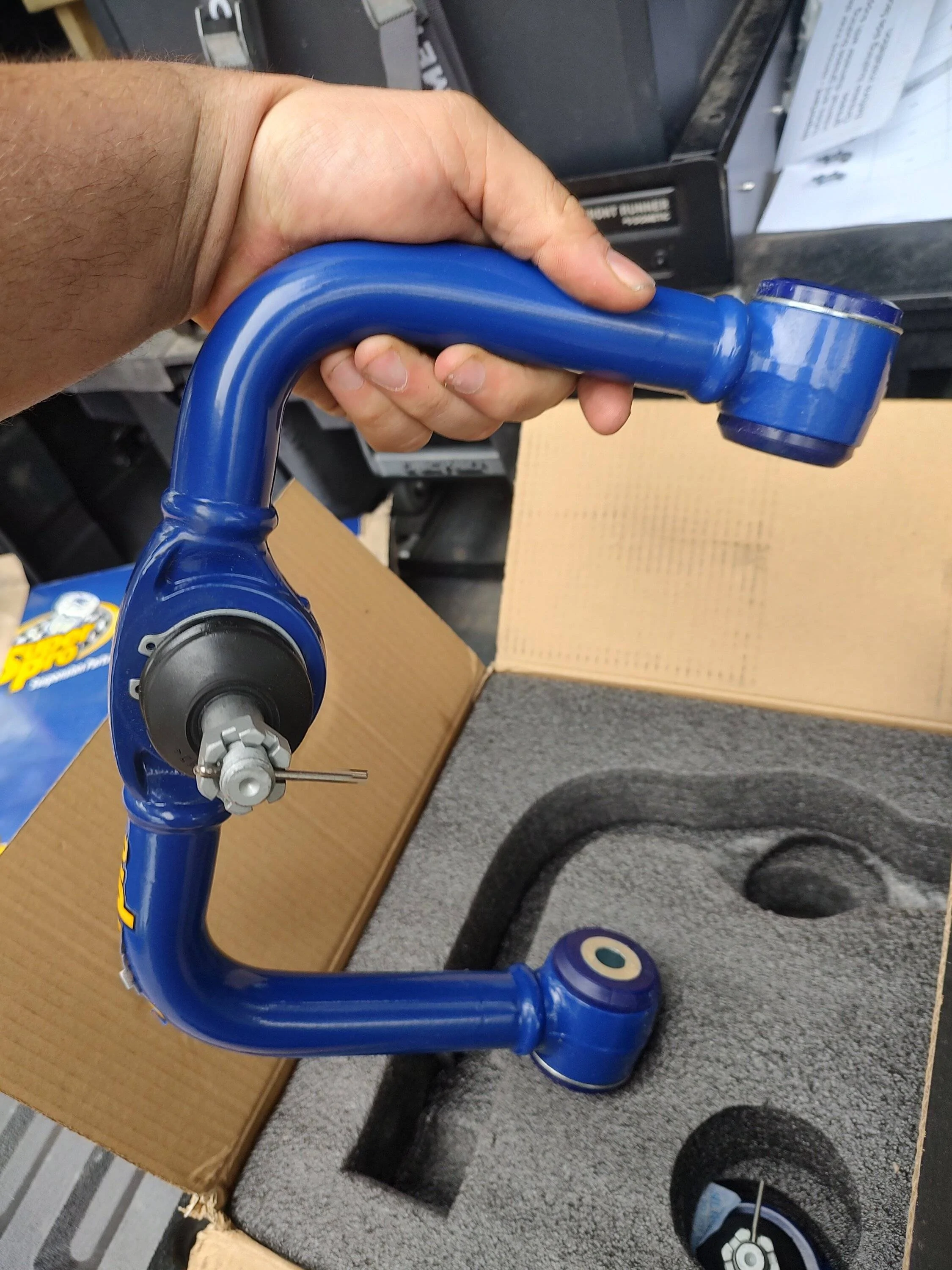

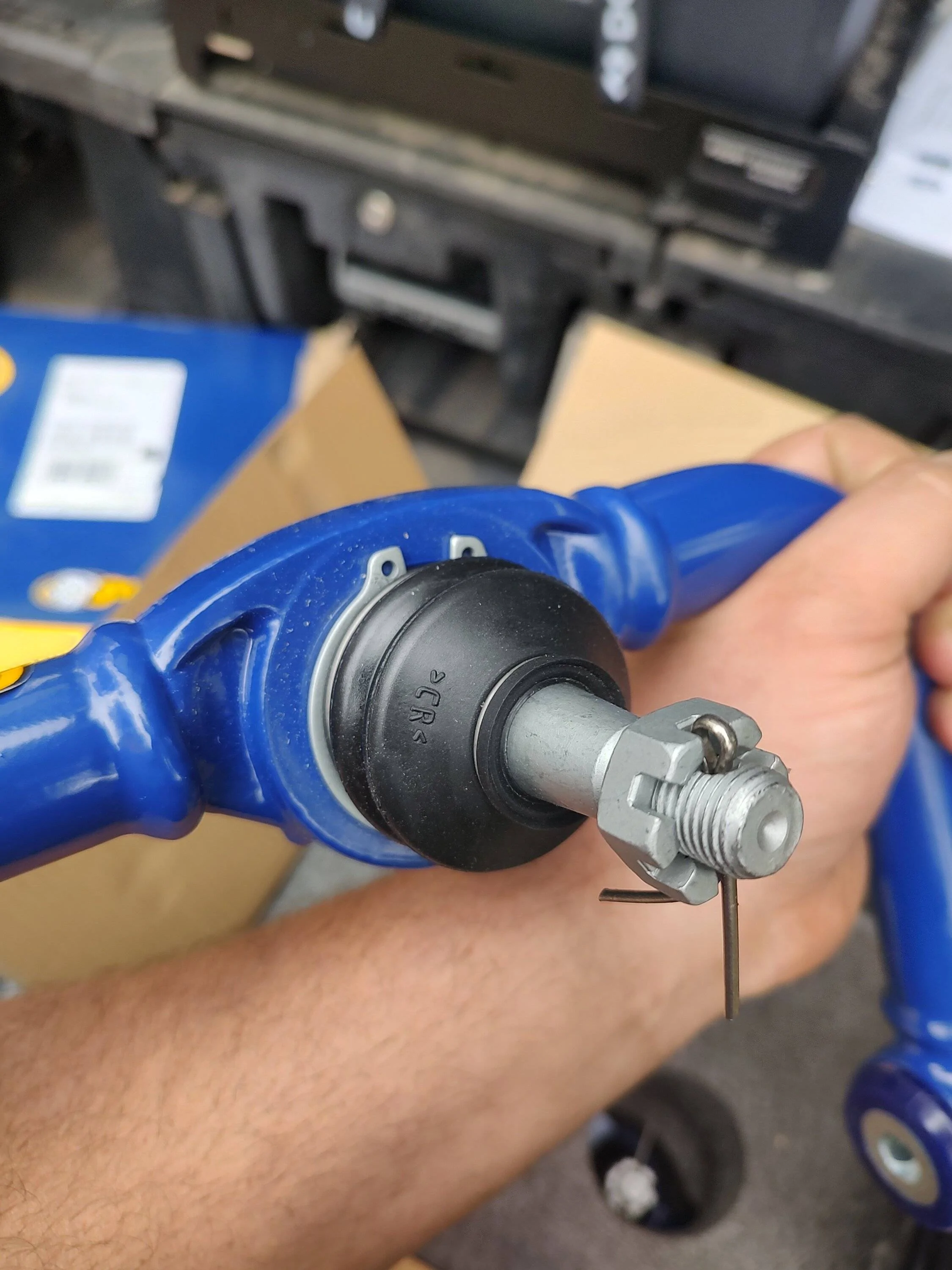

Thankfully there was a place nearby that had them in stock and they arrived today in the mail! After I got home I decided to open the box to get a closer look! Up close they look really nice. It uses SuperPro Bushings and a nice grease able heavy duty ball joint! I can also get a service kit from SuperPro in the event I need to replace the bushings and ball joints.

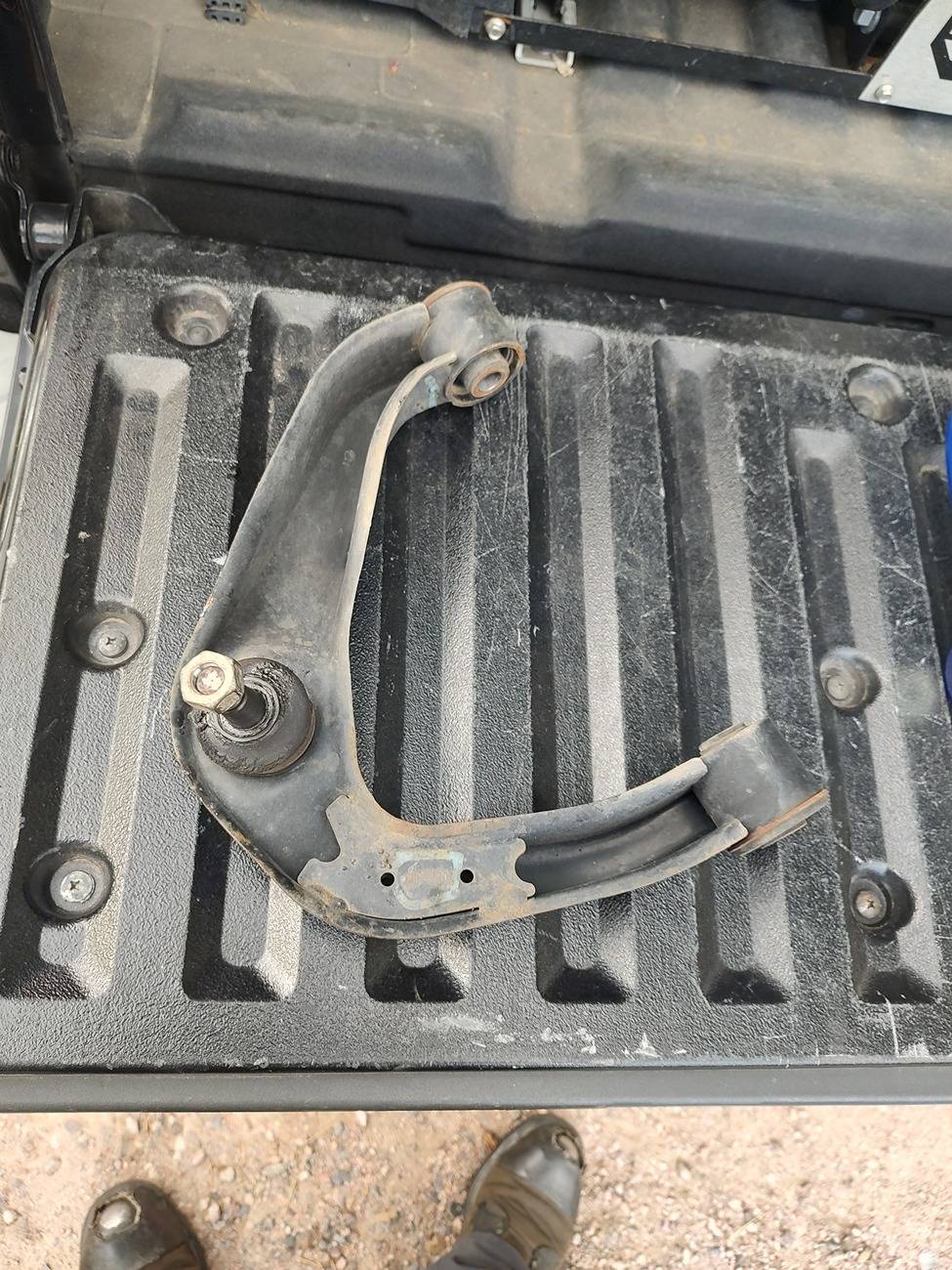

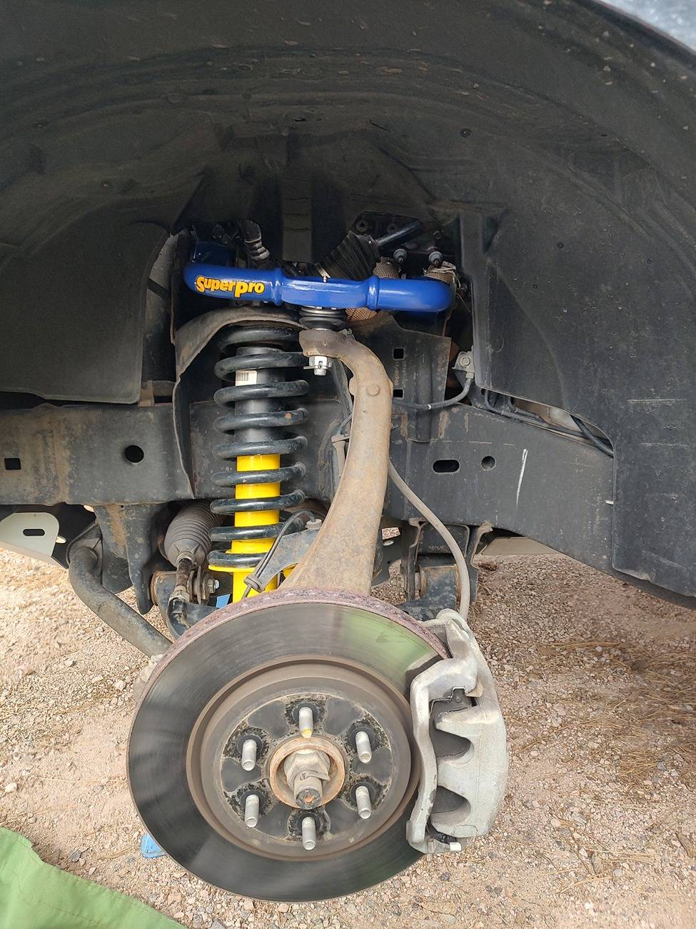

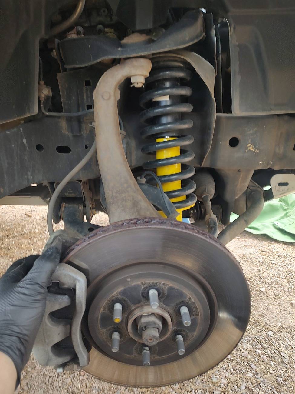

So I had a little bit of extra time with sunlight once I got home from work and decided to get a little adventurous. What I mean by adventurous is tackling the control arms.

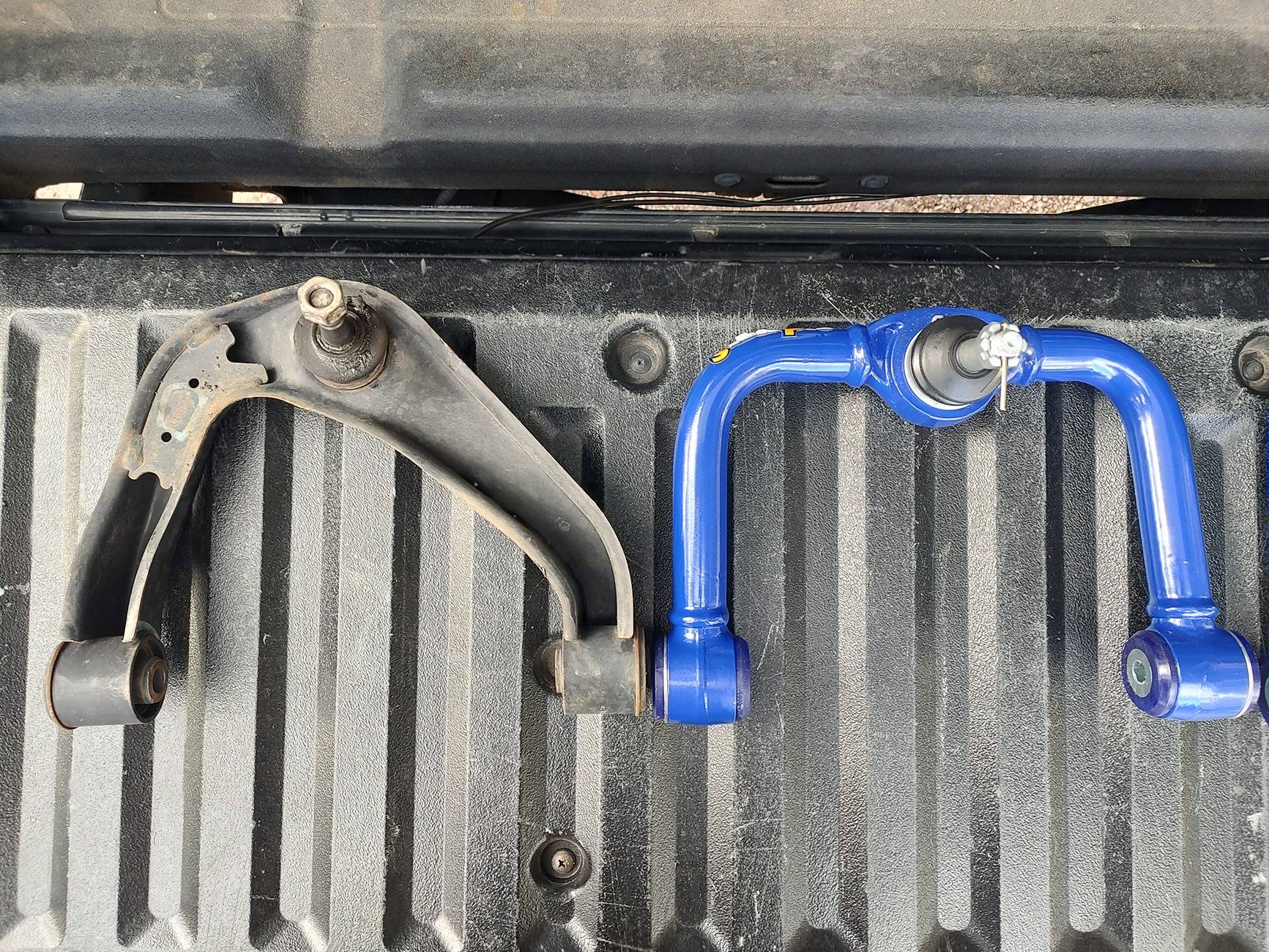

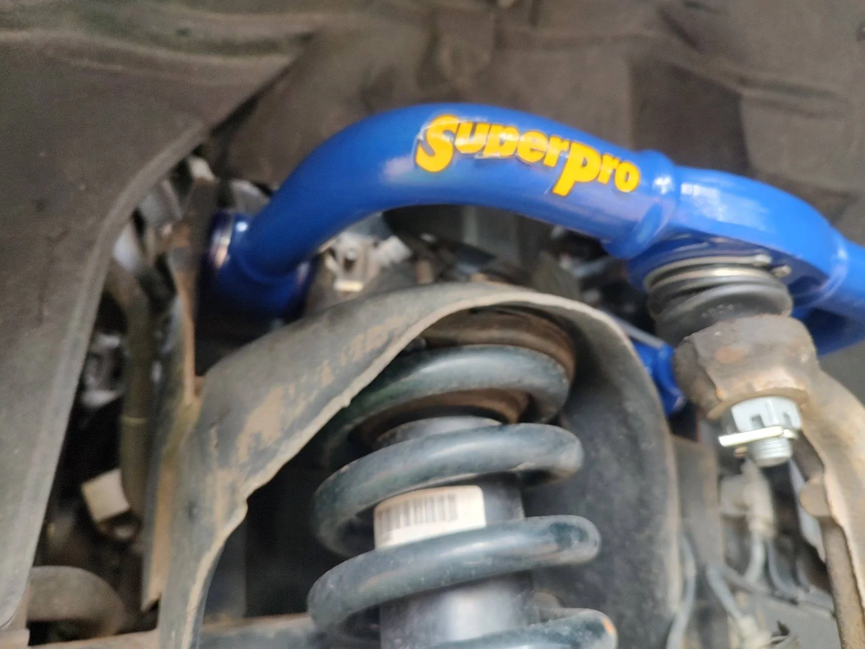

I do have some pictures below showing some general comparison of the clearance advantage I got with my truck along with the general shape difference of the two control arms. Obviously we got the regular factory control arms which are technically still considered normal for most individuals. We also have the very cool looking aftermarket control arms that look badass.

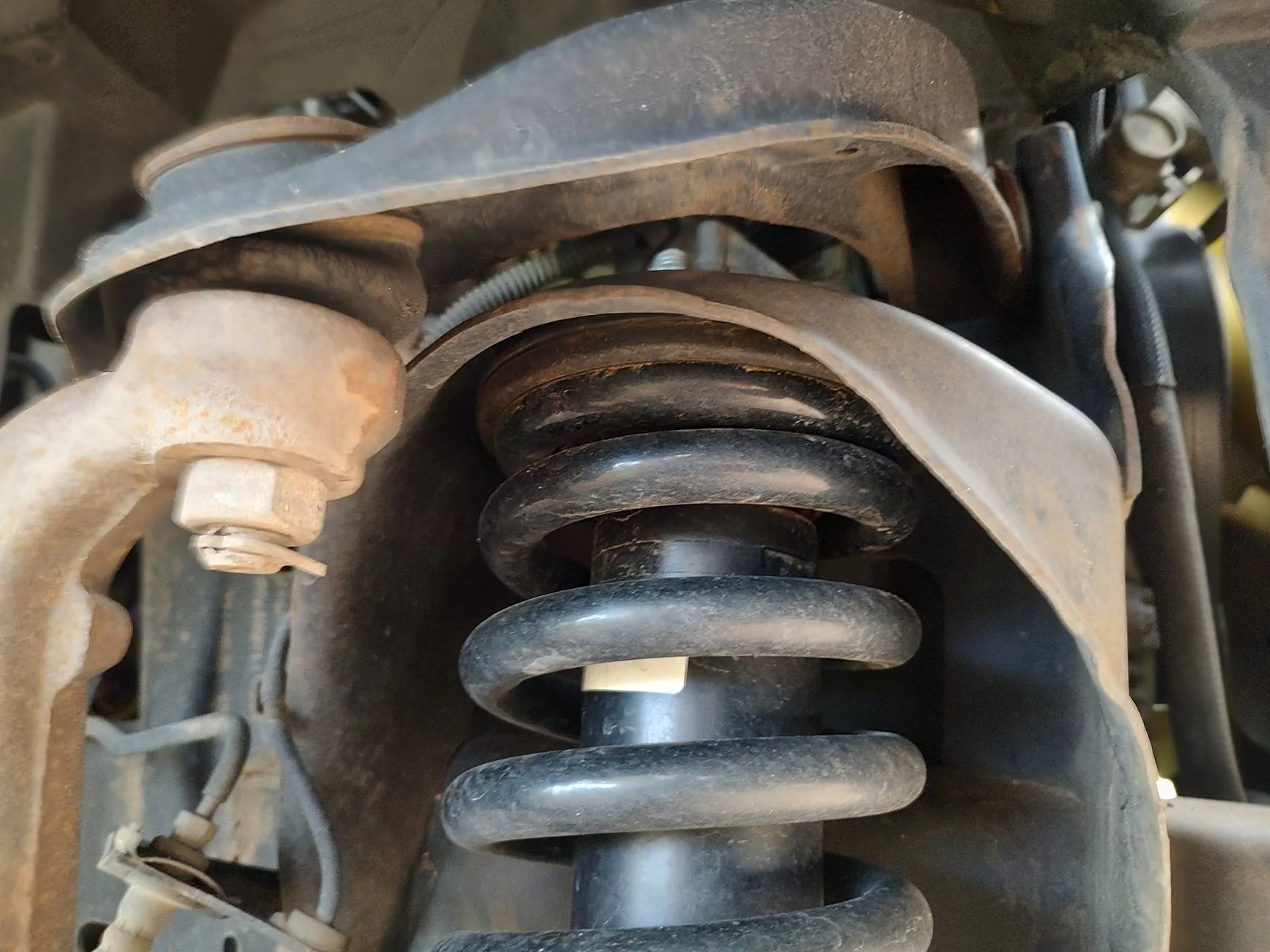

As you can see with the current struts I have installed I don't have a whole lot of clearance with the factory control arms.
After installing the new control arms I do gain a little bit of extra clearance but things are still fairly close.

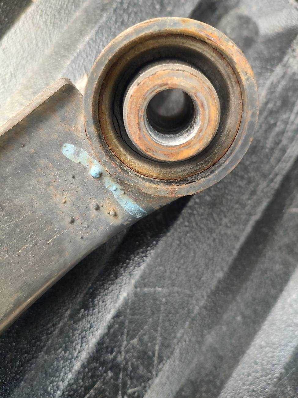

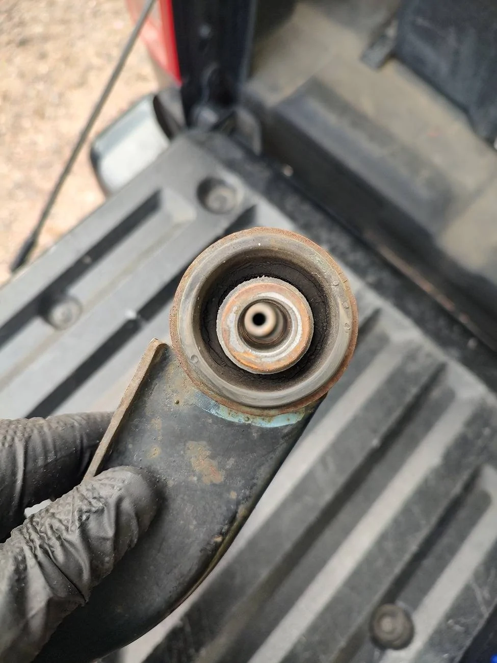

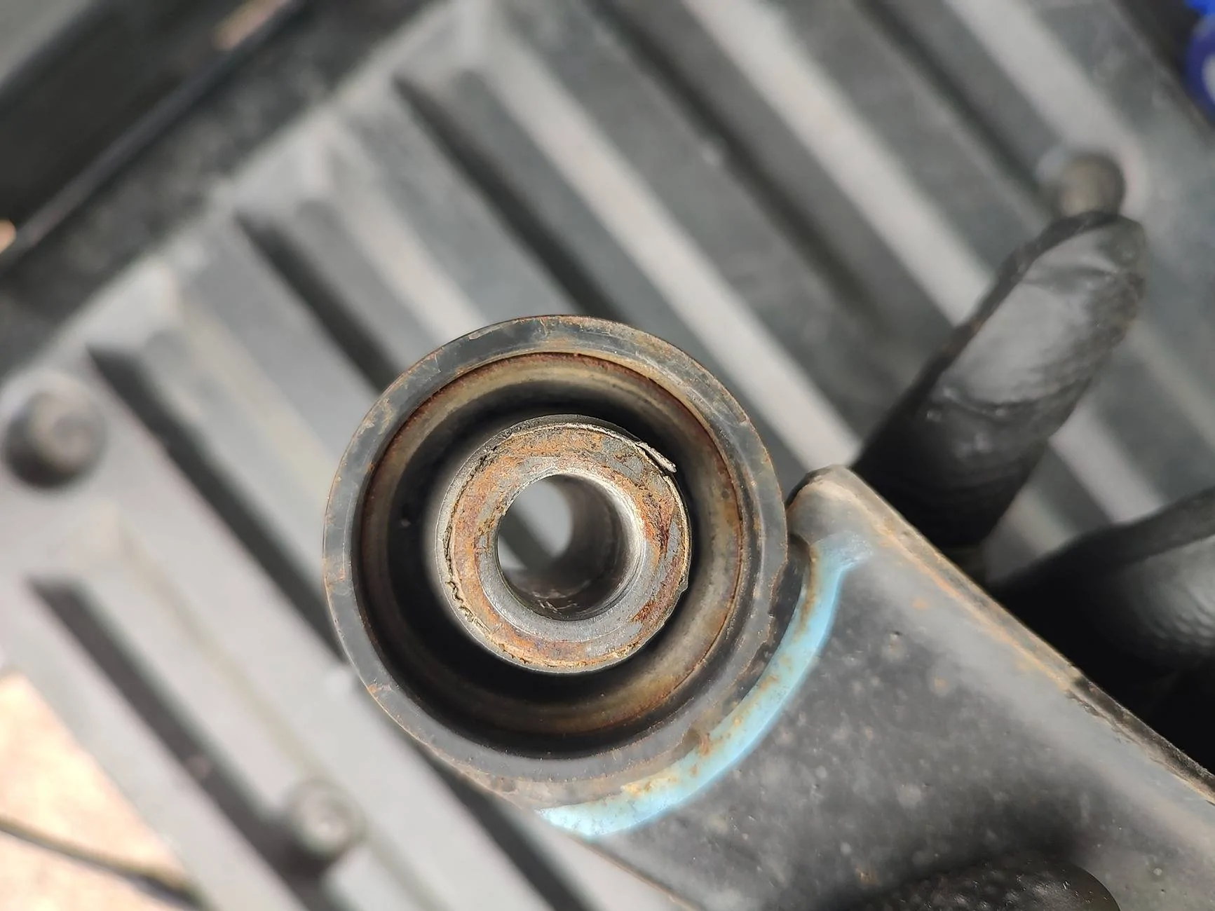

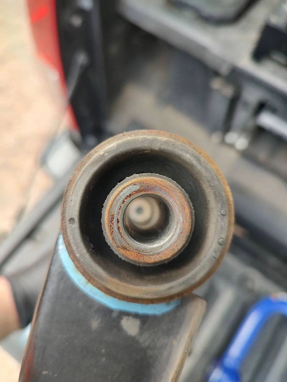

Something I paid attention to as well when I took the old control arms off, the bushings in these control arms were flogged. Keep in mind this truck is a 2012 and has 144,000 mi on it I also suspect these might be the OEM control arms. Let's just say that I accidentally did some very nice maintenance and I'm sure that's going to help the overall ride and control with this vehicle.

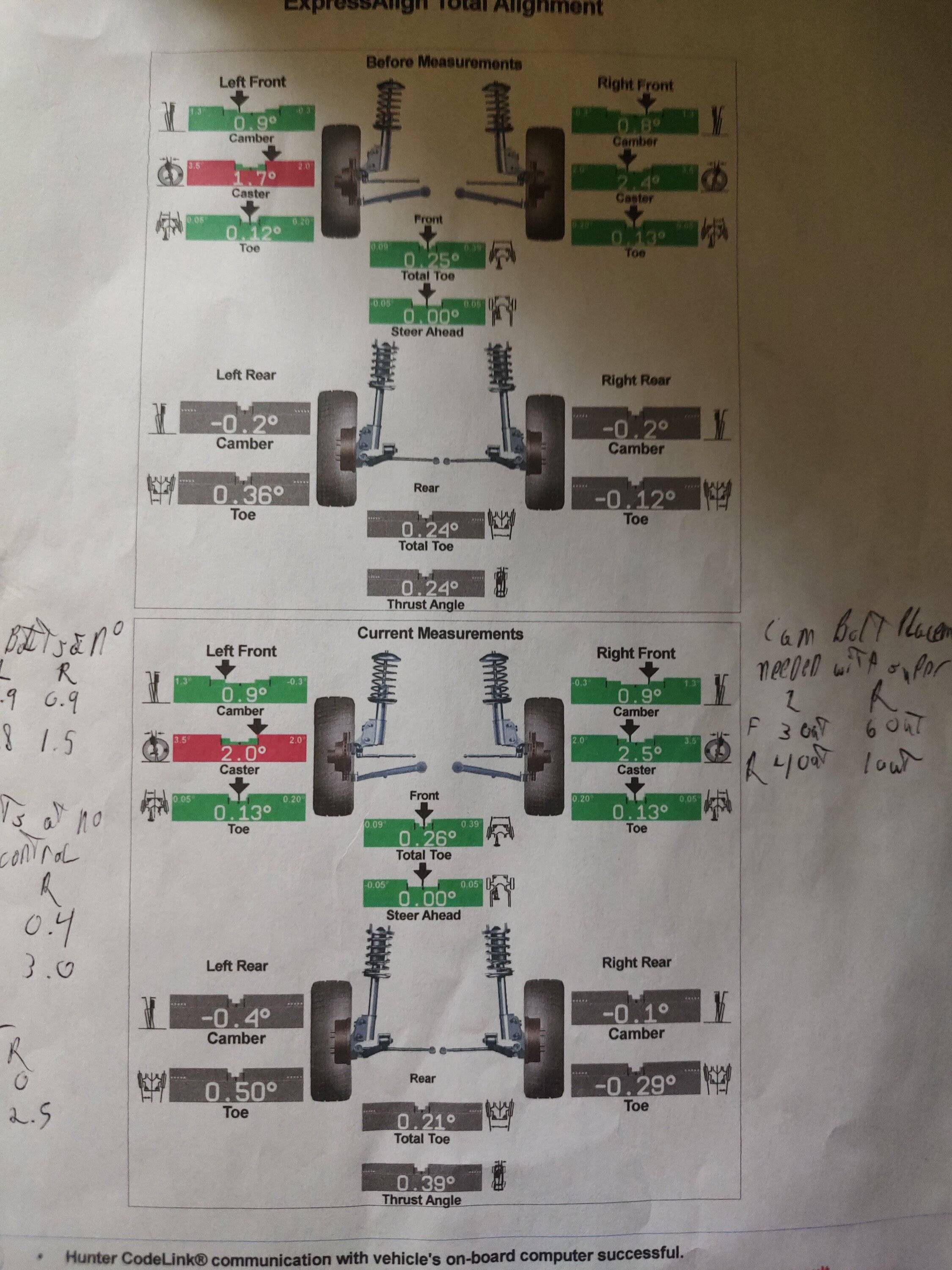

Well I got the alignment taken care of this morning and I will say that I was impressed. With all the cam bolts as close to neutral as possible the Camber and Caster was great!! I was about to -0.1° L and 0.2° R for Camber with roughly 3.2° L and 3.4° R for Caster at the beginning of the Alignment. All of this was Green BTW! I did not get to see an after adjustment number as the printer was acting up, but it was great to see
Put simple these Control Arms allowed my truck to be right where it needed to be with a 1.5 inch lift. I think it's safe to say that it is an excellent choice for anyone that can get these control arms!
