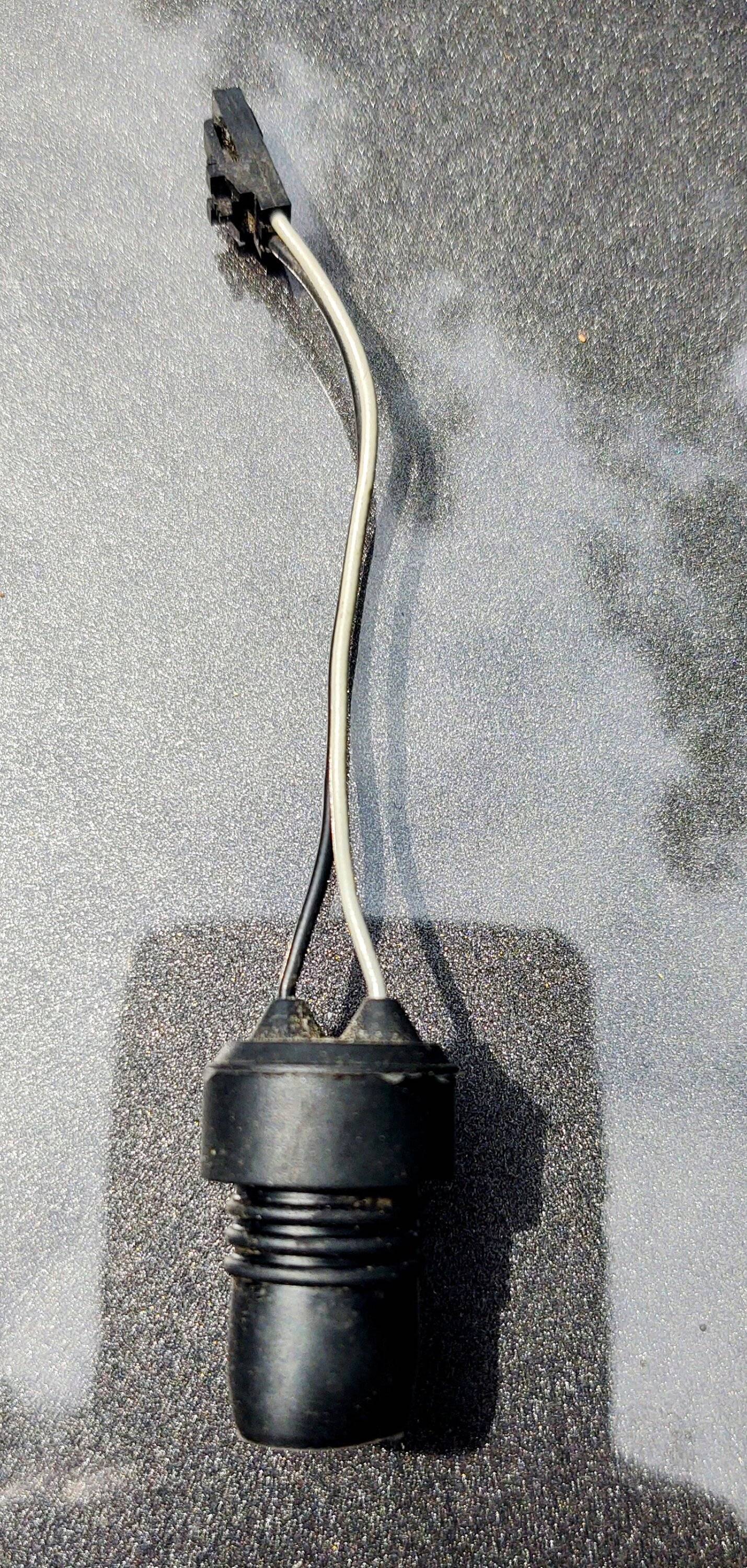

Since I have the non-factory turn signal option, they've included wire connectors and taps (not my fave way to do this) - the logo on the mirror is small after all so that's good.
I have some light bulb wiring extenders I'll cut and splice the wiring to so if there is a need to return to factory nothing will be damaged.

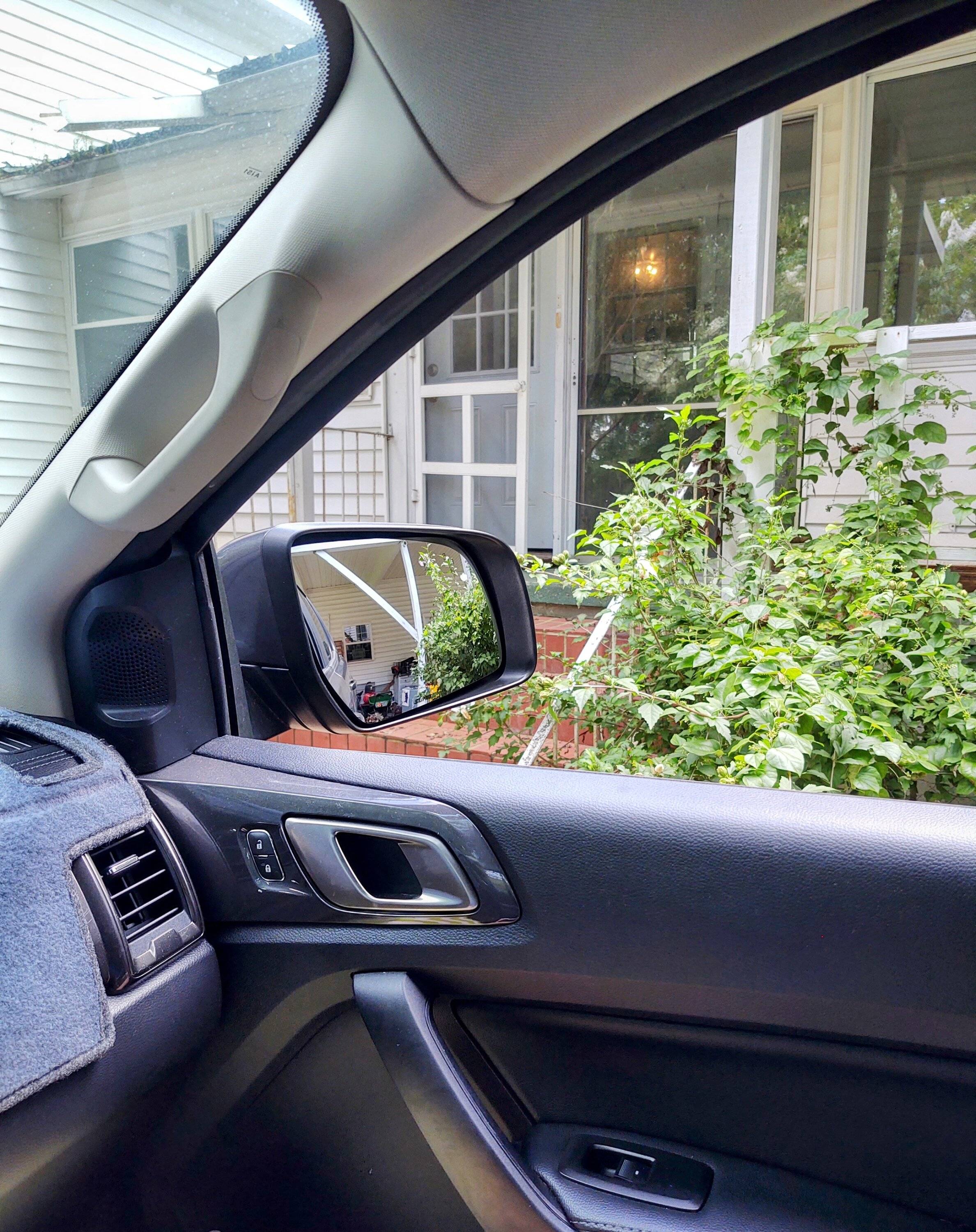

For the curious here's what I did today. I didn't set up a video camera because:
First, before and after views from the driver's seat (you have to stretch these pics to tell the difference - see the grey chair?):

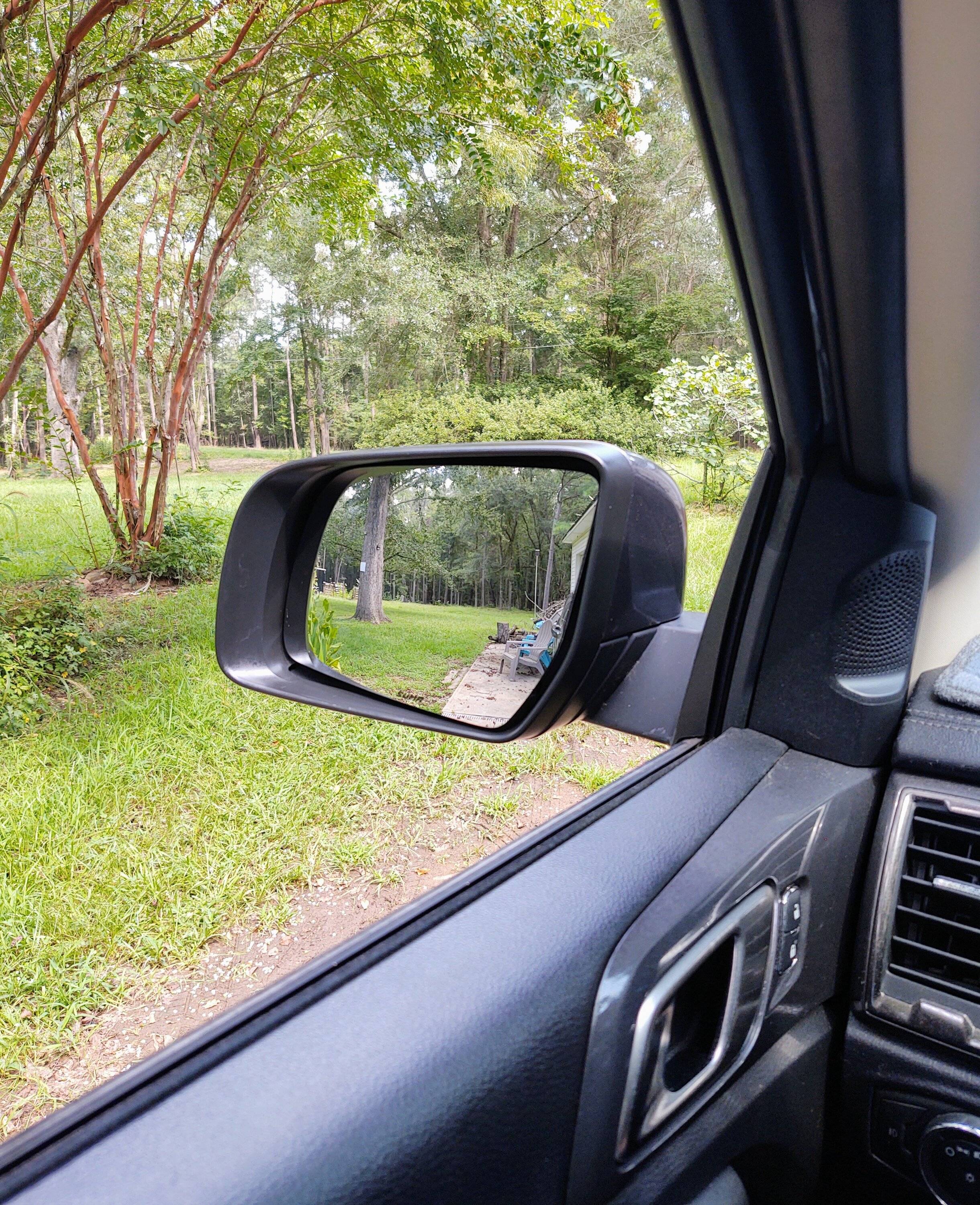

A look out the passenger side:
And after (talk about objects appearing closer):
After a run to the dump I think I'll need to get used to and adjust these for optimal usage. As far as installation my plan to use a spliced light extension was thwarted because the stock turn signal bulb holder is different. I used the dreaded taps for now. If I re-do this I'll need a pair of these to cut/solder:

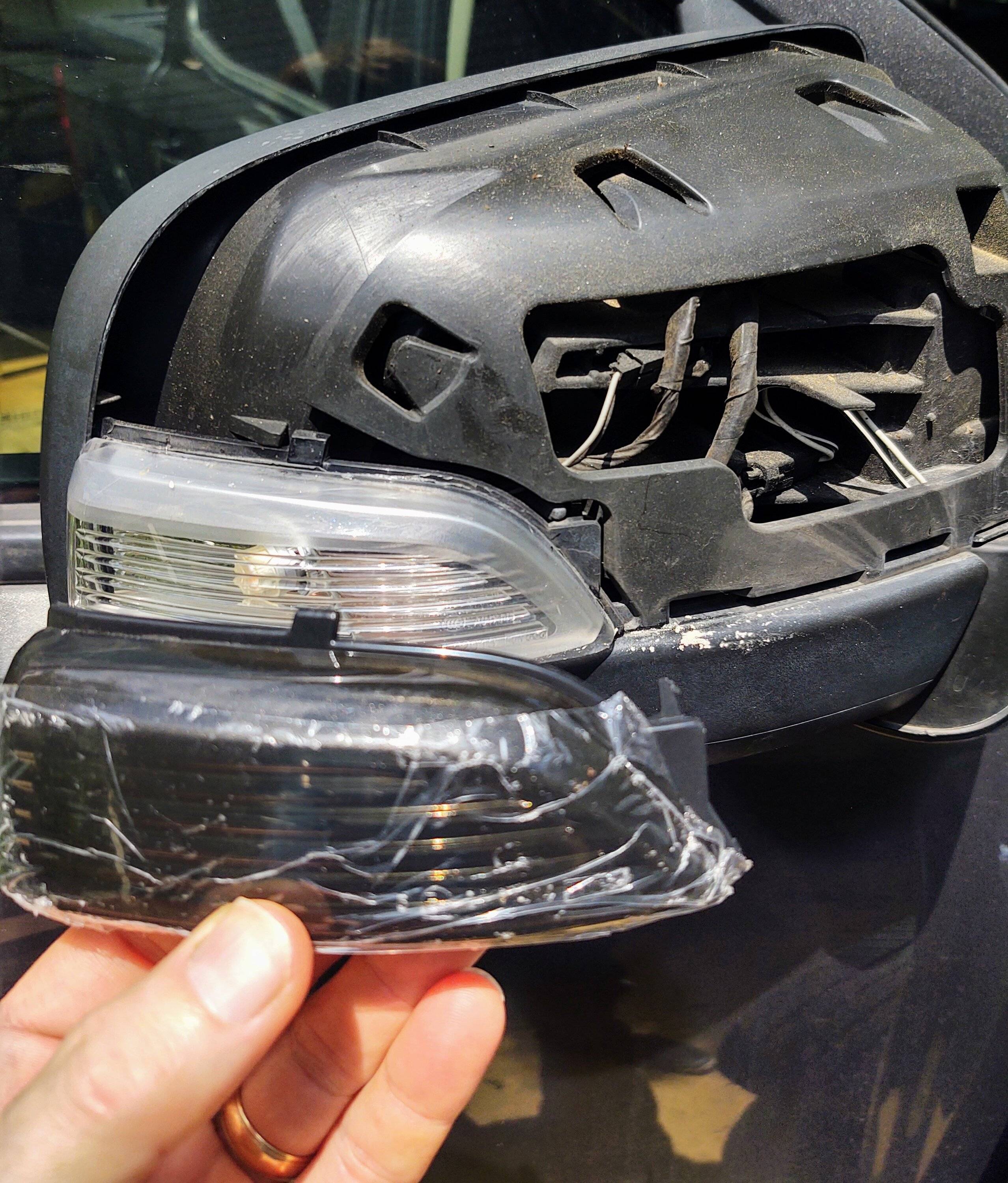

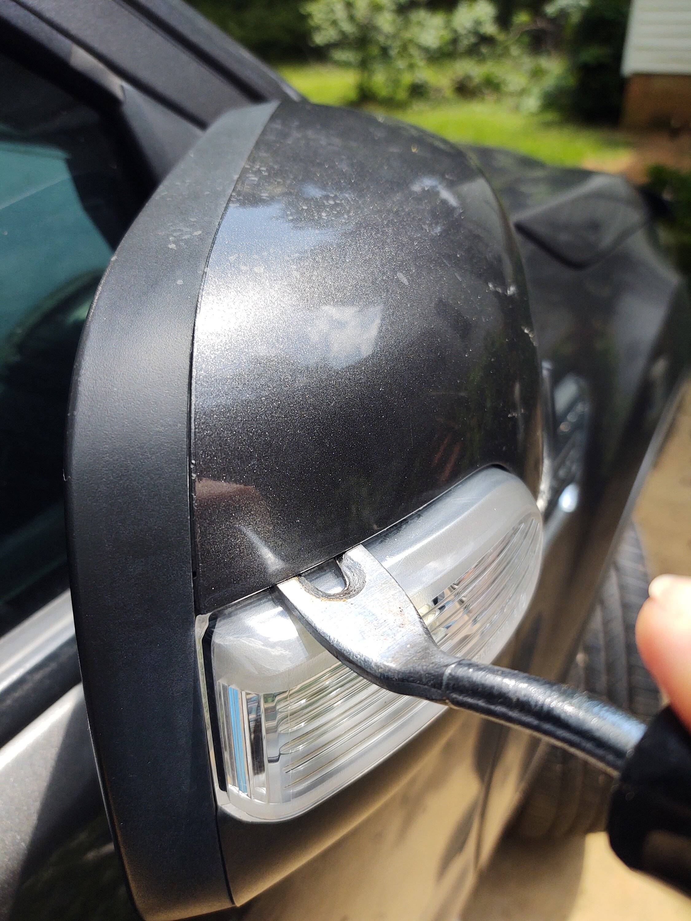

There are a few discussions and YouTube videos on removing the mirror covers so no need for me to go over that:
'cause these are going in while I'm at it:
The most stressful part of this was removing the factory glass. Elsewhere on the forum it was suggested there is a clip where the factory glass is at the seven o'clock position (driver's side)that needs manipulating - I couldn't get a shot while I did it - and grabbing/pulling the corner above it to 'pop' the glass off... pretty terrifying but I didn't break anything that I know of. Five o'clock position on passenger side. Here's the back of the factory driver's unit next to the Suma part with the area I pried loose circled before getting the section above it out:
There is significant differences - especially on the driver's side between the two. The metal parts at the three o'clock and six in the picture only exist on the factory driver's side and not on either Suma piece. On both the factory mirrors there's a bracket that holds the connector for the BLIS that Suma doesn't have. Granted there's not one for the factory defrost so maybe it's not a big deal.
As far as wiring the turn signal - Suma includes connector wires one plain black the other with a white stripe. I tapped the white stripe to the white factory (Lariat) wire and black to black - simple.

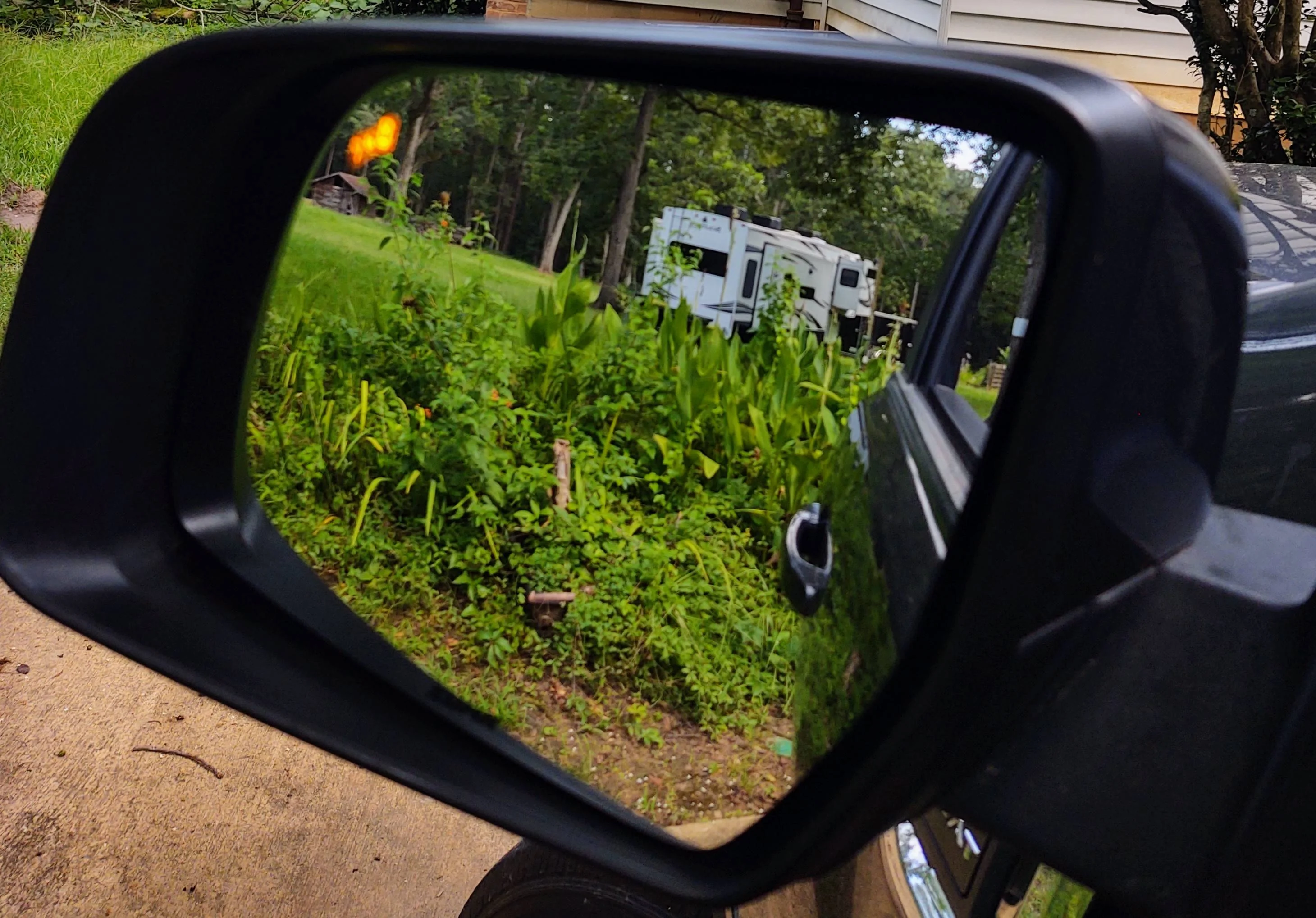

No video but captured these while testing (works on both sides) having swapped an LED in the factory spot works well though it's snug:​
And the BLIS indicator lights up (both sides)
