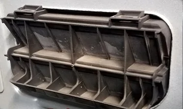

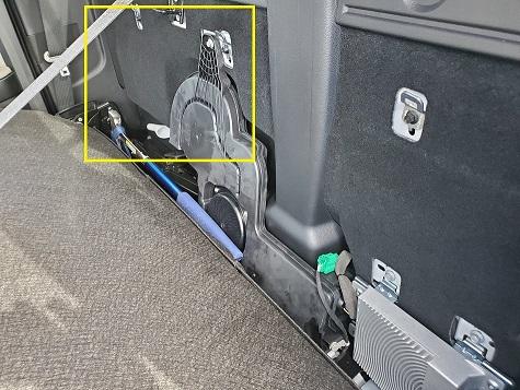

The enclosure in the first link - Ford Ranger PX PX2 Mazda BT50 Under Seat Sub Box - (the one pictured in this thread) will absolutely fit the '19 Ranger.
However, the enclosure in the second link - Ford Ranger & Mazda BT50 2012 -2018 subwoofer fibreglass Dual 10inch sub box - will not work as the cabin vents are in a different location on the 2019 model but you may be able to model something after this configuration yourself.

Second link would also add a lot of noise to the cabin with a full removal of the rear panel card... gross.

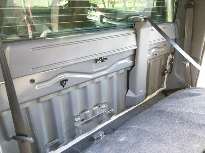

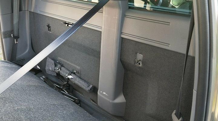

I'm not too sure its entirely different. If you look at the pic and take all your panels off and carpet in the rear all the hooks and even the vent thing to the right are all in the exact same place. From talking with some people in Australia about other mods I have been interested in, the truck stayed the same through 2020, inside at least so I think it probably would fit fine, that being said I'm not impressed enough to roll the dice to find out for sure. I do like the idea though.
You have been misled. The Cabin design has changed in that they added vents to the rear of the cabin. The vents protrude into the cabin so that you would not get a flush fit to the rear of the cabin. The idea is there for a custom box, but the box listed on ebay is not designed for a '19 and up.

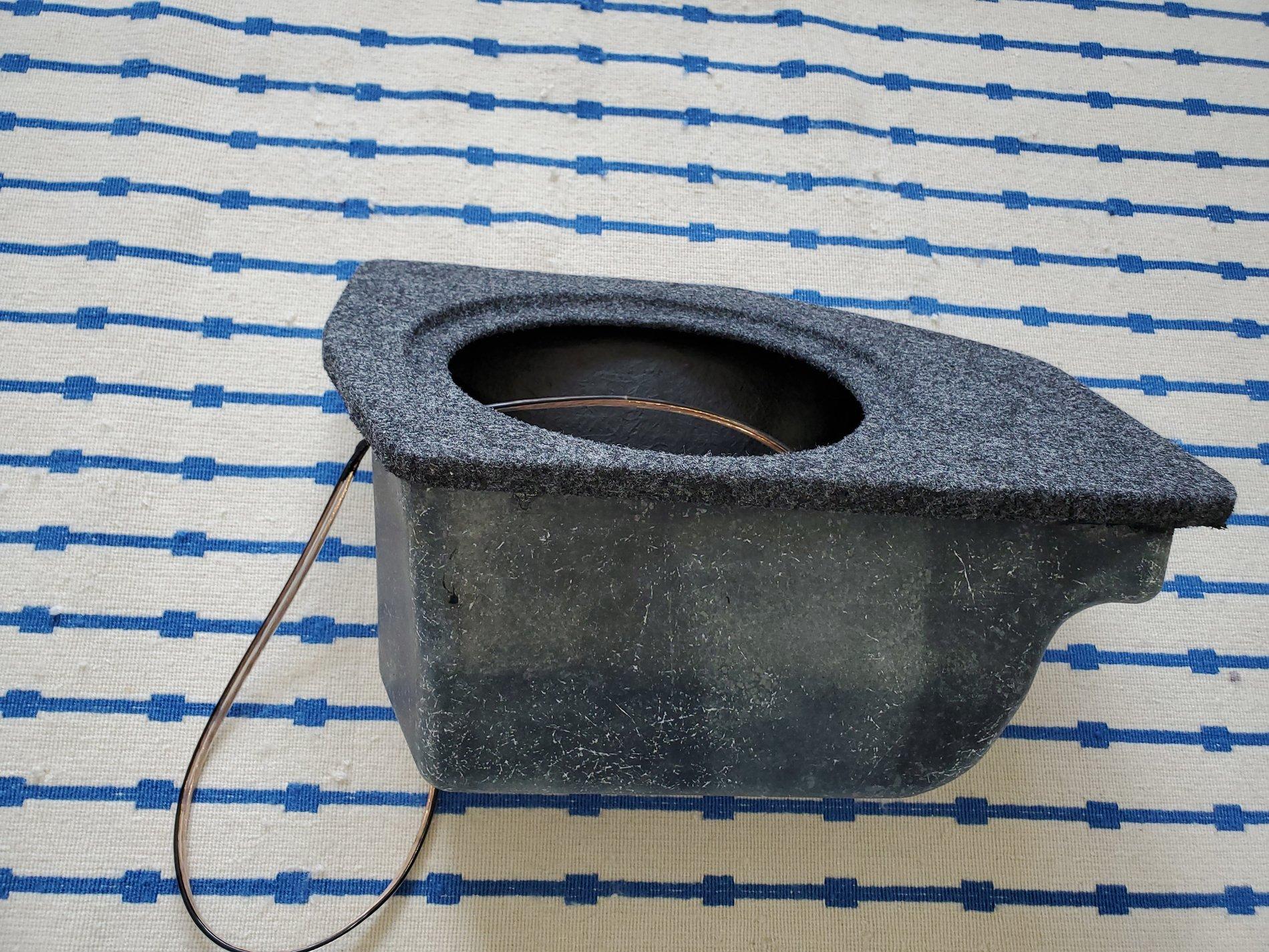

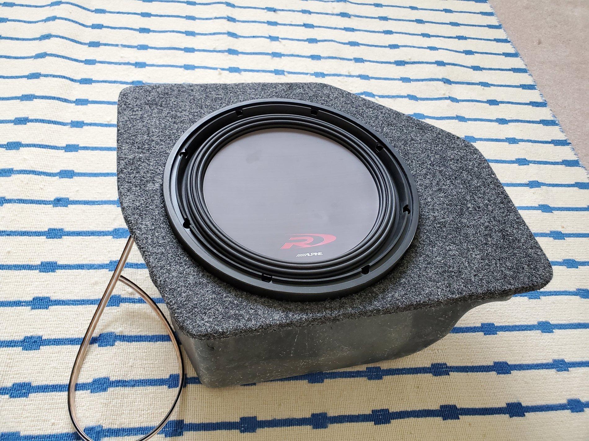

I built my own box for under the seat by using the original plastic bin insert, some sound deadening material, and a small sheet of particle board. I used an Alpine Alpine S-W8D4 and its perfect for the volume of the enclosure.
You can check out my build HERE.
