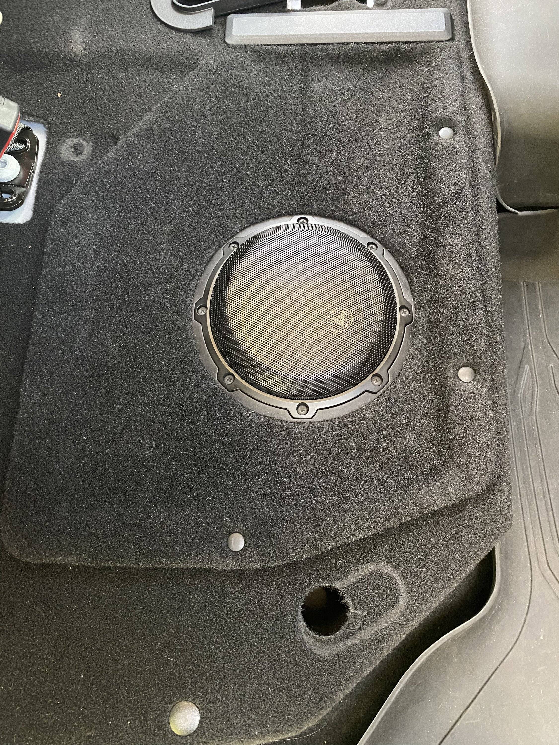

I will try to take photos, after I return back, around June 15. Please know that the customized JL driver mounting MDF surface, for the B&O OEM sub enclosure, was covered with carpet to match surrounding seat back surface, so details might not be visibly obvious, but I will make an effort.
I attach one photo of the sub enclosure cover, that was specially constructed for mounting the JL sub driver. The cover is MDF covered with carpet material that is similar to OEM carpet. This is about it, visually, because the cover is soft-sealed to the OEM sub enclosure, to minimize vibration-induced distortion. The area below the cover is not easily accessible.
