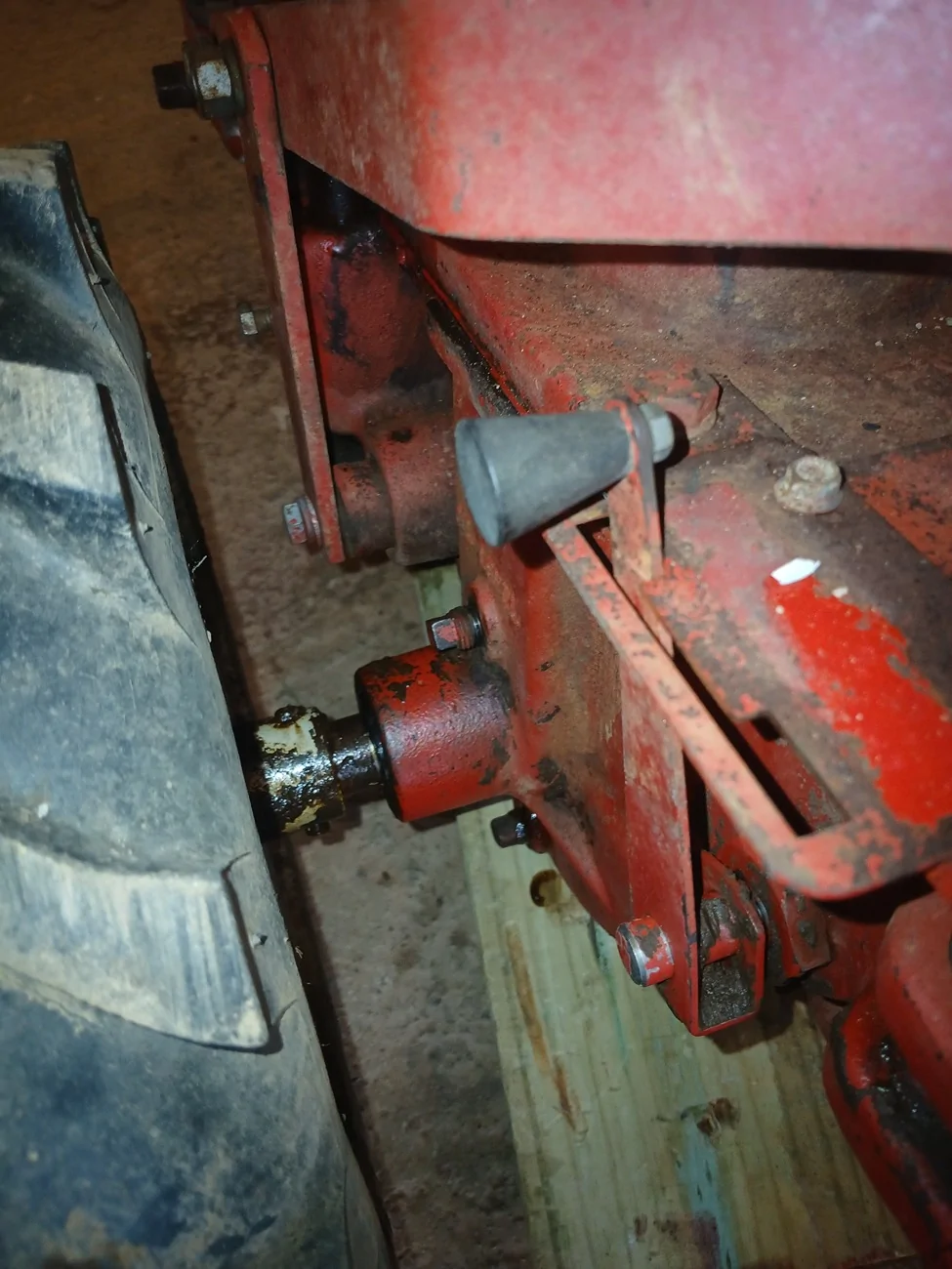

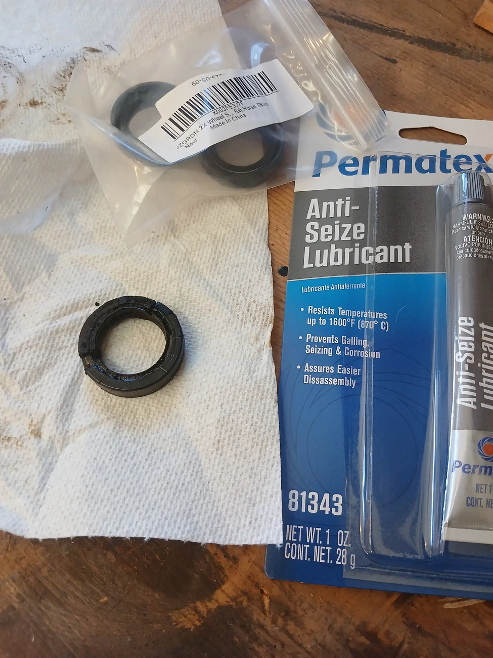

All of that mess just to get to this $5 axle seal... and some antiseize for the next guy that needs to get it off...
So I get it back together and need to refill the gear box, the manual CLEARLY STATES gl4 only , 85 or 90 or 140 but NO GL5 because there is a brass worm gear in there and GL5 has Sulphur which is bad for brass ... went to 5 places and then gave up and had to Amazon some, everything is gl5 now and nobody has any on the shelf...

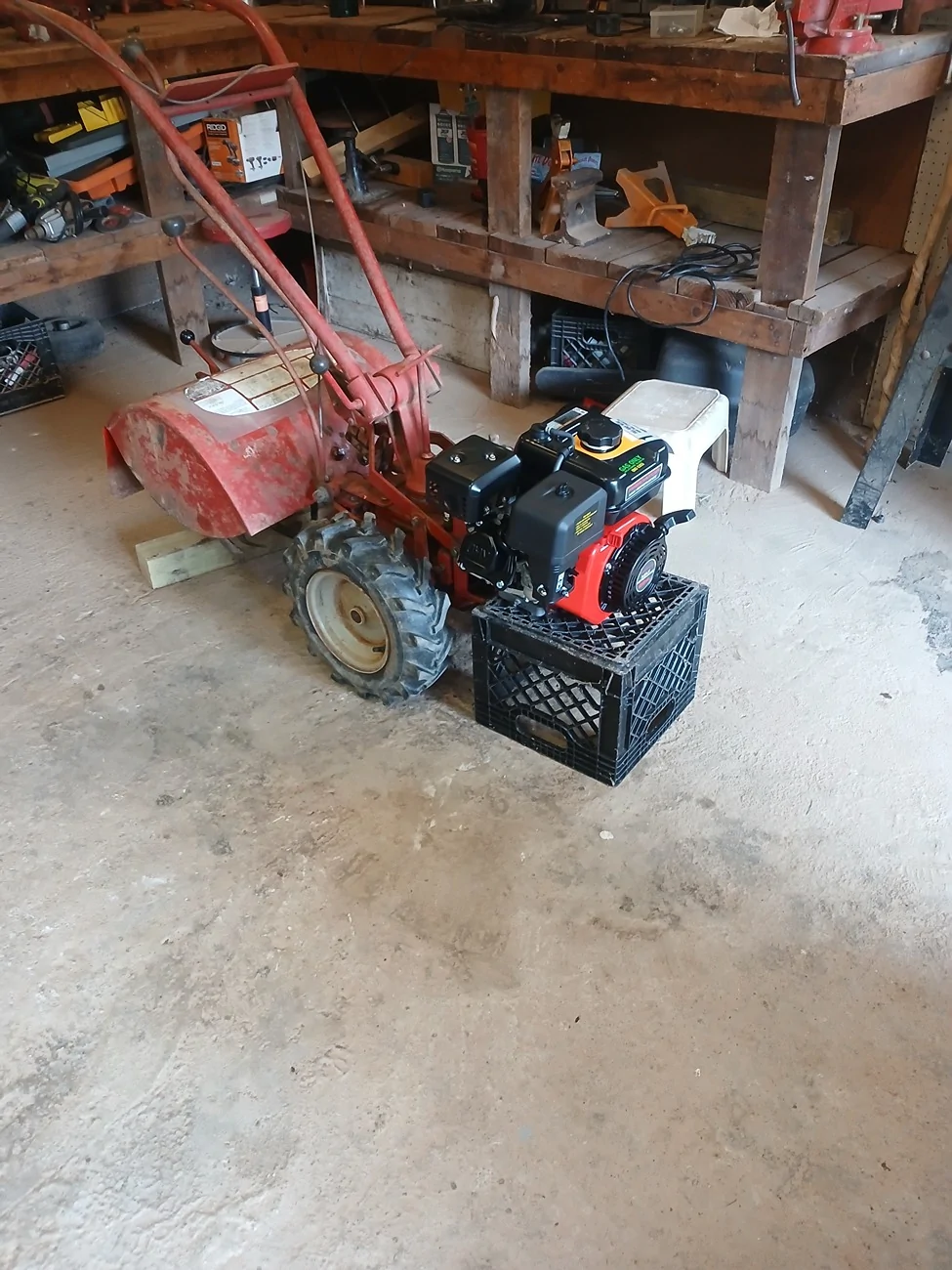

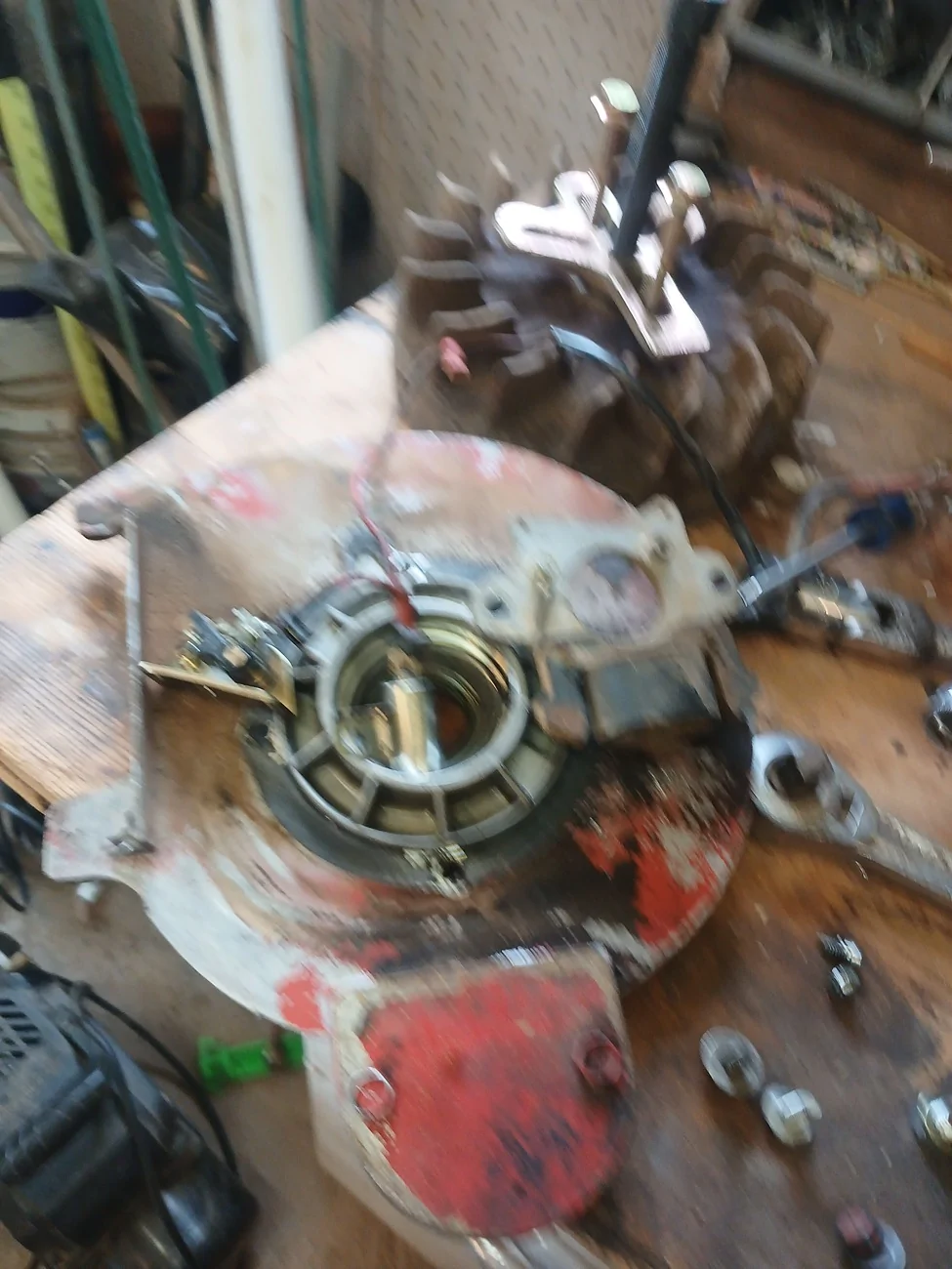

DAMN THIS "FREE" TILLER !!!
I had been starting it every other day or so and walking it around and it's been starting and running great 👍...
UNTILL about 3 days ago , hit once and never started again. Weak and non existent spark had me behind the flywheel thinking 🤔 I could replace the magneto thingy, DISCONTINUED! and the upgrade they were showing me didn't even look like it would work but even if it was gonna be close to two hundred or more...
FIXED IT !!! And I'm now more pissed than ever because I DID NOT KNOW that I could walk into Harbor Freight and buy the whole damn thing for $149.00 and I could stop yanking on this old POS till my guts hurt...
Anyway I guess the total on the "free" tiller if I count labor, parts and pain would be around 8 or 9 thousand 🤔...

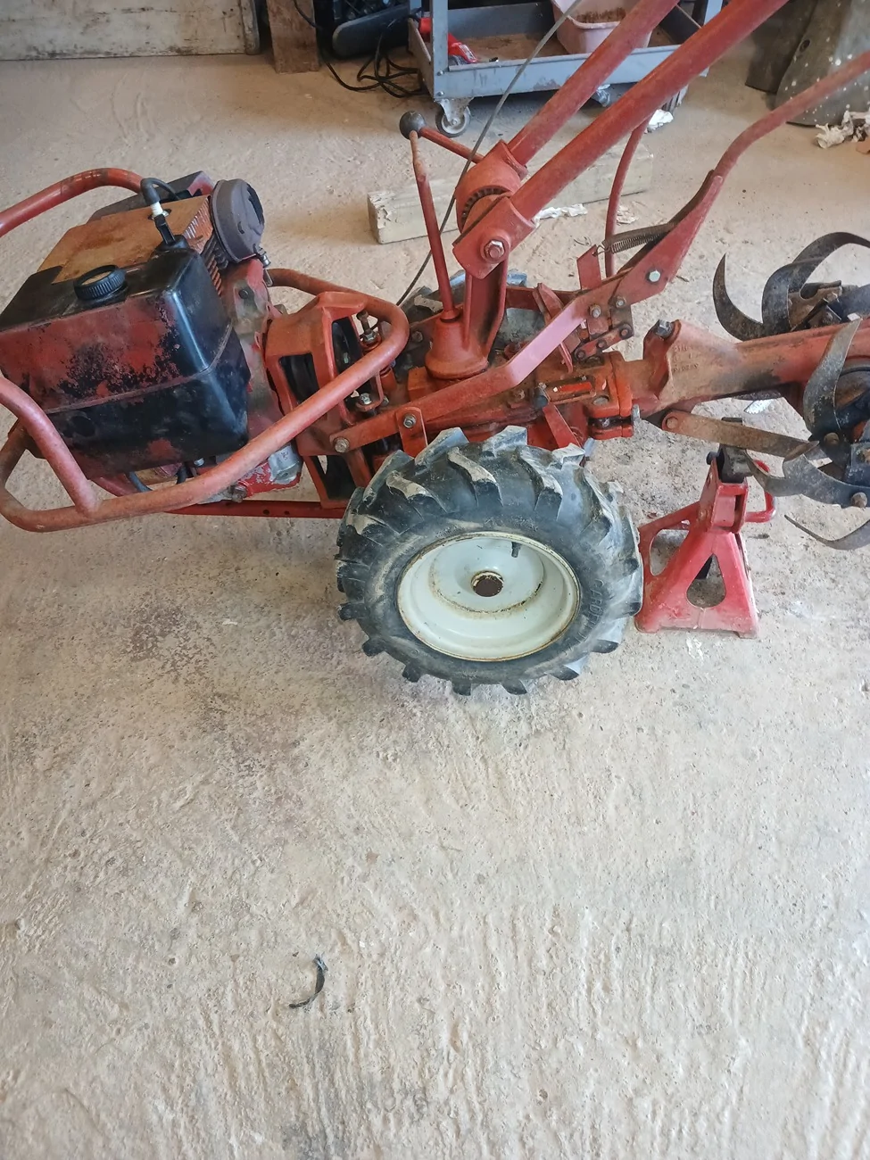

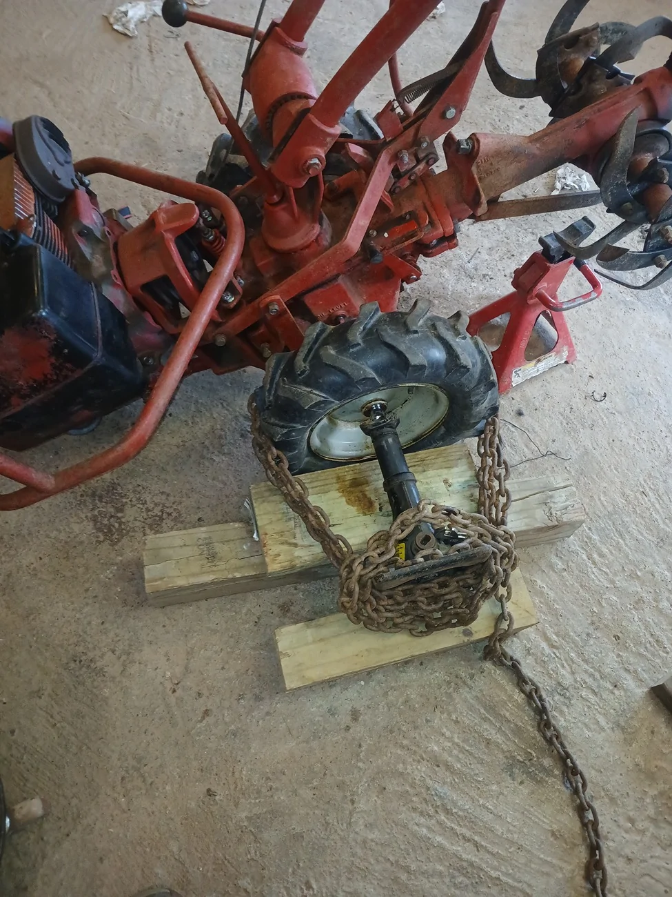

Was gifted this ole girl, leaks everywhere and didn't run, got it running so decided it was worth fixing the axle seal, which is pouring. Drive out the roll pin and since its been covered in oil, it should slide right off! Shouldn't it ???

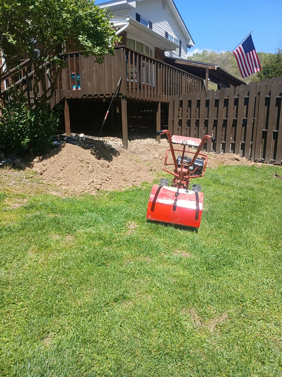

Its quite the tiller ! Never really went above half throttle and at full depth it never bogged on hard packed and old sod ... it did squeal when it hit immovable rocks but thats by design 👌, that Predator is the easiest starting engine I've ever had i believe, takes very little effort to pull...

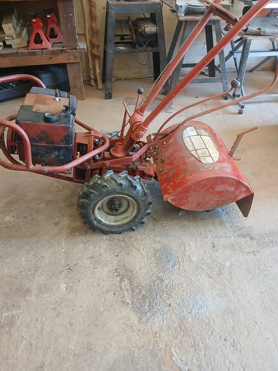

Tiller Time !!!
That looks like an old Troy-Bilt Tiller. Those are beasts, and easy on the back.
