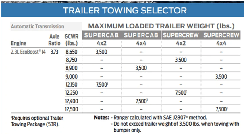

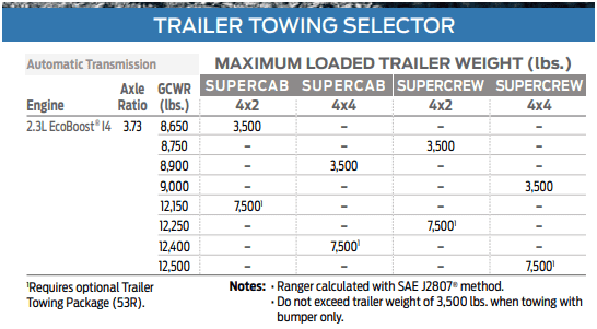

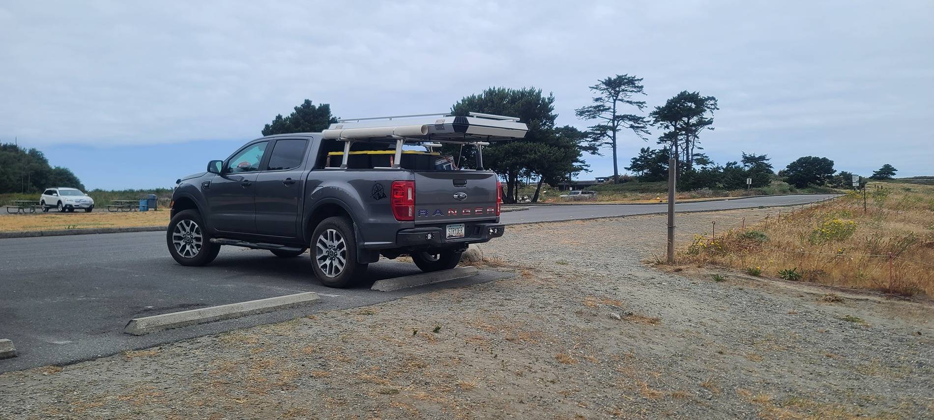

99% correct - GTW vs GCWR (Gross Combination Weight Rating)
SC 4x4 Combined weight max = 12400 per Ford.
TRIP #1: Truck + 24' Coyote Expandable Trailer
I stopped at Loves and paid $8 for a private weigh:
Front axle: 2640
Rear axle: 3780
Trailer ax: 3960
GW: 10380
Camper, 4 days of camping goods, 4 adults, Firesticks, Stick throwers and targets.. I had 2000# of excess capacity. I did have 33" tires - so that probably sucked up the hp a bit.
Trip #2: Truck + 26' Laguna Sailboat
Hauling a 26' lead keel sailboat to Mead was a little heavier. I was running the stock tires and none of the turbo mods. Not nearly as much fun:
Steer axle: 2660
Drive axle: 2960
Trailer (dual) 6580
GW: 12200
Wrecker games = Matt's Offroad Recovery = youtube blogger
Matts Offroad Recovery website

OK, it gets better. The GCWR for a SupeCrew 4x4 is 12500. 12400 is for a SuperCab 4x4. From the pictures, he has a SuperCrew. But he was way over the GVWR of the truck which is 6050. And also over his rear axle rating, whichon my '19 SCAB FX4 is 3470. The GCWR is not the only rating you need to worry about.
And what are these turbo modifications he was talking about?

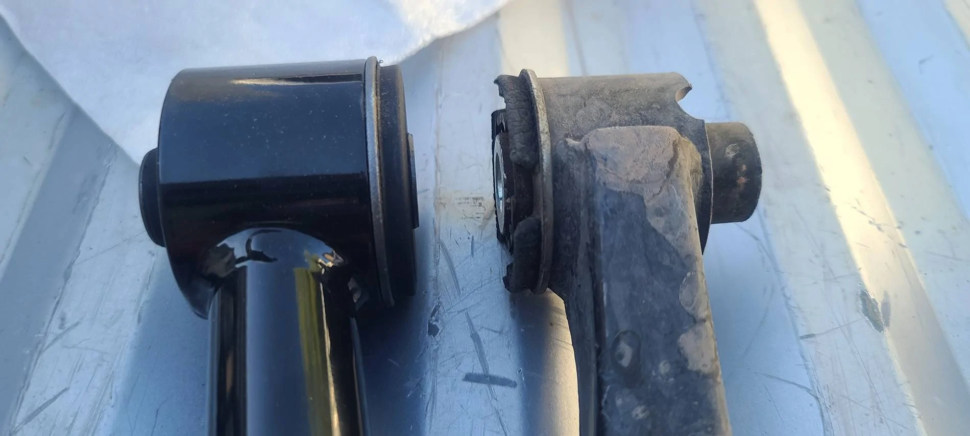

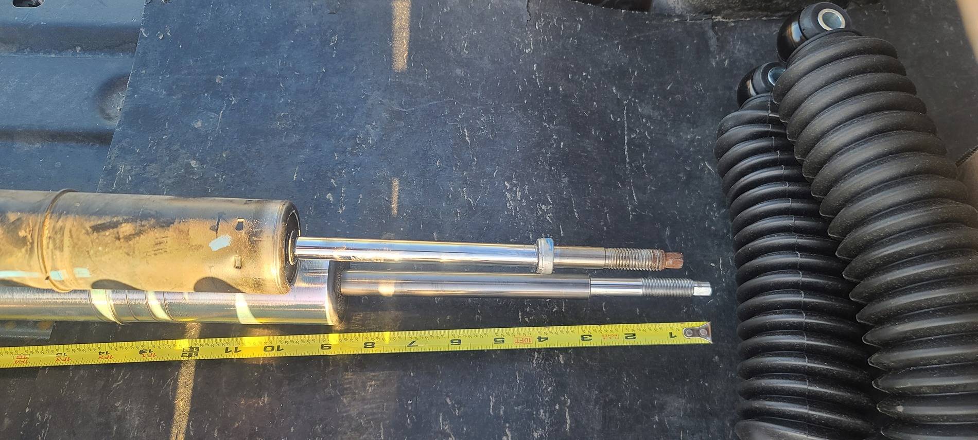

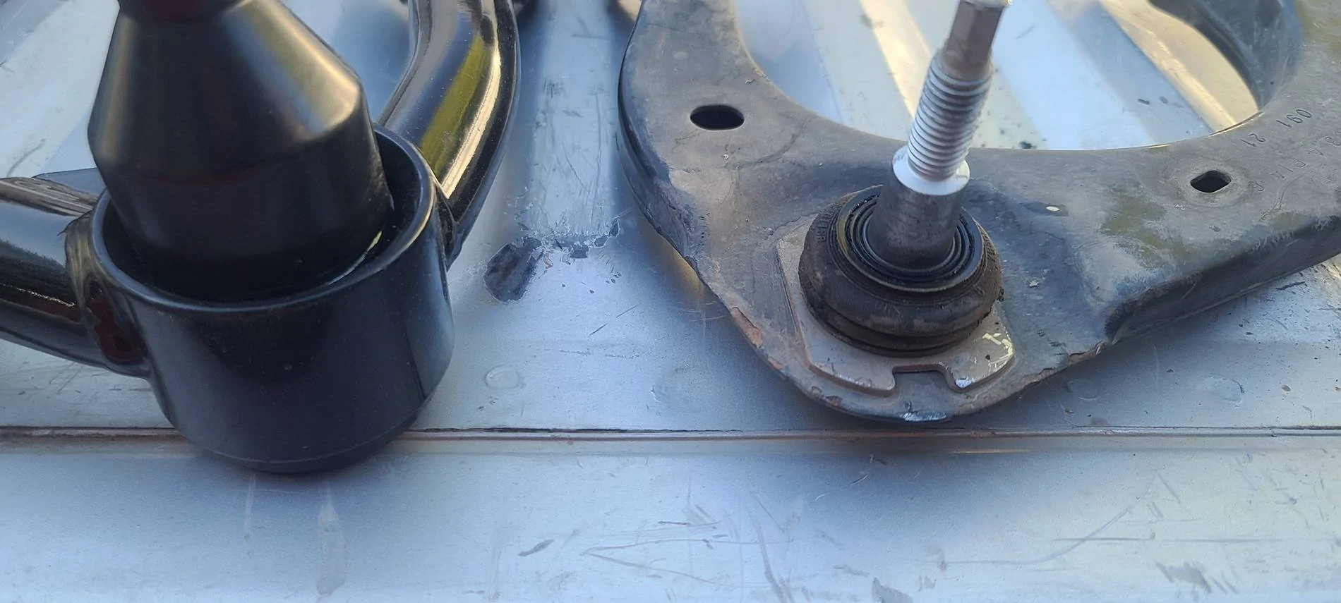

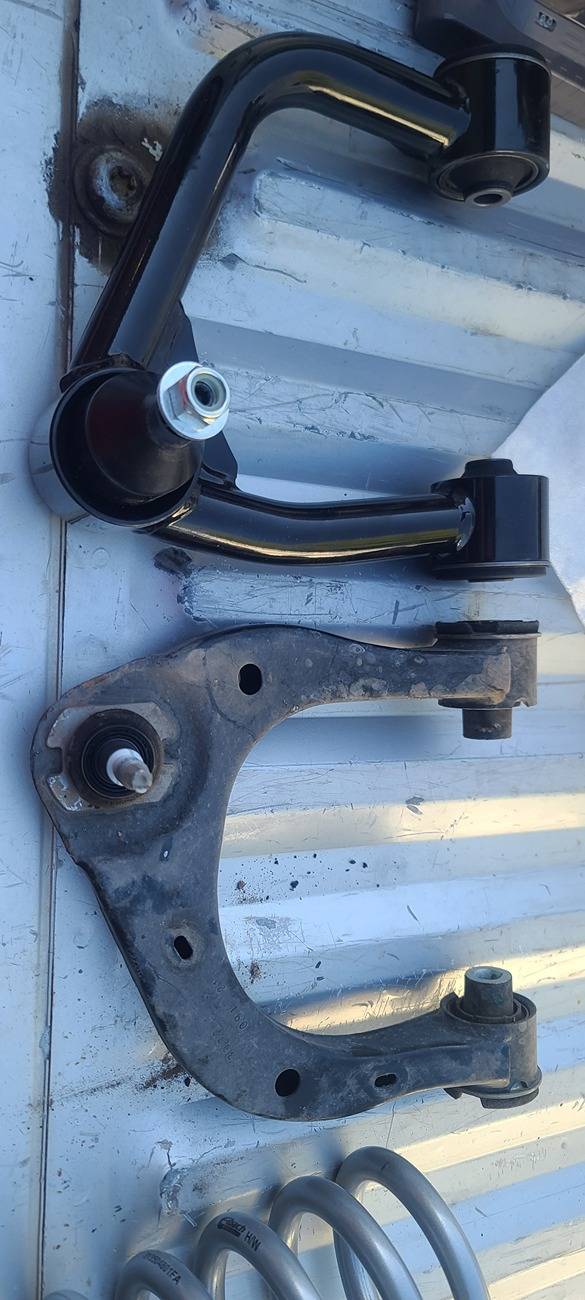

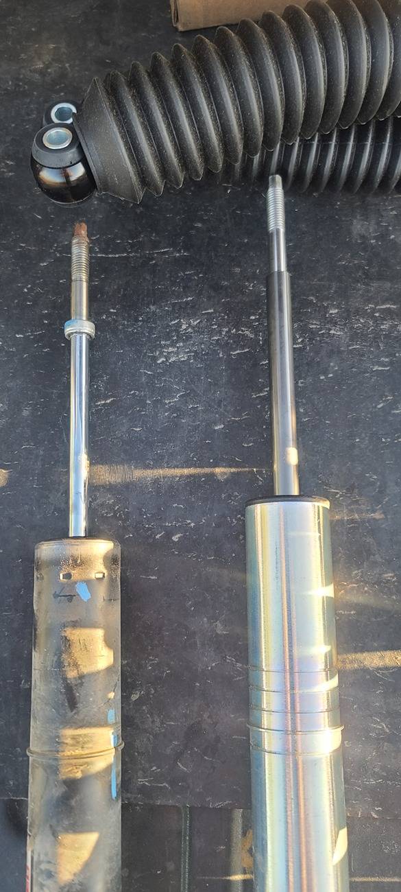

I found a Eibach Stage One new in the box on Offerup to replace the puck lift. Also installed BDS Shackles and replace the UCA. I set the lift to max that added about 1". The BDS Shackles leveled the ride and reduced the drive shaft angle. the UCAs allowed the alignment shop to zero the caster and camber.
88,000 miles.
UACs
Struts side by side
