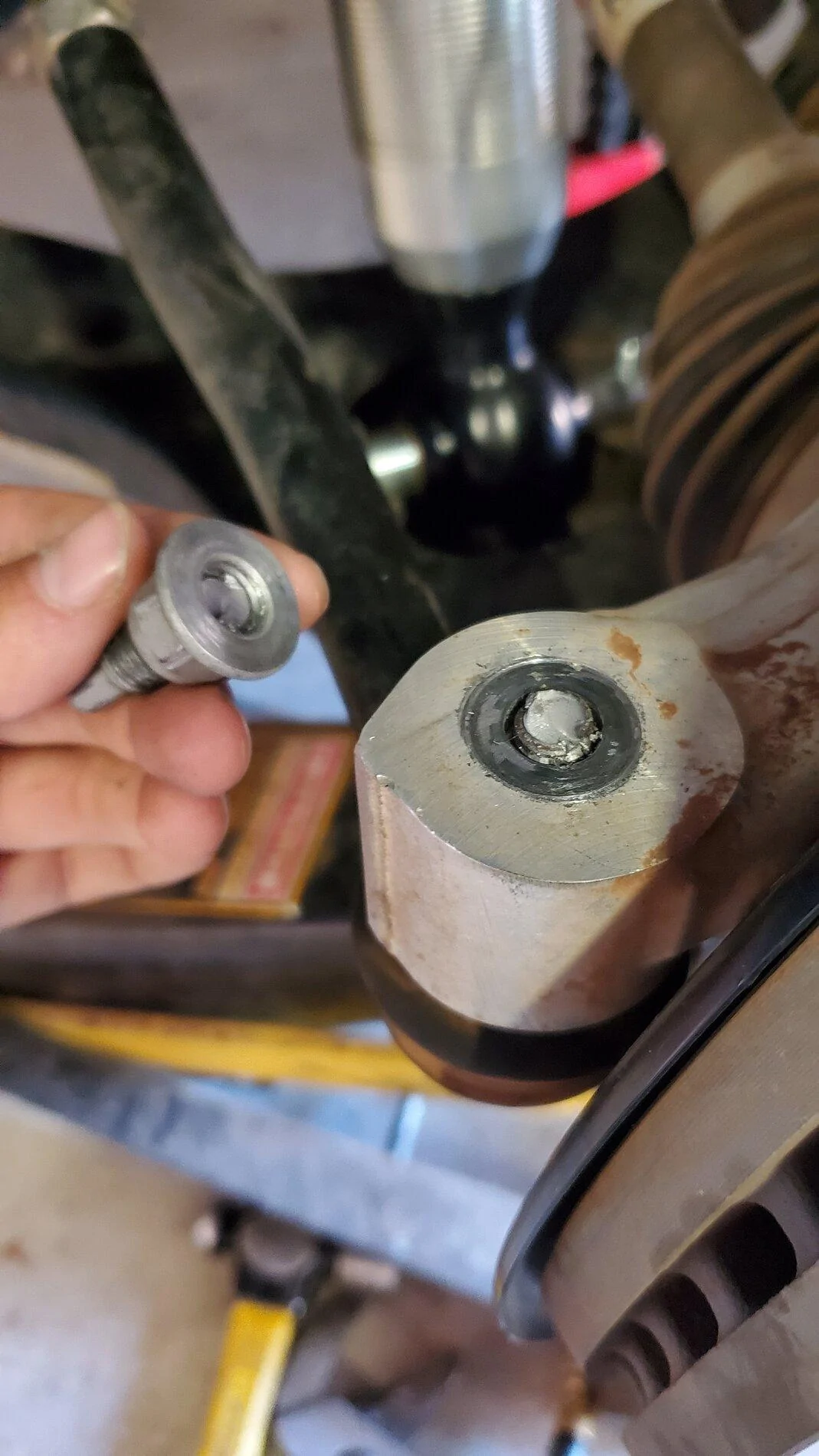

Guess this is more steering related than suspension related, but I was putting new struts on my truck while it happened so I figured I'd post it here. Was working on torqueing each bolt to specs. On the driver's side, the bolt that connects the steering tie rod end to the steering knuckle pulled in half (before reaching the spec). Thought it was odd, has anyone else had something similar happen?
Luckily its fairly easy to replace, so no big deal. Just a bit concerned with how easily it failed

Hi Emma,
This is a classic cap and cone tensile failure . Has your torque wrench been checked to calibration. If in spec, I would suspect it was over torques prior to your retorquing. Unusual failure. Now the interesting part. Being a taper fit, once seated a taper joint is usually robust enough that the nut is not even needed. Weird failure...

Hard to tell from the photo, but it looks like it started as an existing defect. Note the dark area between 3 and 4 o'clock. It appears that the defect rapidly cracked about half way across, then tore the rest of the way.
I'd guess that the stud either had a manufacturing defect, or was a bit over torqued initially and cracked a little. The dark spot indicates it's been there a while. And, threads are stress risers.
I always find it interesting when studs break off up in the nut. My understanding is this is where the greatest stress is, but it makes better sense to me that the stud should break off flush with the nut.
I don't think I've ever seen one break like that, though. I have seen the other end of the tie rod break, but when the wheel has taken a hard hit, like in a wreck.

What were you trying to torque it to?
Thanks for the replies! Upon further inspection I noticed that I read the spec for an adjacent bolt, which was way over the spec for that one.... Aagh. So this ones on me.
Still an interesting failure, I have always been fascinated with tensile failure. Hopefully this will remind me to stop working when I'm too tired to read right, lol.
