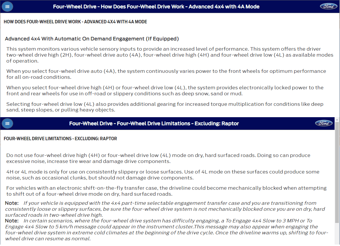

We must not be reading the same text, nowhere in that did I see where they said you can use 4H or 4L on hard sealed surfaces, they do mention that you can use 4A (4x4 Auto) on hard sealed surfaces. It still sounds just like I stated, an auto engagement of a parttime 4H drive system.
From the Australian Ranger Owner's Manual: (Not sure about the Raptor exclusion as they don't have the manual for that new one online yet)
Obviously we're not - but I think the article got it wrong - not unlikely, most motoring journalists these days scarcely deserve the title! He's compared it to the Mitsubishi Triton system which can be left in 4x4 on the tar - which is obviously incorrect. This system does sound like it can be used like the AWD systems in SUV's or left in 2WD or locked in 4x4 Hi or Lo range.
The full-time 4x4 system is standard on all V6 4x4 Rangers, including the petrol-fuelled V6 Ranger Raptor. The system offers drivers the choice of conventional two-wheel drive (rear wheels); 4x4 Auto; locked 4x4 high range; and locked 4x4 low range.
The benefit of 4x4 Auto is that it can be used on all roads including hard sealed surfaces where you couldn’t normally use 4x4 in a part-time system. This is specifically beneficial on roads that change from sealed to gravel, snow and ice covered roads or even wet roads, and is especially beneficial when towing a load and you need to maintain control.
